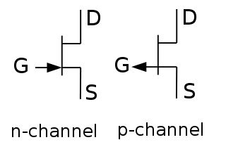

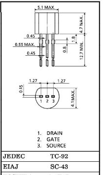

Some other bits to help out...
I have a few test pcbs and jfets incoming so I will be able to comment in a couple of weeks.
