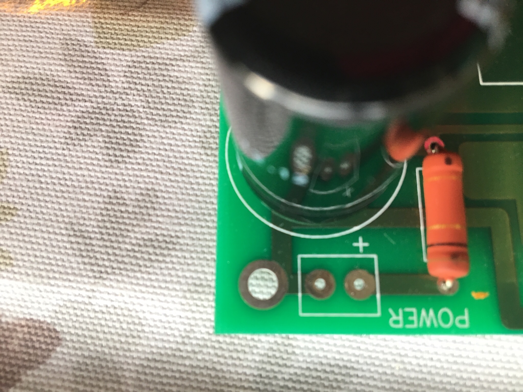

The current PassDIY board has the ground plane connected to the standoffs lug. If you use metal standoffs (which I see everyone using in their photos), the chassis is automatically connected to the ground plane of the PCB. With that scenario, I am assuming that I will need to connect the ground plane of the PCB to the Mains Earth.
How do I implement a 'ground lift' in this case? Is it unnecessary to do so?
Thanks :)
Sent from my iPad using Tapatalk
You must use a PE wire connected direct to Chassis/Enclosure.
If you have any exposed conductive parts, then you should have these connected to the PE protected Chassis.
If you don't want to connect the PCB traces to the chassis, then use insulated standoffs.
Then consider what parts that are exposed, that will need the extra connection to Chassis.
