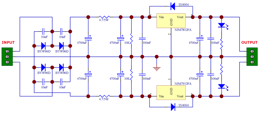

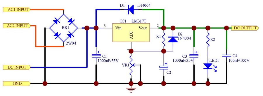

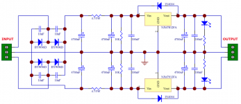

Hi all, better late than never I have discovered the B1, and am gearing up to build one
I am a bit confused on the power supply (PS) though, even as I realize almost anything will work. After many hours of research, I am not much wiser, so must pose the question here. Please forgive me, if it seems trivial..
As I understand it, a simple regulated 18v+ PS will do fine, where only the positive voltage is filtered.
But would it be better (theoretically at least) to use a symmetrical PS that gives regulated and filtered +/-18v?
I have attached schematics of both types of regulated boards. Which is best suited for the B1? (assuming matching transformer).
Your help would be much appreciated!

As designed, the B1 needs a single ended supply. A bipolar supply will not work. If you search for the DCB1, I believe you will find a variation that can use a bipolar supply.
My advice, stick with the B1 as Nelson designed it. It is a GREAT preamp!
