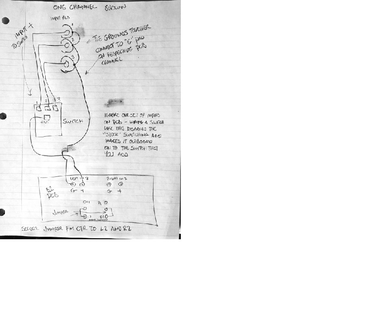

I think I have a problem with the selector .... can't get any continuity with the DMM
You are measuring it incorrectly. Grayhill switches are Mil-spec, the likelihood of you having a bad switch is about the same as finding an honest politician... :) :) :)
If I recall, Grayhill switches have many contacts (solder lugs) on the same plane, these are the "input" connections.
You have a 2-pole switch, so there will be 2 lugs (likely opposite of each other) that are on a different plane, probably closer to the shaft. Those lugs are the output connections. (common) Set the DMM to continuity beep. Put one lead of your meter on one of the output lugs and now touch each of the input lugs until you get a beep. That will show that in and out for that particular switch position, on that half of the switch. Move the switch and repeat. After messing with that for a bit you will see which lugs on the input connect with the output lugs.

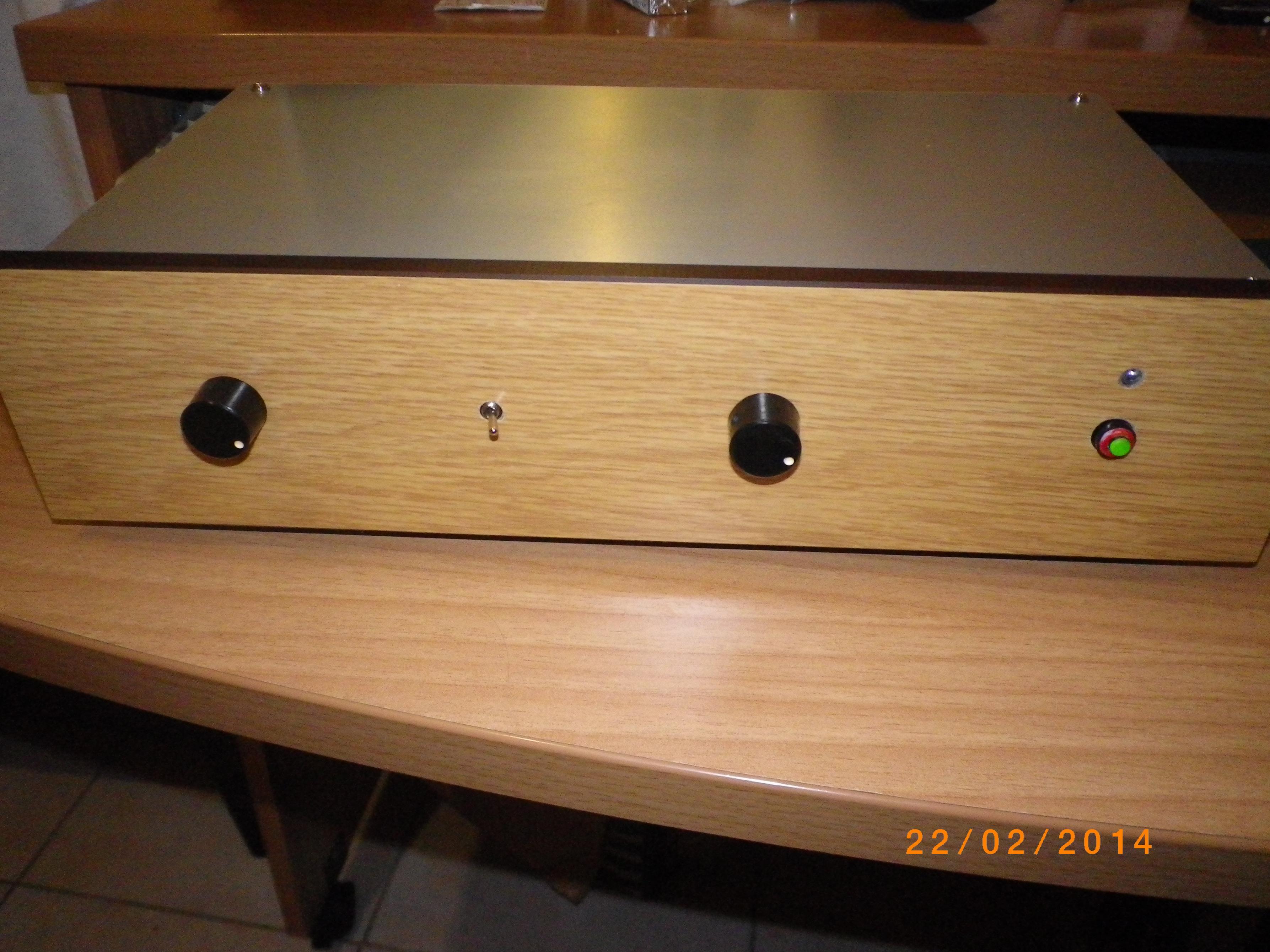

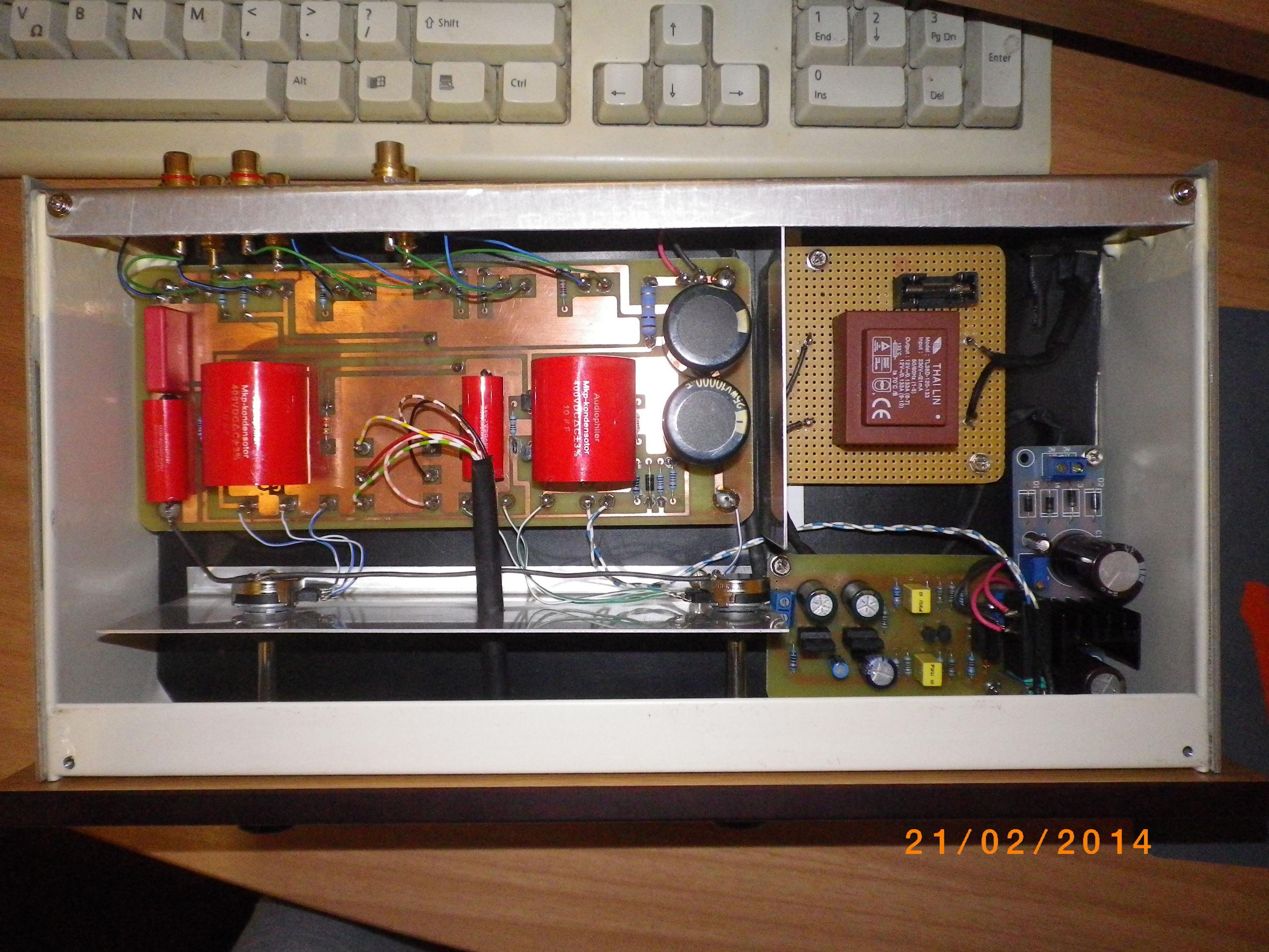

B1 BUFFER
Hi
this is my B1 Buffer .
Pcb its from gerber fille .
2sk 170 matched to 7.8 ma at 640 mv vgs
10mf-1mf Audiophiller
JLH Shunt Reg at 22V
LM 317 at 22.10 V
Two separate pots 25kΩ
