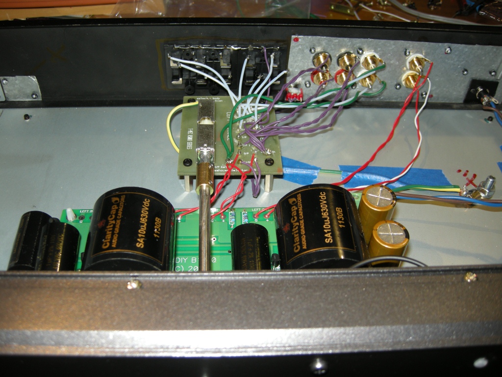

Here is my B1 with LDR volume control and DIY regulated power supply:
I am very happy with the sound.Thanks Mr. Pass for sharing great designs to DIY community.I have one problem with this setup Bass is sounding very thin with LDR volume control.Can anybody comment on this?Can buypassing LDR or replacing it with 47k stereo Pot will solve this issue?

Hi there - with thin bass

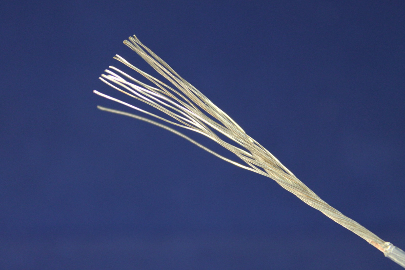

On my B1 - which have very firm bass and good sound - I used a variant of this - that I found on the ebay. There are many versions and prices if you look closely! I think your cat5 single wire is much too thin in this amplifier.
Valab 16 AWG (19 x 0.32mm) Teflon Silver Plated Copper Wire

What is the difference in resistance of a Cat5 pair to your Valab pair at 1m and 10m interconnect lengths?
What proportion of the total circuit resistance is made up by the cable resistance change?
Do the differences in impedance of the cables account for some of the sound difference?

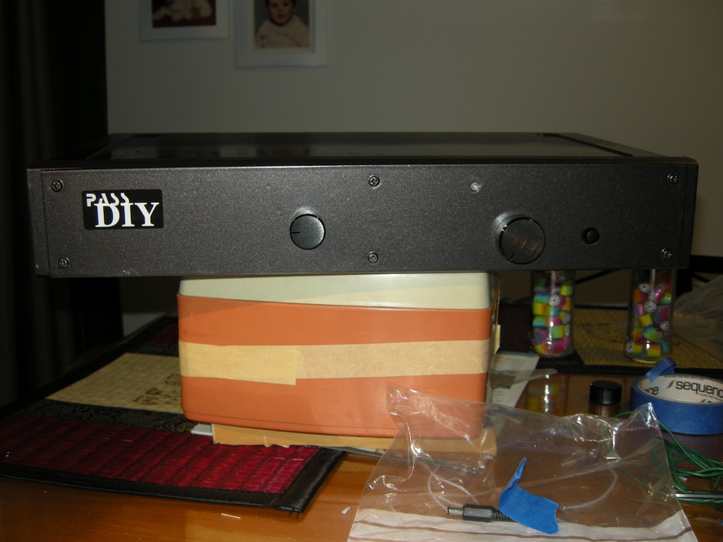

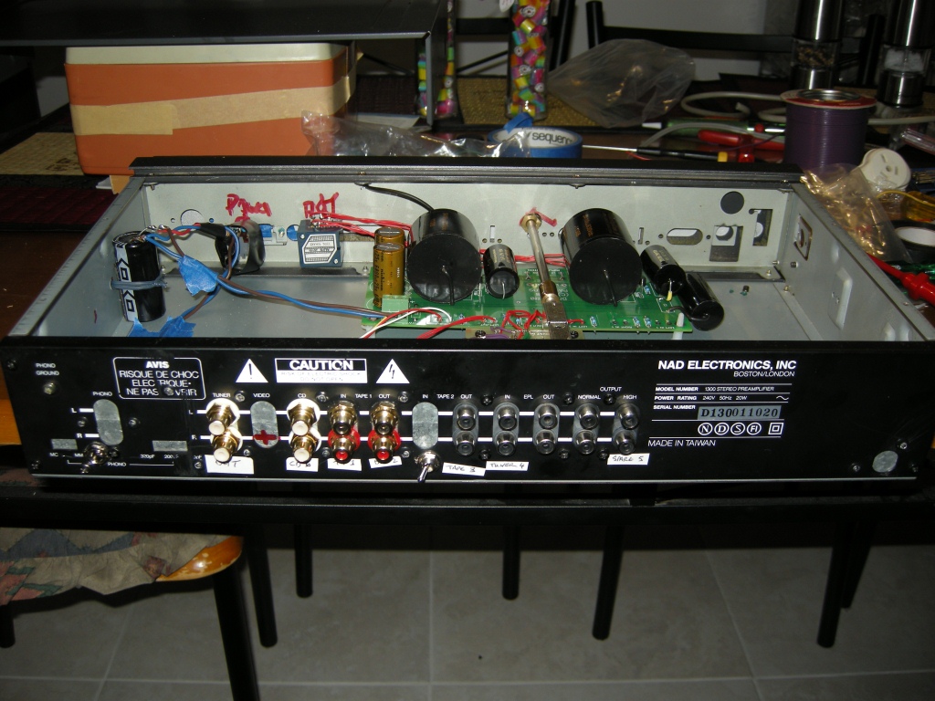

B1 finished and working well
I just finished a B1 build using the PCB and JFETs from PassDIY and capacitors, Alps Pot and a 6 input rotary switch kit from HiFi Collective.
The case is my old NAD 1300 preamp (1990's vintage) which recently died - hence this project.
I also run the Oatley K303 RIAA amp in a separate box which is fine for my old turntable, a late 60's vintage Dual.
I'm powering the B1 off an old laptop computer PS. It seems to be OK.
I like this preamp. It works really well, sounds great. I need a new CD player now.
