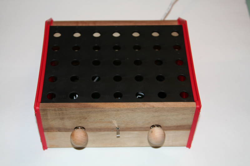

Hi to one and all, with special thanks to Mr. Pass:

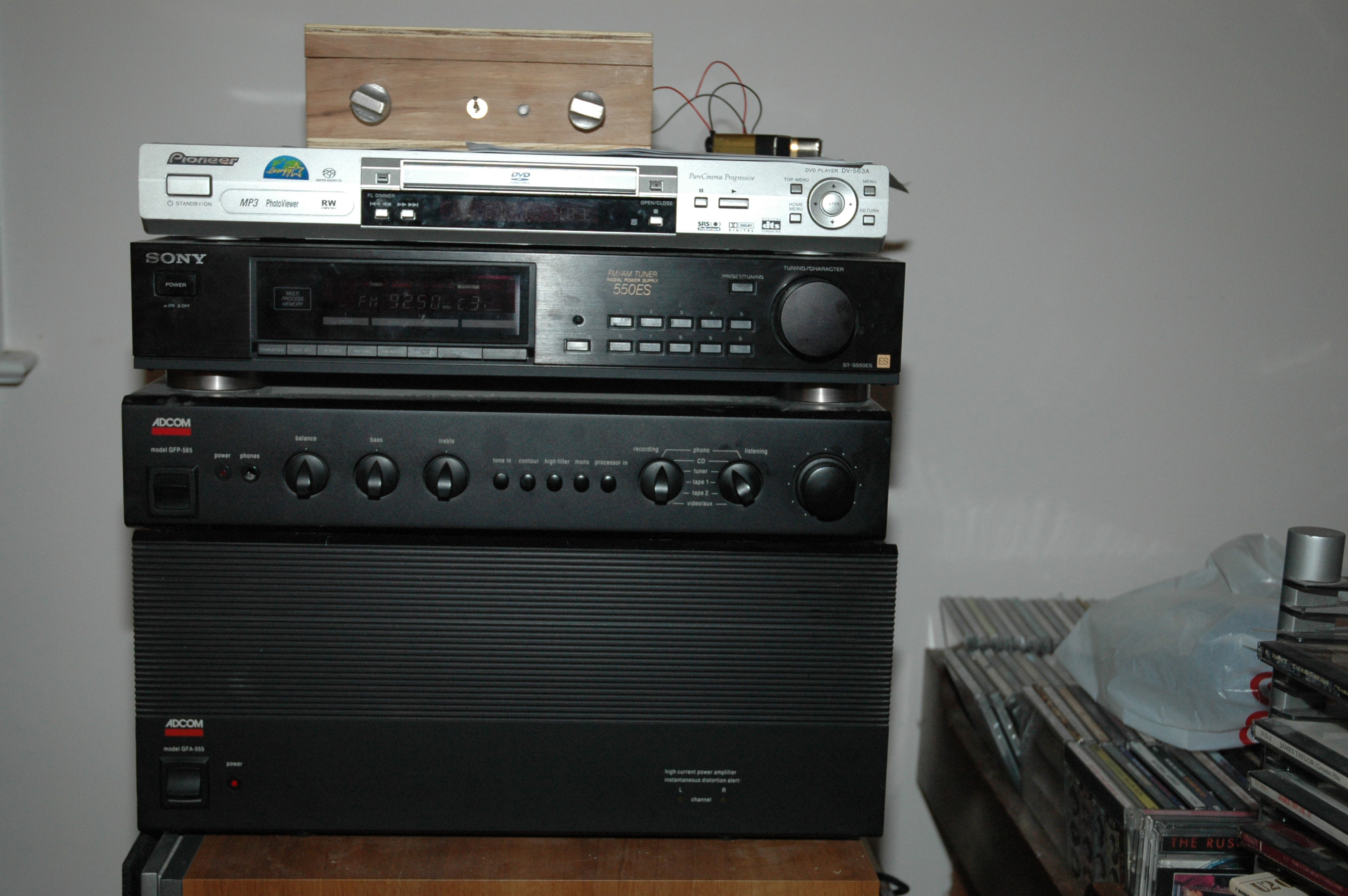

A couple of photos of my B1. Finished it last Thus./Friday and have been listening pretty much constantly since.
Note the "fabricated from billet magnesium knobs" :D and the hickory case made from a tree that fell in my father-in-law's woods 25 years ago. :rolleyes:
Am hearing things I've never heard before, and some things that used to be prominent are farther back in the mix than before. Bass is clearer, not as resonant. High end is much softer and more like I remember records sounding like.
Note that I am powering a GFA 555 amp that I bought in 1986...:D It sounds a lot more linear at both lower and higher volumes--less "confused." Would have never been able to afford a new preamp, so this was really a great treat to get such an improvement for little or no money! Thanks for your generosity Mr. Pass, I have really enjoyed my Adcom gear that you designed, and now I can afford some of your other stuff (if I build it myself!)

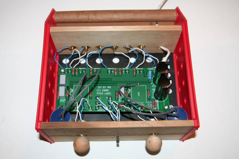

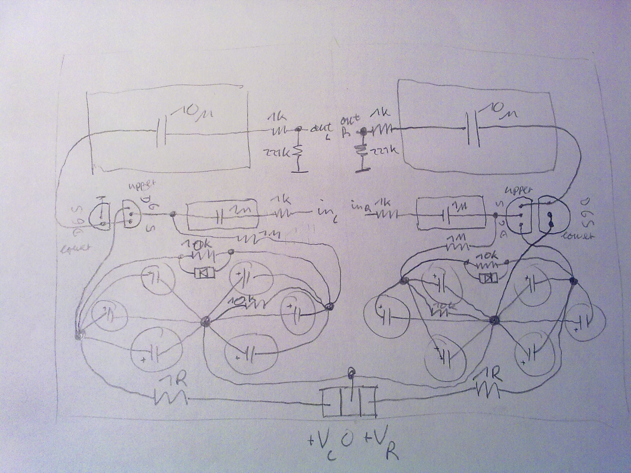

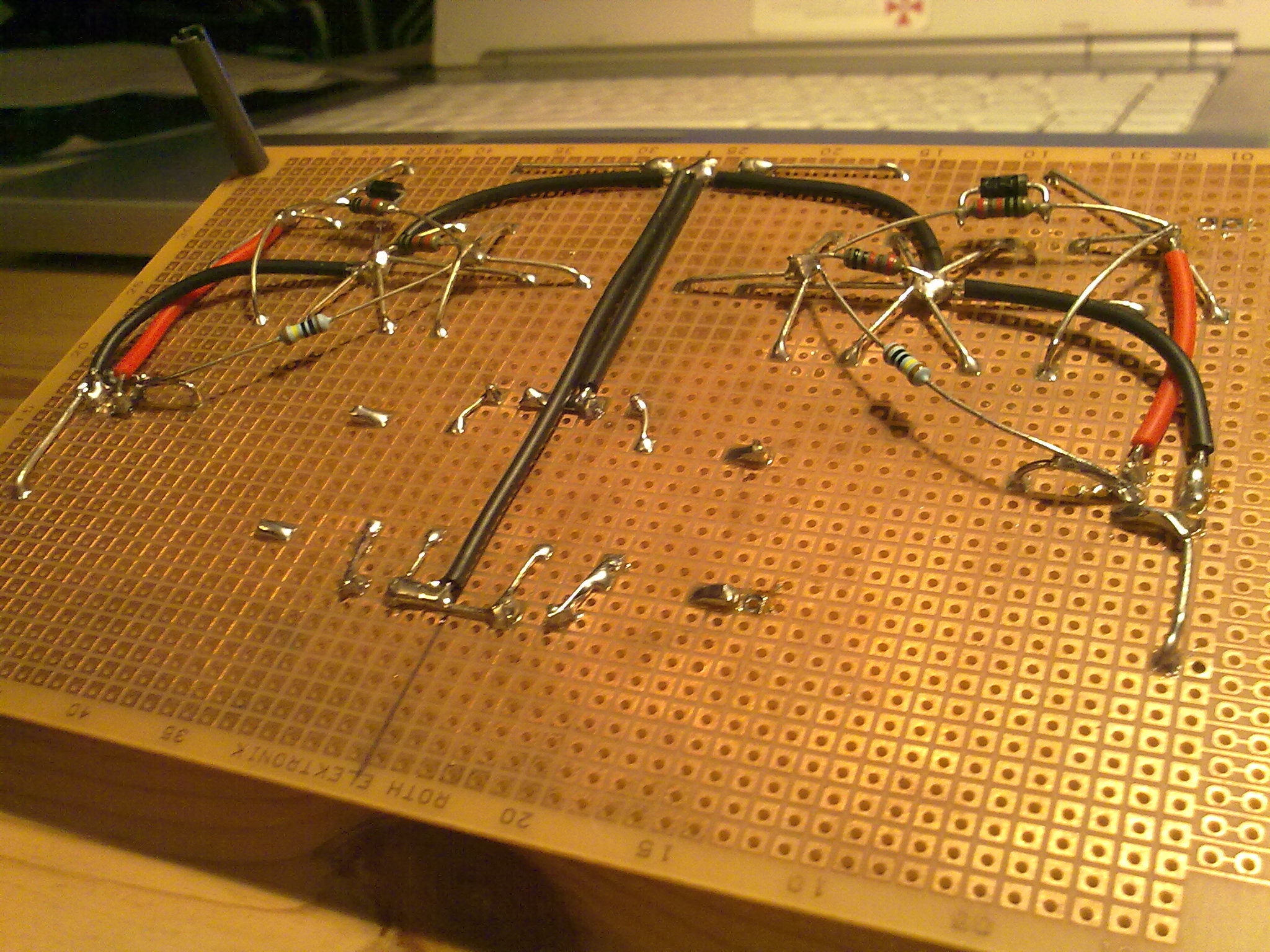

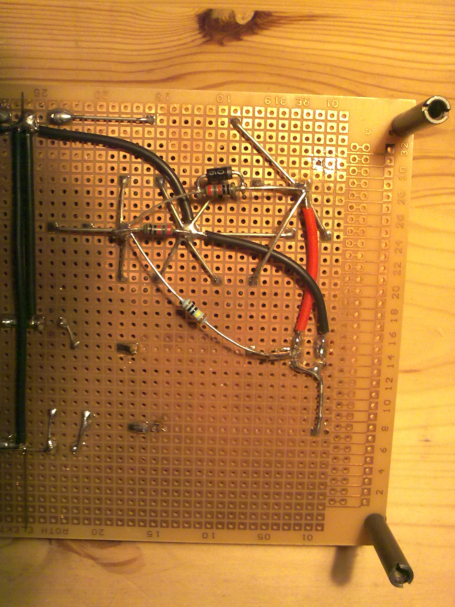

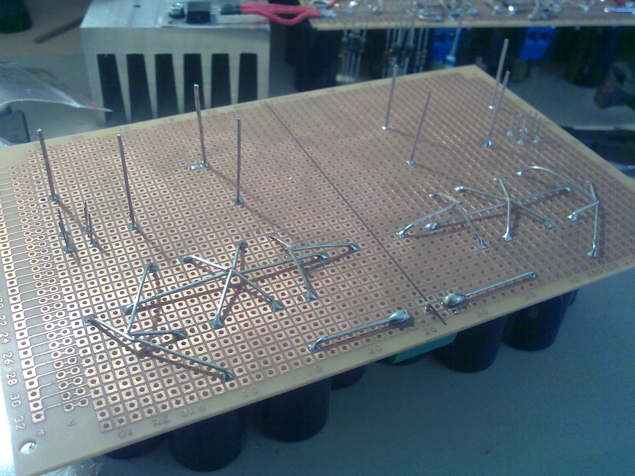

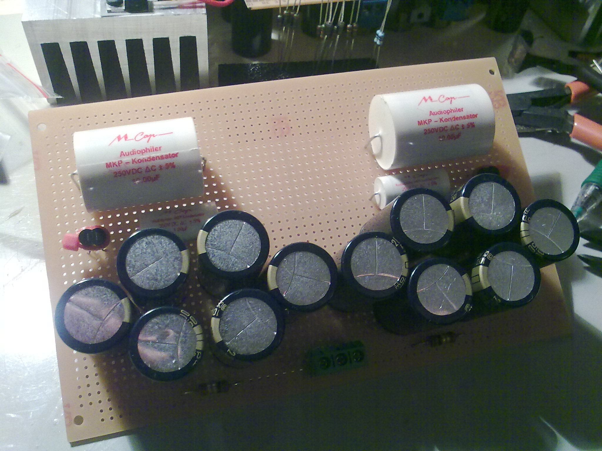

Here's my take on the B1. It will be the input-buffer of an integrated amp I'm building for a friend of mine. I somehow like to p2p and make connections with the components' leads. Half the solder joints.
Today I'll add the resistors. Cute amp.
Edit: In the hand-drawn schematic half the caps (Panasonic FC 2200uF50V) have wrong polarity, yes. I was used to draw bipolar supplies, so...
But they were installed correctly as you can see in the pic.

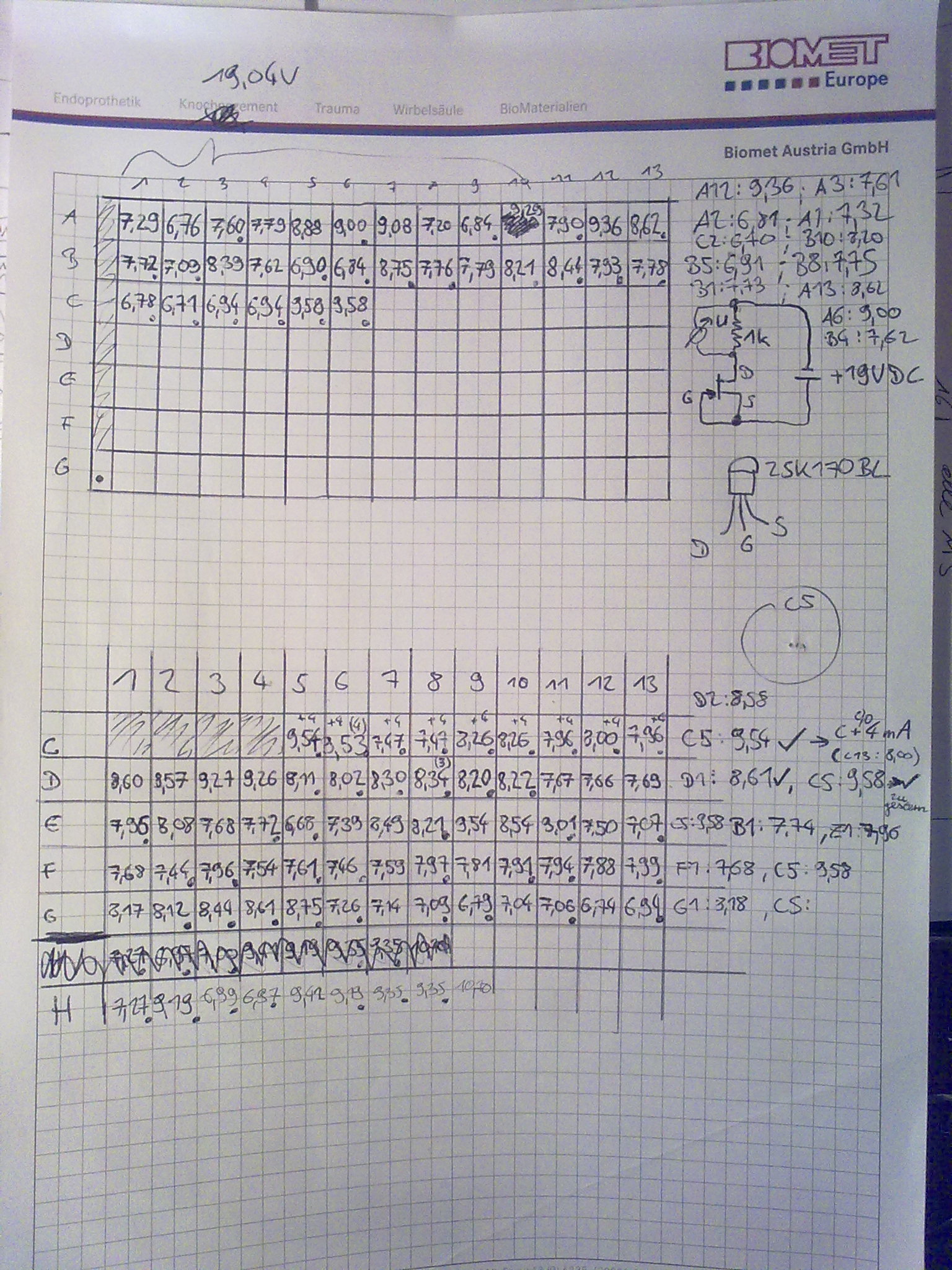

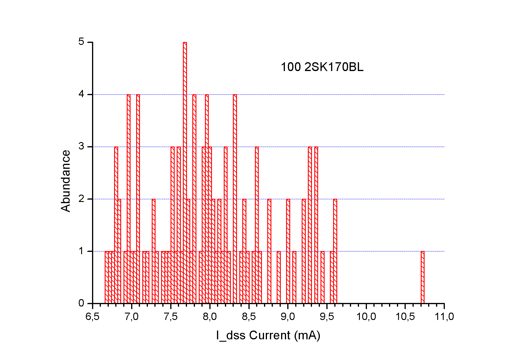

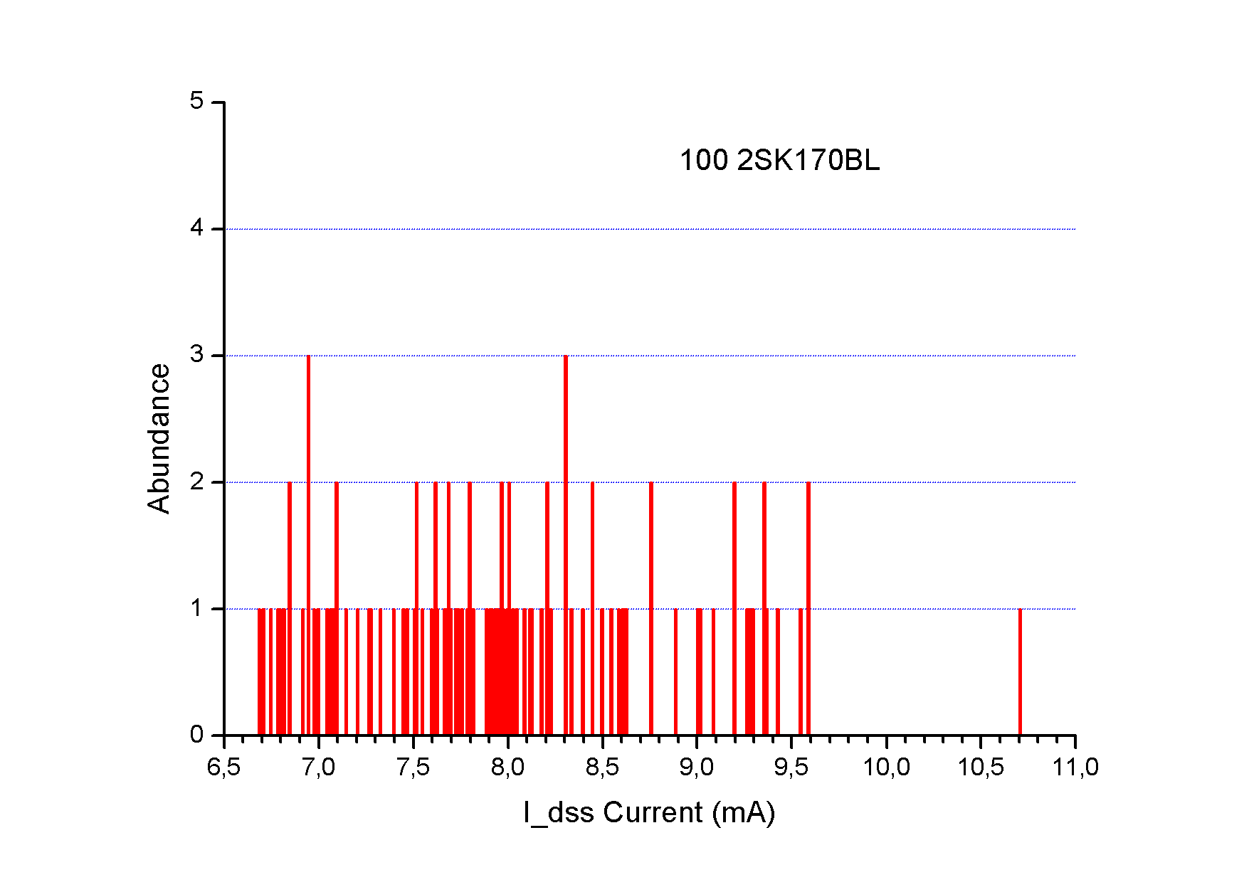

And here's the data from matching the 100 2SK170BL.
First histo shows I_dss abundance with bins 0.04mA wide.
Second shows same with bins 0.01mA wide.
Third pic shows data.
The JFETS used have (7.68,7.68,7.67,7.66)mA I_dss.
Edit: I ended up with 26 unmatched JFETs, the others are matched within 0.01mA up to 0.04mA, so 37 pairs in total.

I thought i would post some pictures of my B1 Case, ( for now ) Till i can afford the one i really want.
This case was built for me 4 years ago, it lived in a padded box, the metal came from a old recycled sign that is why it still has the reflective material on it, i will remove it off soon :)
I have ordered my self a nice hand full of gold Rca connectors 18 flip switches the nice 10uf caps, ( cheap ones for now till i can afford a set that are 60$ ) a nice 25K noble pot from ebay and i have a nice 18V regulated laptop psu ill use for now till i build one.
Noble pot was 19$ on ebay for a 25k one, there is one left from the seller.
