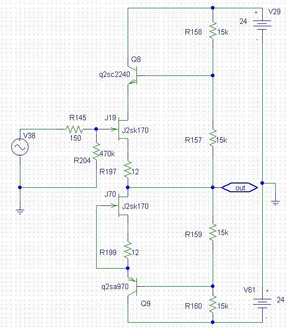

I do not know Nelsons set-up other than that it is SE without source resistors but here is what I am using. I have tried a number of different variations on the theme but yhis is the one i like best so far. I need alot of swing and this one delivers.

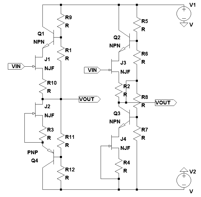

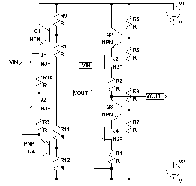

i understand why cascoding is done. i'm asking why it was done a certain way.
just in case my question wasn't clear ...
refer to the two buffer schematics in the attached schematic.
why cascode the current sink (j2) with a pnp (q4) instead of cascoding the current sink (j4) with npn (q3).

Hi Michael,
I think the second method might be better (cascoding the current source).
Maybe Mr.Pass could shed some light on this............but then again, in the case of the B1, cascoding might not be an improvement besides you can run into stability issues when you cascode.

oops, sorry, in the schematic i posted, i forgot the "bootstrap" connection that bappe was using (the vds of the jfets is not fixed)
please remember there is a connection between the output and junction of r1 and r11 for the left hand circuit and a connection between the output and the junction of r6 and r8 for the right hand circuit.
i'll fix the schematic when i get to my other computer.
of course, we could always argue about the virtues of fixed versus telescopic cascodes ...

corrected schematic attached
