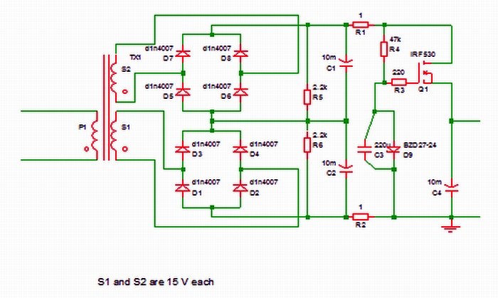

I think your zener will have to be reversed...

Ohh yes ! of course
On the wall wart is ok to make the rectifier bridge and a first bank of capacitors . I use 20000 u F . Then inside of the B1 box I used another bank of capacitors plus the voltage regulator .
Ohh yes ! of course

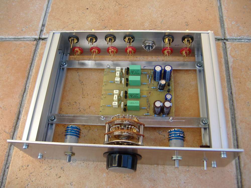

Hi gents,
this is my version of B1, still without all the wiring. It includes twice the circuitry of a B1 and a shunt regulator for the supply voltage. It is fed by a simple AC wall adapter.
The second channel serves in two ways: Either it buffers the inputs without attenuation or it works as a second independent output with attenuation (switch on the right side). I could not help replacing the two volume pots by stepped attentuators for volume and balance (20K and 100K). The balance control is made in the fashion of vintage preamps made by technics: There is no attenuation by the balance control when it sits in the center position, thus avoiding some of the disadvantages.
I intend to use it togehter with a pair of active powered speakers (Orion/Phoenix alike) where I do not need more gain than just one.
Regards, Jürgen
Regards, Jürgen

pozo1992 said:Hi gents,
Regards, Jürgen
Hi Jürgen,
what caps do you use?
Please report your listen impressions when finished!
P.S. I hope the resolution of the B1 will be better than of your pic
Hi Thomas,
I assume your are pointing to the signal coupling caps: Nothing special about them: Vishay MKT type 1820. I found them to perform fairly well in other applications. Maybe I`ll upgrade them once I have finished my new audio toys.

Please find attached a pic of better resolution.
