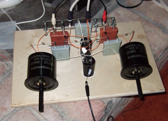

I finished it and its running right now.
Now that I know it works I will get some more inputs for it and a few switches.
My two year old saw the LED light up. "Cooool Daddy!! Cool!"
