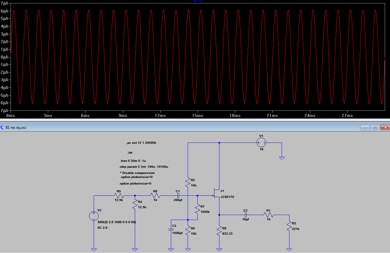

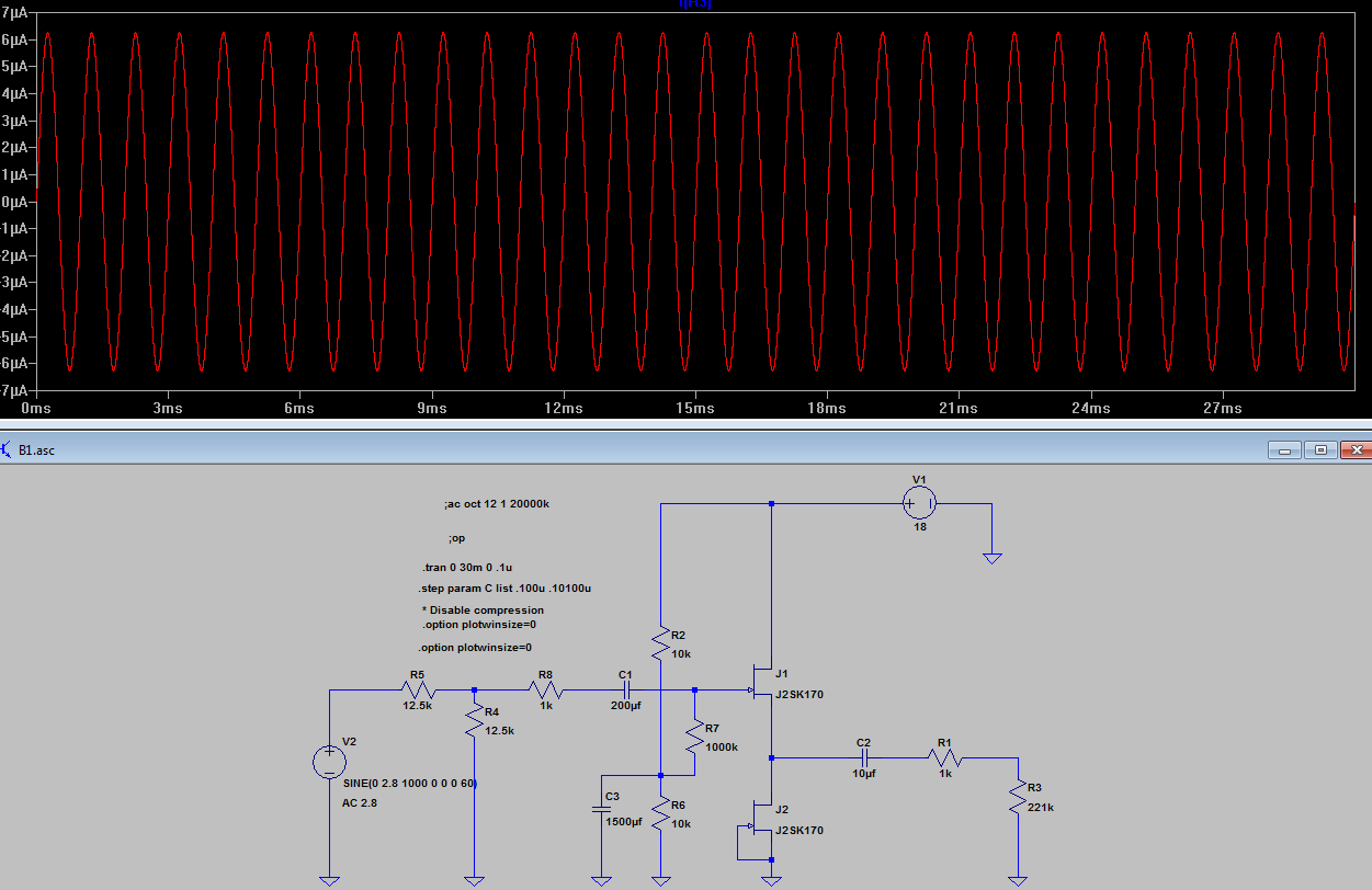

I was using bad models in spice. I found better ones, and now I can simulate the same output for I-R1 or I-R3 using an 833.33 ohm resistor.
So assuming that the output signal of the above two circuits(post 4493) behaves the same with JFET 2, or R9(~830k) installed; would it be correct to say that the both have different output impedances? Do you think it would be safe(won't damage anything) to build both and compare? This is completely a thought experiment for me at this point, so that I can better understand Nelson's choices in this design. Thanks.
imho output impedance is dominated by J1...........
R9 is 833ohms - not 833kohms. you can try out 910 or 820ohms.
the ccs should give better linearity, that means lower distortion.
a distortion sim (fourier analysis) could show this.........

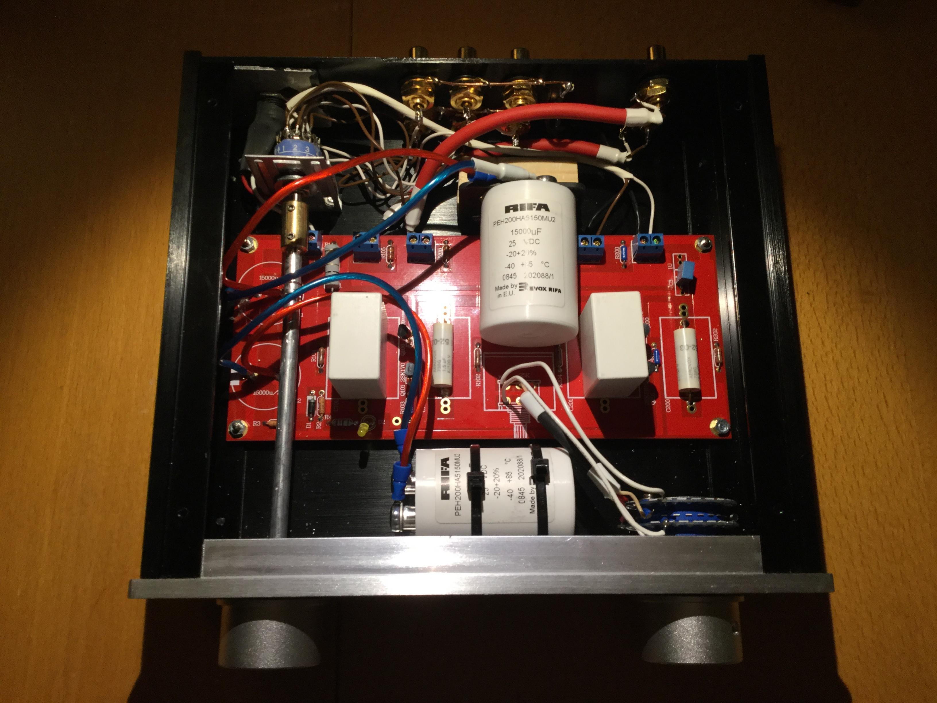

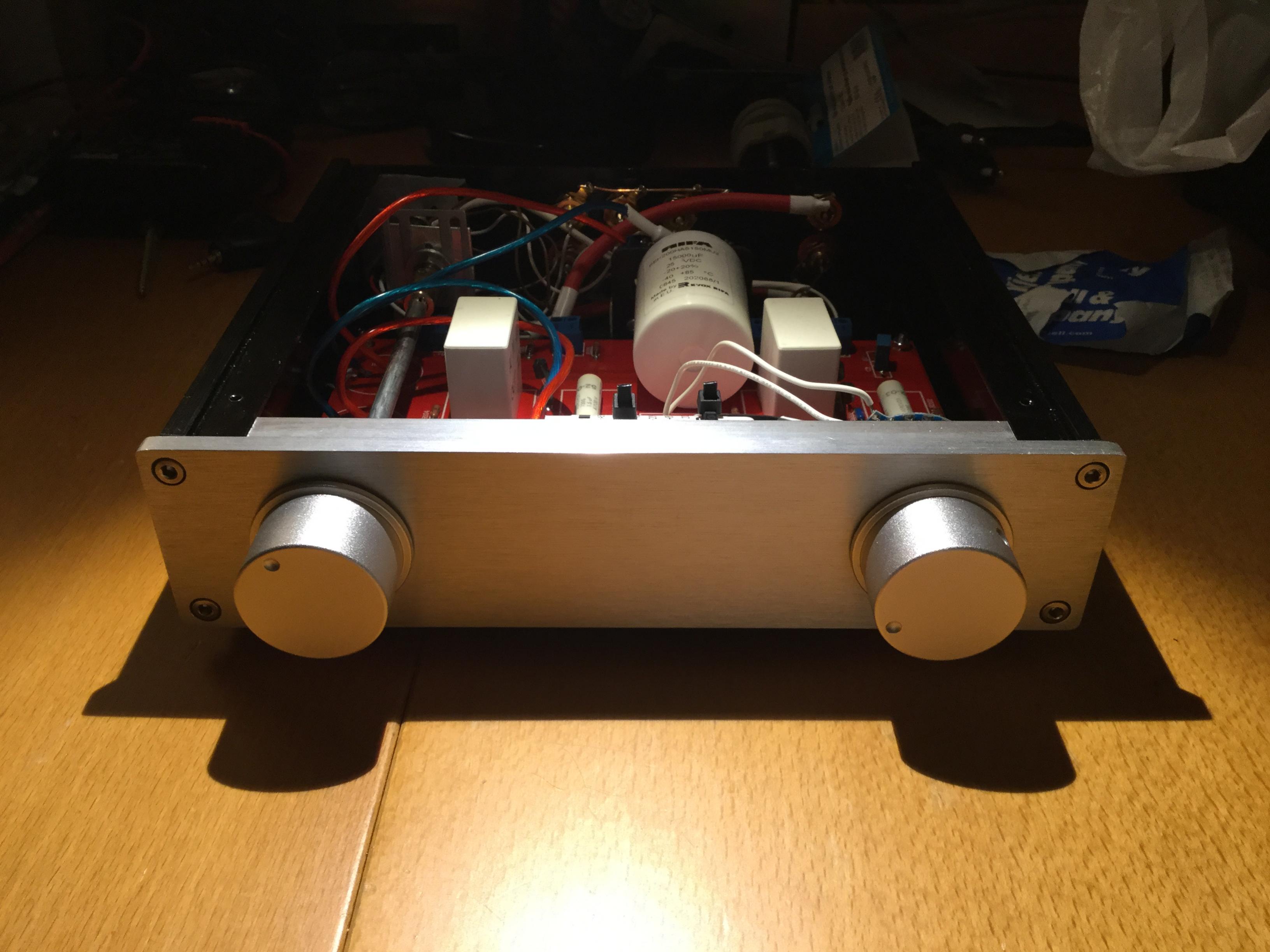

I managed to put my B1 together!
I am now a proud owner of a working B1!
No critical listening just two hours testing that it works hooked up to an old amp and it does!
This is my first build ever, and this thread has been a great help. Thanks to everyone!
It is the kit from Jim`s audio.
For C100/C200 1,5 uF caps were supplied. Normally these are 1uF. Should I change those to 1 uF?

nilsW - Well done on your first build. Those caps will be fine.
