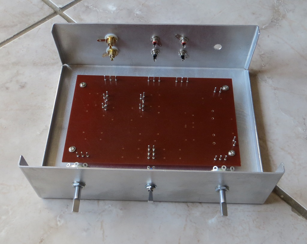

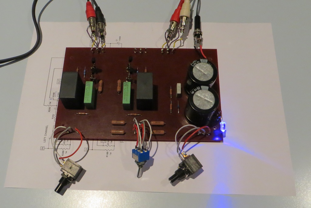

I suppose a few pics are in order to give you guys an idea of how I've done my B1. All caps are Vishay (and one Ero) except for the two big electrolytics.

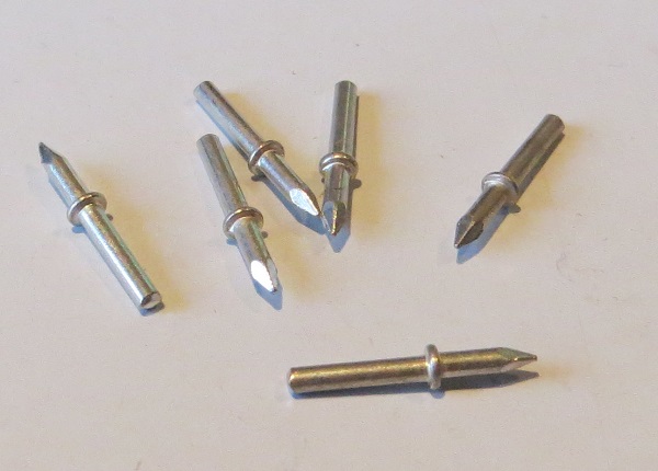

The board is Paxolin and test points were used as solder points. The lid is not done yet.. And I may also add a 4mm alu front panel with etched lettering.
The first picture was taken after final testing and before mounting the board in the enclosure.

I have finished building a B1 and it sounds great. For the board I have used Paxolin with 0.8mm copper wire for point to point connections. It's housed in an aluminium enclosure.
My thanks go to Nelson Pass for the design. I'm grateful for the generous help from the forum members who answered my questions, and I'm also indebted to forum member Twocents who let me listen to his B1 and encouraged me and gave advice when I needed it. It really helps to have a partner in this type of crime. :D

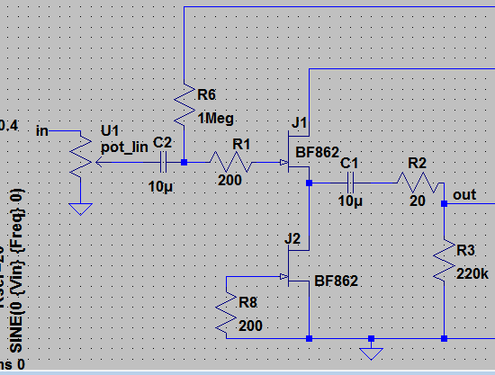

A basic question,came up on working with my BF862 design. What is the role of R102 AND R202 in B1?
https://www.passdiy.com/pdf/B1%20Buffer%20Preamp.pdf
My design here with a better PS.
Super Regulator
POST# 1388
I am using gate resistors with bf862 and put the bias voltage before the gate resistor and skipped the 1K (R102 and R202).On LT spice sim one without 1k in looks better in terms of THD by 10 times more(0.0089% vs 0.011%).
