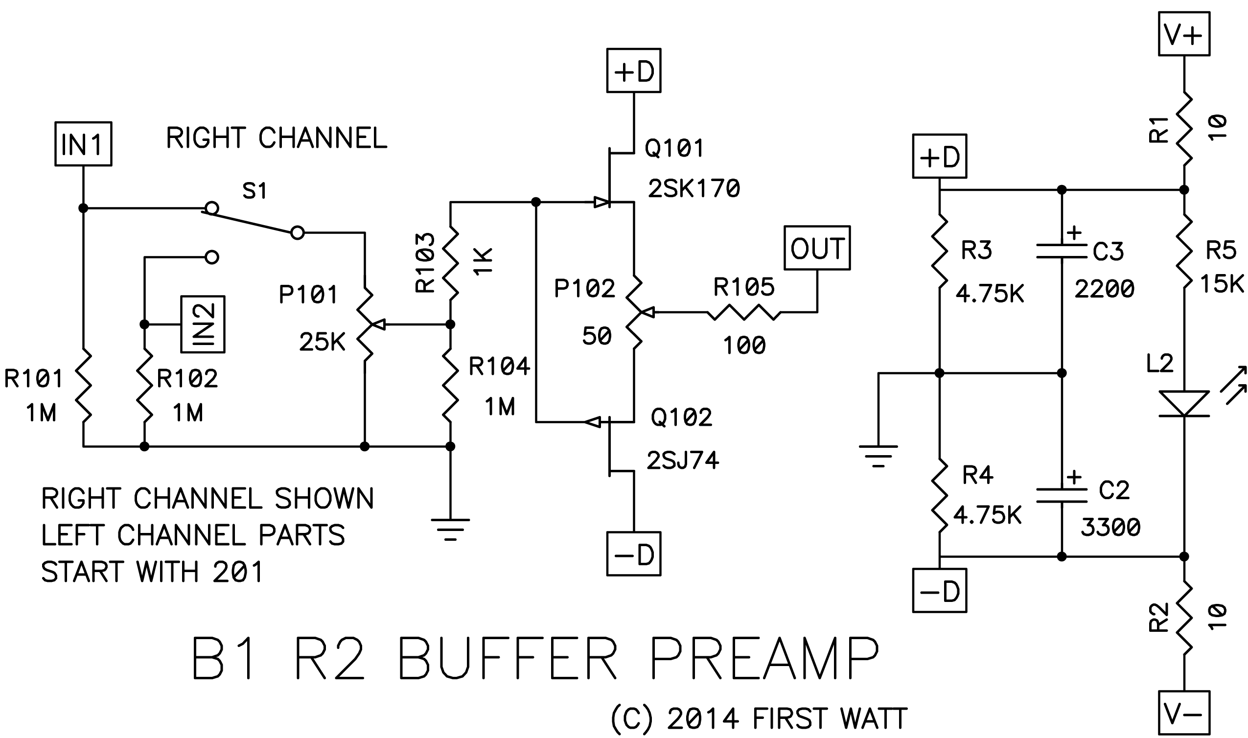

B1 Buffer Preamp

I am inexperienced with electronics, busy with my B1 Build. I have two regulated PSU units, one supplying 15V and the other 24V. The buffer works well with both. I know 15V is below the recommended 18V spec and the 24V is at the high end of the spec. My caps are rated to 35V.
Which PSU will be best to use, 15V or 24V?
I am not sure how, if at all, voltage affects the sound?
the spec for the B1 is 18Vdc. It will work with 15Vdc.
24Vdc is only 4V above the DCB1 PSU, so I'm inclined to say try it.
the maximum output voltage of these single ended Followers is ~ 1/3rd of the supply voltage, i.e. ~6Vac for 18Vdc when the load impedance is high.
But as a single ended follower approaches that maximum the distortion increases a lot. And gets worse as the load impedance drops.
The easy rule of thumb is:
Limit the maximum signal through the follower to <50% of the just starting to clip threshold into the load impedance normally used.
That effectively sets the B1 normal maximum output voltage to ~2.5Vac to 3Vac
Most digital sources have a maximum output <2.5Vac.
i.e. there is no effect on the sound when transients exceeding the average -20dB level need to be processed.
I think this is why many here approve the B1 and DCB1 as a universal Buffer.
