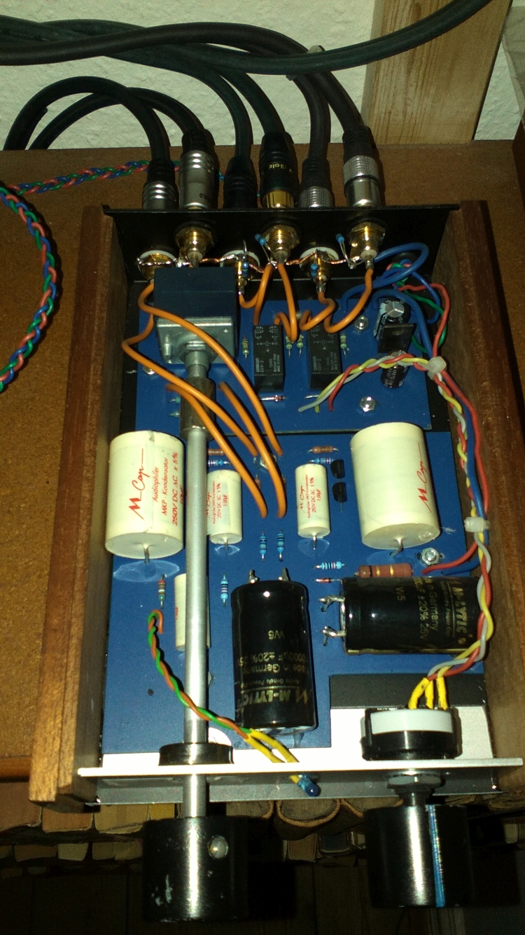

As far as the 10uf I already had purchased these a few months ago and installed them:
Got all the parts ordered from Digikey today. Really looking forward to getting this thing going. I am assuming the 24V DC switching wall wart power supply in the Digikey BOM will be just fine as Nelson Pass says the circuit it really good at ignoring the noise of it. Using 10,000 uf caps for C1 and C2, so I hope this is okay. I can always make a 24V linear power supply with some nice caps in it at a later date for this, if needed.
Here is my build so far guys. I'll be adding two more pairs of input rca's as the grayhill rotary switch up front is 4 position. The chipboard will be going and replaced with standoffs and there will be a metal backplate for the power covering the hole.
As you can see I have two outputs. I simply split it off the normal pcb connection points.
AndrewT suggested I added a 1K ohm resistor for each additional output. I think I am almost clear what to do, but want to make sure I will be doing it right.
Does this look right for adding another output?
This is my version of the B1. The pcb's are homemade with Eagle, a laser printer and some paint.
Cheers...
Wow! Could you please share Eagle files?
Of course...
Looks fine.
That's helpful for me.....now what if I want 3 or 4 outputs? (Active horn builds getting crazy )
How close do the jfets need to be matched...
Use the 10ma part as the curent sink.
