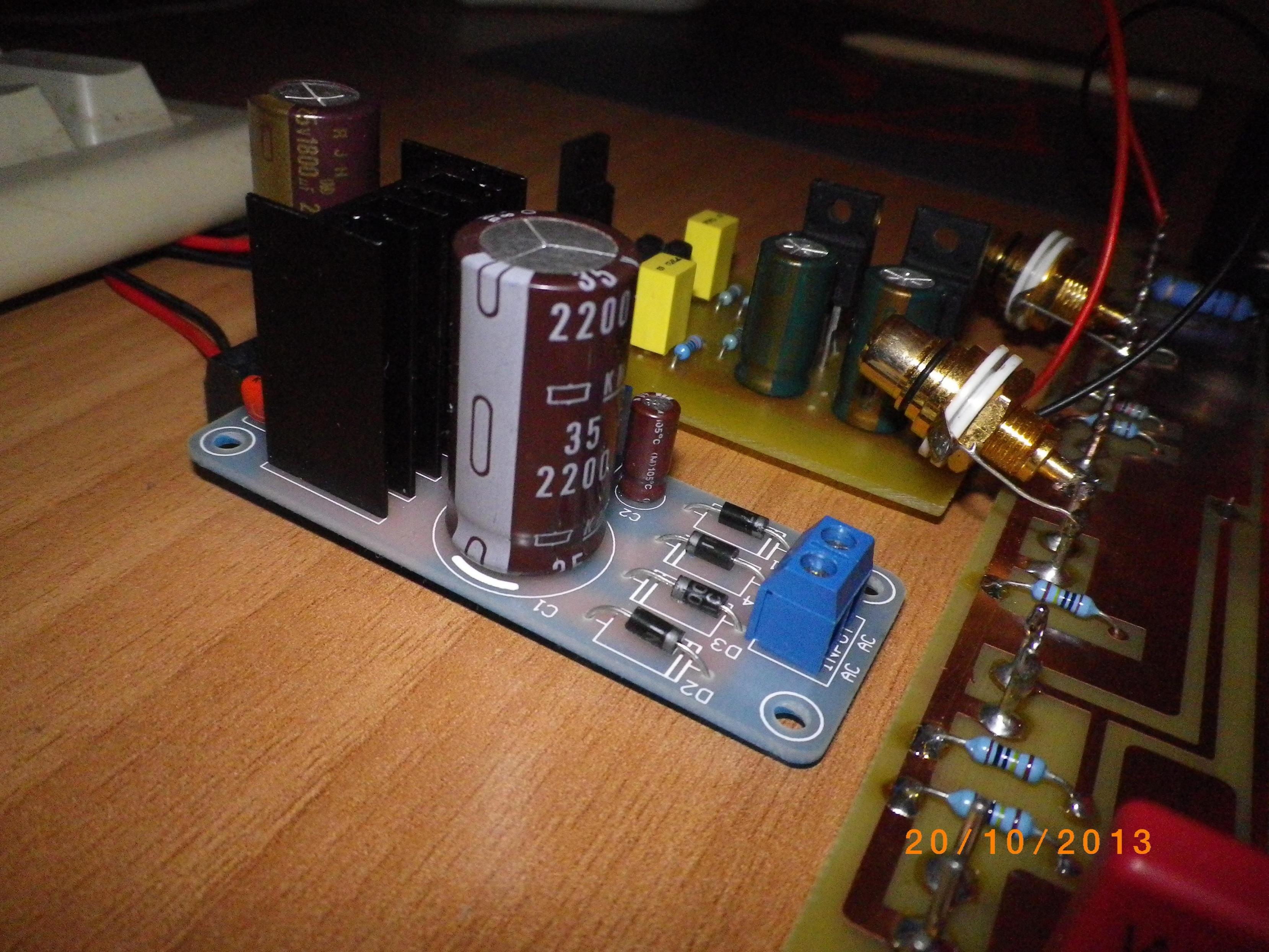

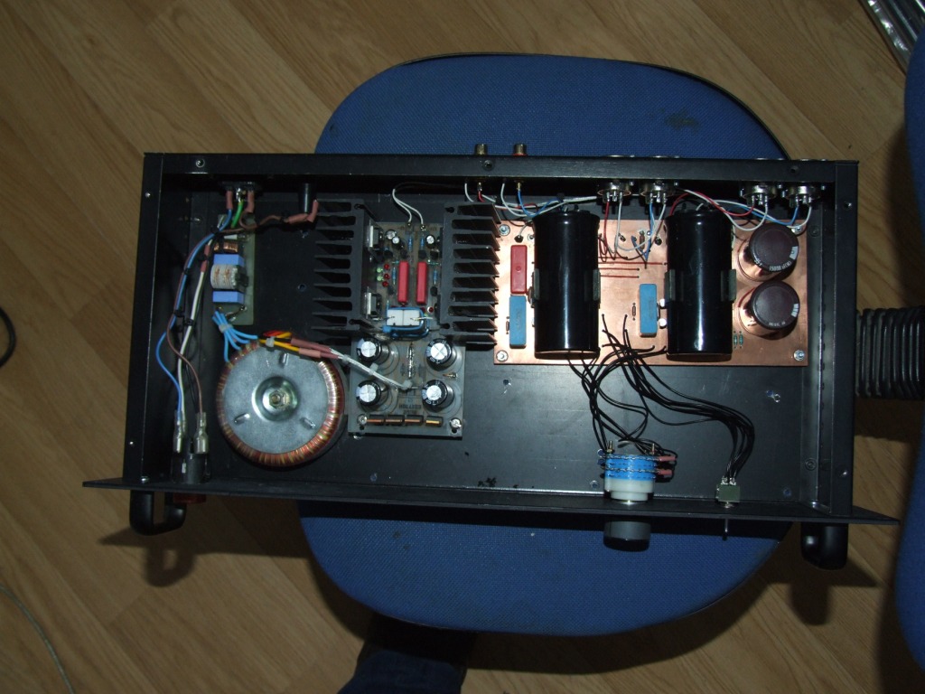

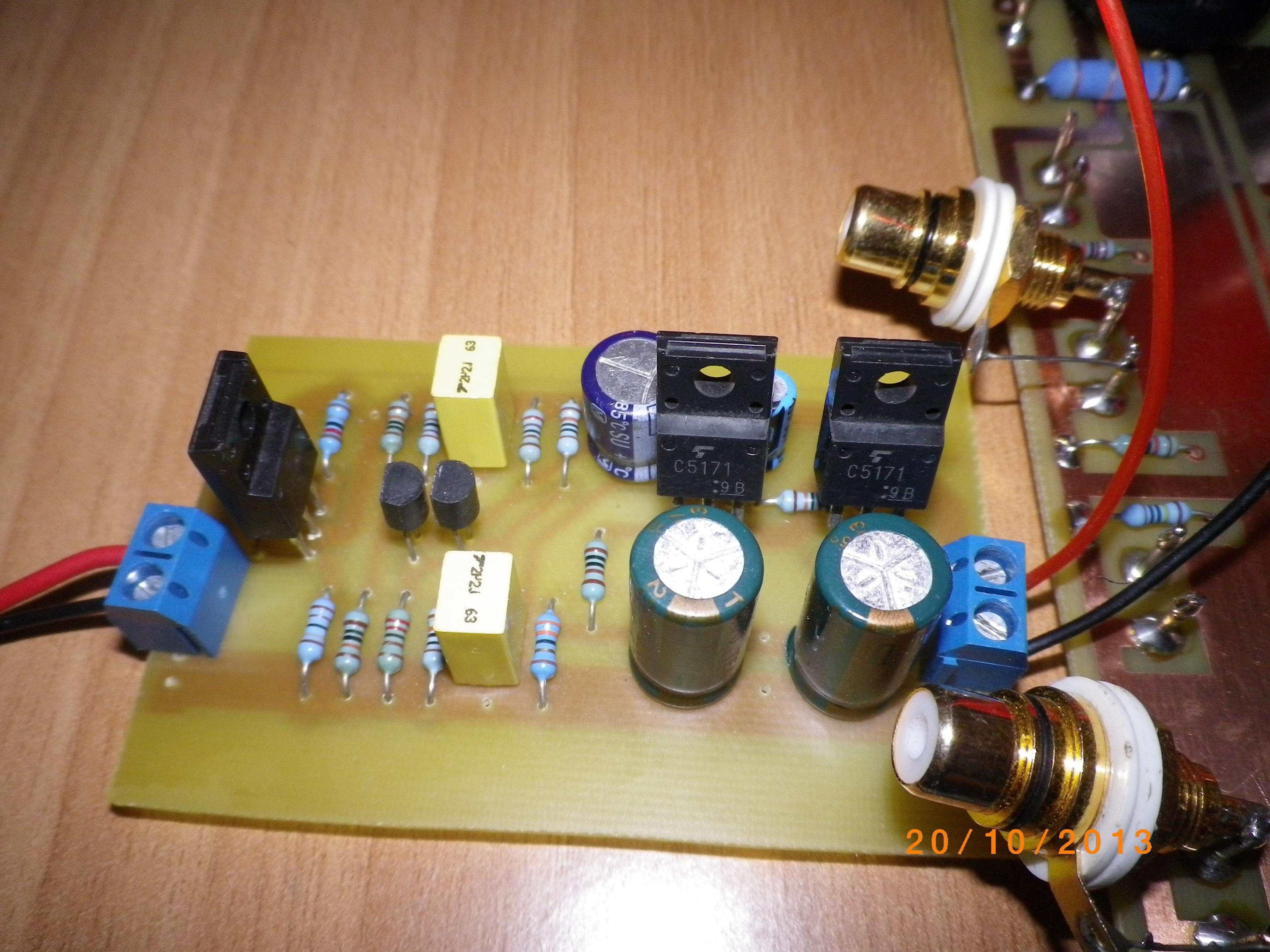

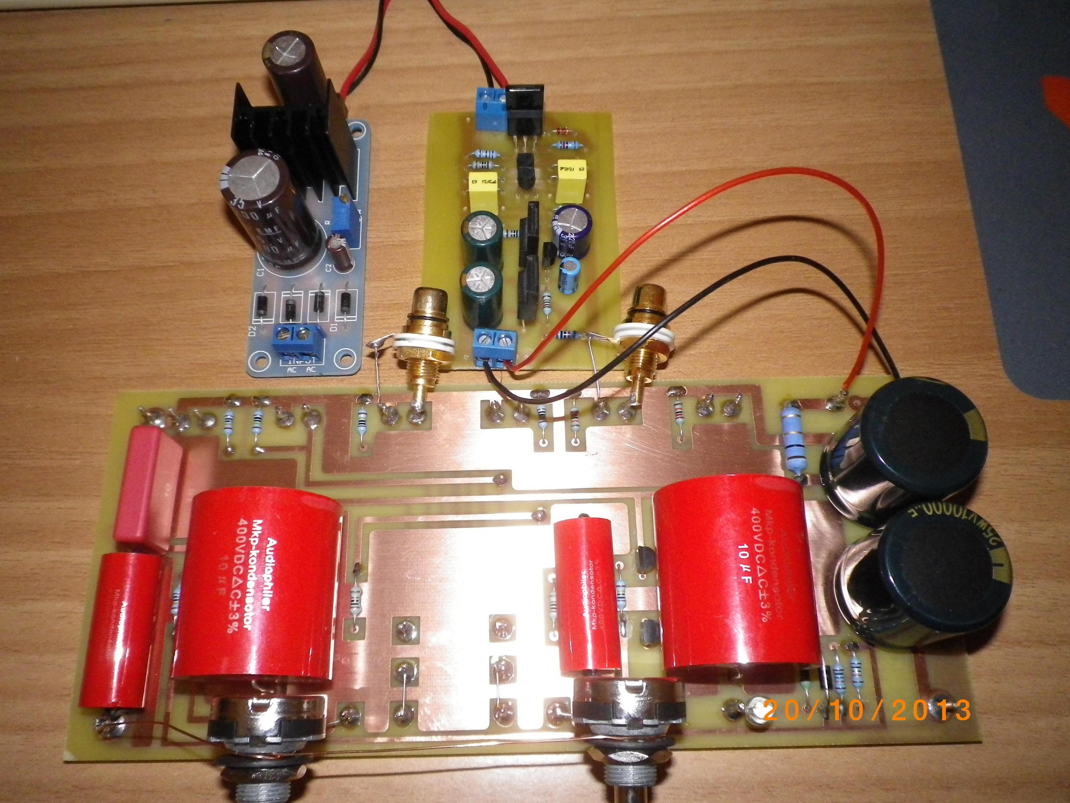

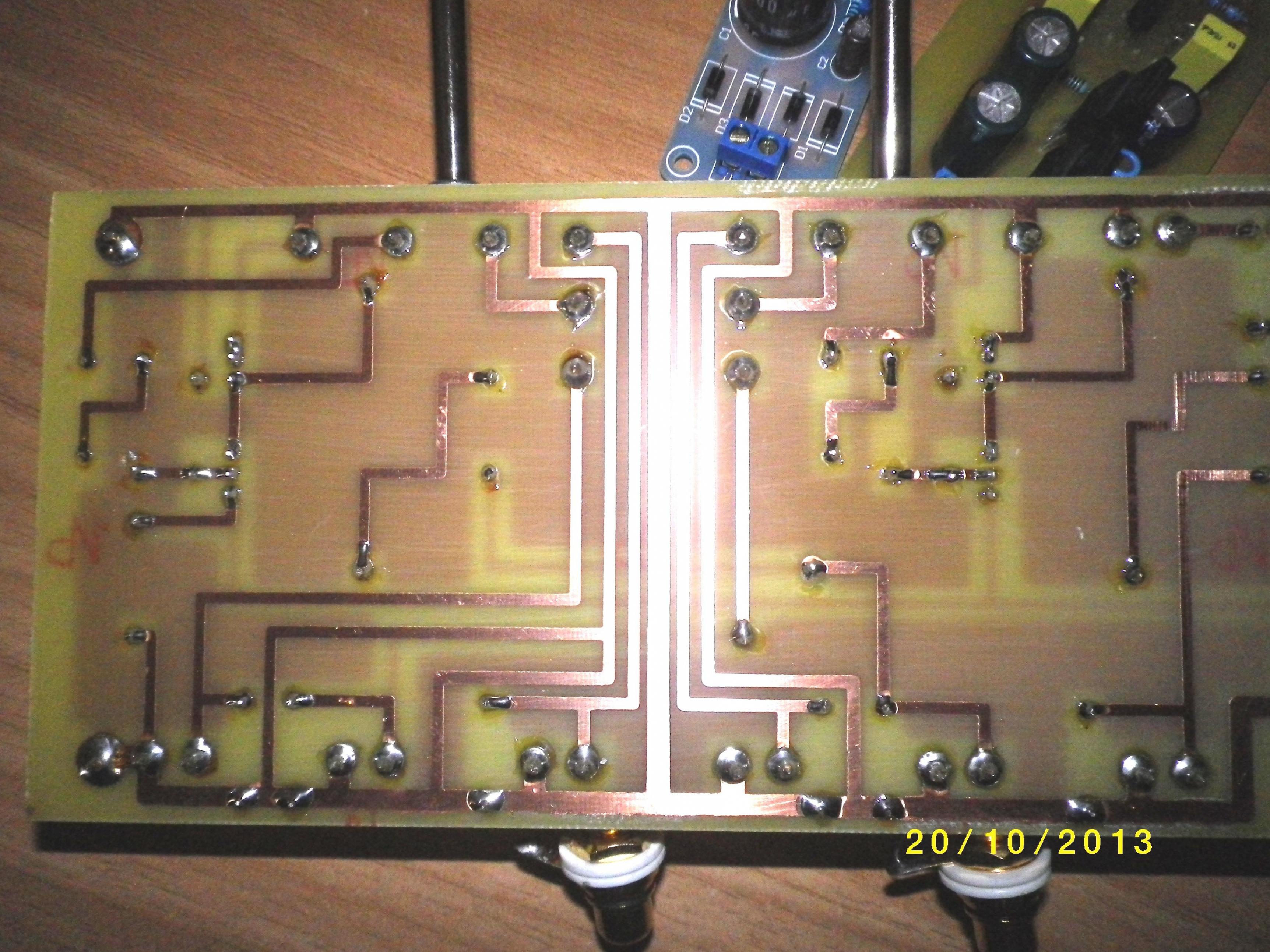

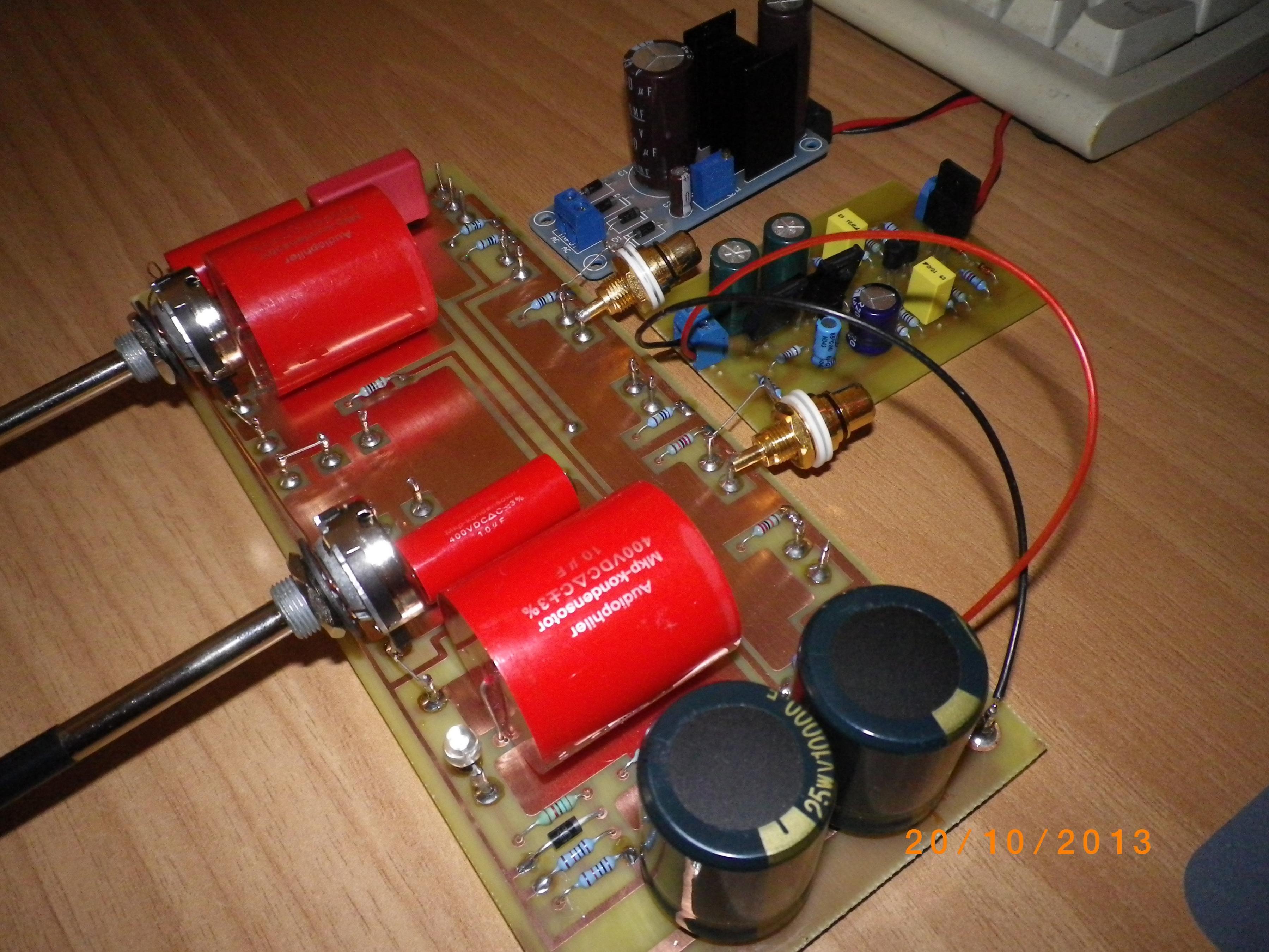

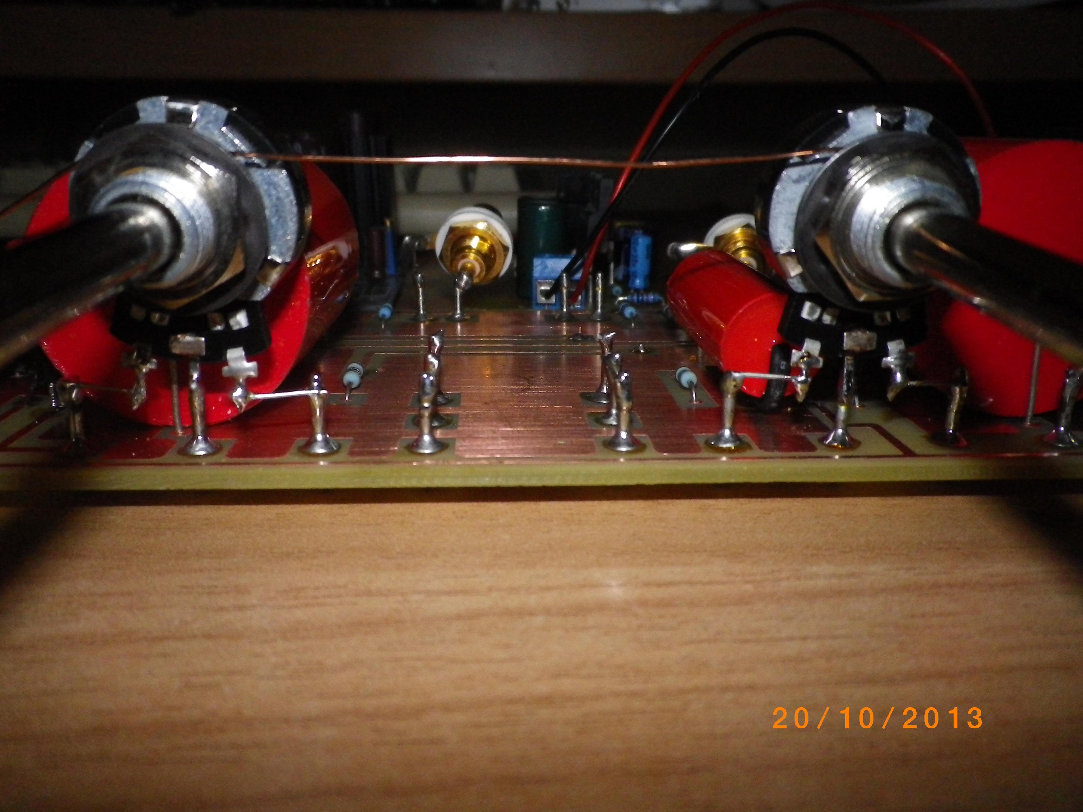

Hi
this is my B1 Buffer .
Pcb its from gerber fille .
2sk 170 matched to 7.8 ma at 640 mv gs... Offset is 17mv at start and after few seconds going down to 0 V when i have connect the output to input of my amp .When the output its not connected to input of my amp offset is 400mv end going down to 0v after two or three minutes
10mf-1mf Audiophiller
JLH Shunt Reg at 24V
LM 317 at 24.10 V from china
Two separate pots 25kΩ
Very detail- low dynamics- each region frequency has her own dynamic .But every frequency has its own dynamic
and this is what makes the buffer special.

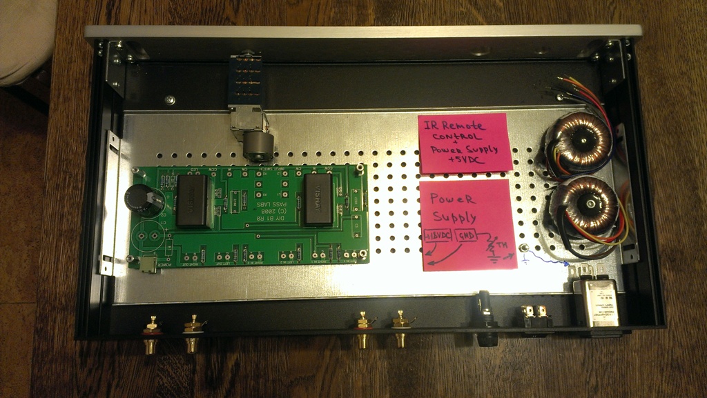

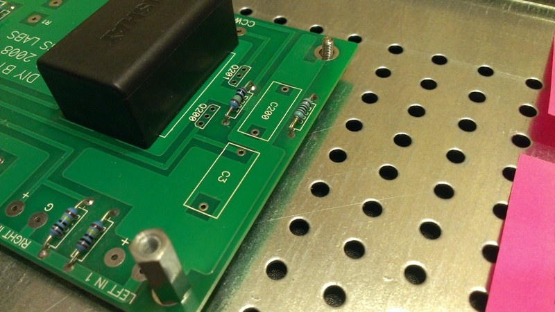

Grounding for B1
Dear friends,
Sorry, if this question was already discussed but I still have not met the answer.
Hope someone will help me.
The B1 board from Mr. Nelson Pass has mounting holes which are connected with GND conductors on the board.
So, it seems, that it was assumed that board GND circuit to be connected to the chassis... At the same time in F5, the signal GNG is separated from EARTH via thermistor.
Please, kindly advice me which way should I follow here - to use insulated mounting pins and use thermistor as in F5 or to use chassis as a signal ground (doubtfull)?
Best regards, Anton

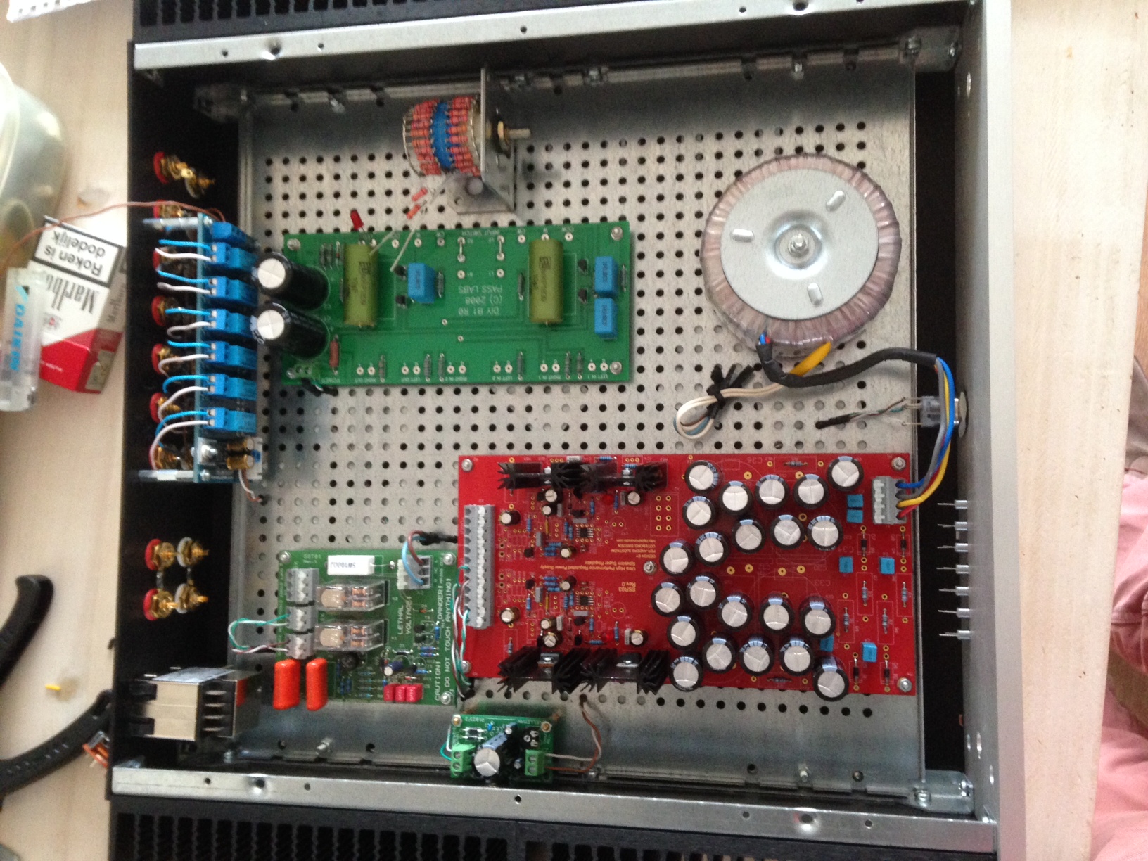

B1 progress
We are getting somewhere!
All power related wires are under the baseplate, witch is grounded....
Still waiting for the extender rods and the new attenuator.... The one in the picture is unfortunately broken so I went for a nice Khozmo stepped one from HiFi Collective..... :cool: It should arrive this weekend!
Any tips?

The PSU requirements of the B1 are not that critical. Nelson himself used a plain Wallmart wall brick.
As long as the input sockets are isolated from the chassis you can connect live and ground for each socket to the B1 board.
Mine is as silent as a graveyard, even with a 100W amp at full volume and your ears pressed against the bass cones.
