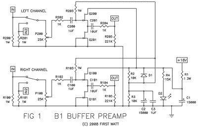

B1 Buffer Preamp

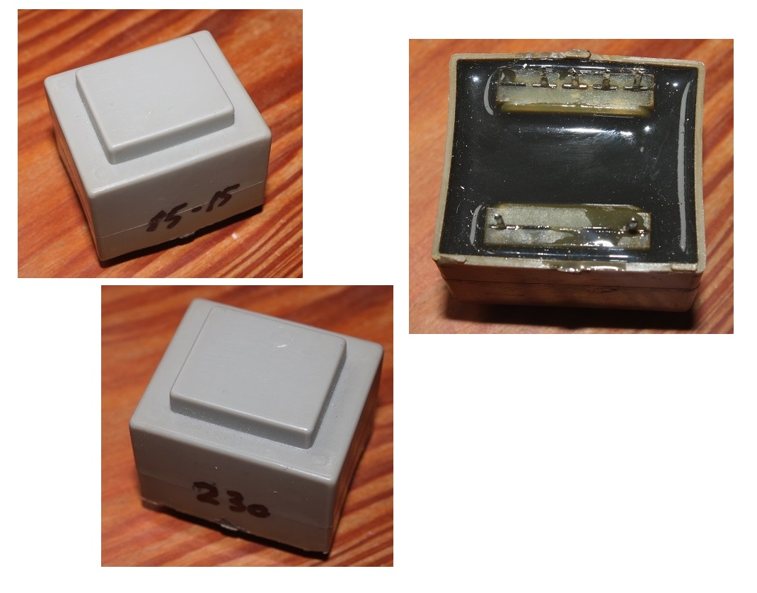

found I had a nice trafo
and also have some macthed LDR
so I hope its ok to try and build Nelson's B1 buffered LDR volume control :rolleyes:

Guys, I'm puzzled
Been rolling caps on my b1, everything was fine.
Recently I ve turned it on and had massive hum- had to switch off immediately.
Next day I did check everything, reconnected wires. Everything was fine . Used it for some time.
Few days ago I put my system on and notices weak music goes along with much louder hum. If I increase volume- hum increases.
Strange, cause everything seems to be normal.
10uf caps placed outboard- russian mbgo 2. 1uf is russian 71-4...
What can be the cause of the problem.
P.S. device running off the battery.

Same problem faced by one of my friend. Issues seemed to be the Russian made PIO cap itself. On measurement it was found leaking DC into signal. It was only one channel.
