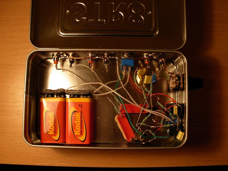

I started with high-pass part of the circuit, because this is what I need for my Open baffle speakers. For the moment, no notch filter, only a 12 db/oct high-pass. I set it up at 80 Hz. (I've experimented with a broad range of frequencies, and between 80-100 Hz seems to work best). The C and R values are calculated using Rod Elliot's ESP calculator: http://sound.westhost.com/project81.htm
The high -pass circuit is very similar to the block that he is using in Project 81, except that the op-amp is replaced by Papa's Jfet buffer. Well, almost. The exception being the current source; since I don't have enough 2Sk170's handy (can't buy them locally), I have purchased some BF245C ones. (Thanks Choky) However, I have to use it with the resistor to set a proper current...
Also, I'll use a split supply, +-9 v for the moment (I am using two 9 V batteries), but If I use regulators, I may most probably use +-12 v (7812 and 7912 Ic regs).
Work in progres...If I am lucky, I may get it done over the weekend...

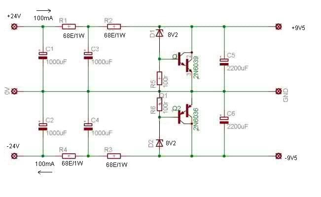

DVBjunky said:
Hi ZenMod,
so if i want to use the B1 in my Aleph J then your schmatic will work with these regulators?
Regulator LM317
Mini-Regulator
in both cases max input voltage is pretty close to voltage you have in Aleph J - just look at 25V markings on electrolyt caps on both regs you linked to.
anyway - bigger problem is that you can't use any of these for minus leg , because GND is already established on your main cap bank in A J .
if you made AJ , and you can make B1 , then you can make any adequate regs ........ either 317/337 , 7812/7912 or discrete zener followers ........ with pair of two small bjt darlingtons .
hehe - you can even make simple shunt regs with two darlingtons ...... just look somewhere in few Treshold NS10 threads for schematic

DVBjunky said:
Hi ZenMod,
Regulator LM317
Mini-Regulator
here it is - sweet & simple
use any smaller darlingtons , with Pd from 25W up

I need a bit help with setting Idss...
First, I measured Idss on 170's, using 9 v battery and tying Source to Gate. One of them was 9.4 mA and the other one was 10 mA.
So, I decided that I should tweak the BF245C resistor to give me around 9mA (It was putting put 14.2 mA without resistor). But, here is the problem: I started with 2.2 K between Source and Gate, and got only 1.5 mA. So I decreased the reistor until I got 9 mA. Resistor value was 110 ohms! (2x220 in parallel). It this Ok? :scratch:
why you have doubts in your own measures ?
maybe I mixed thing or two when I told you to start with 2k2 :rofl:
then that CCS string in my case was really for 1~2mA , not 5 :clown:
