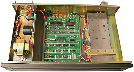

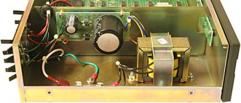

Hello...
I have ordered the B1 boards from Mr. Pass and I also have ordered the surplus chassis listed in post #2056 (thanks Lee35210)... it comes with a transformer which outputs two voltages +5v and +18v.
The site info for the chassis states "Filter capacitors are 22,000mF at 16 volts and 470mF at 50 volts. The end result is a linear DC +5 volts @ 1.0 amps and +18 volts @ 1.0 amps supply" The transformer output goes to what look like 2 transistors that are heatsinked on the back.
First question: Does "linear" mean regulated... is that what the transistors do?
Second question: Can the outputs of both be combined to total 23 volts?
I know I can run it at the minimum of 18 but I would like to try both voltages if it is possible to combine them.
Last question: If I use this PS do I need filtering caps as Mr. Pass has suggested when using an SMPS?

I bet those are regulators, you see on the chassis. Take a pic so we can see what they are.
Magura
Magura
This picture is from the site: The NABU Network - (ENC) 90020340
Eddie
I would need better than average eyesight, to read what's printed on those devices
Closeup please.
Magura
Laff... I don't have the chassis... I just ordered it today! These are the only picts available on the site!
Eddie
