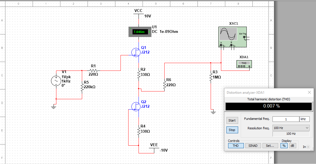

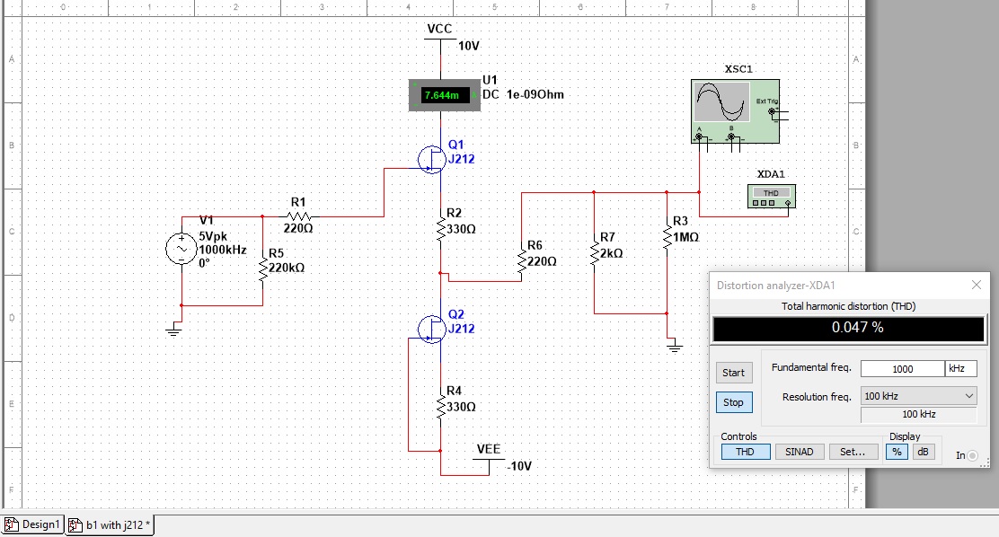

Hi Zenmod!
Because of my Papa is also smarter than their Nelson i could decrease R2 and R4 to 269R and make R6 100 ohms (R out is 1K at original B1 design as you know)
Yes 2sk170bl may be better (i am regretful that i sold hundreds of 2sk170 and no stock left.I have some hundreds of 2sj74 though,i am keeping them ) but difference seems not too much (at least on simulation) and this is mostly 2. harmonic.If there is no difference on blind test i can live with it.
Maybe you can send me some hundred of 2sk170bls( i heard you have ten thousands of them) as free gift
