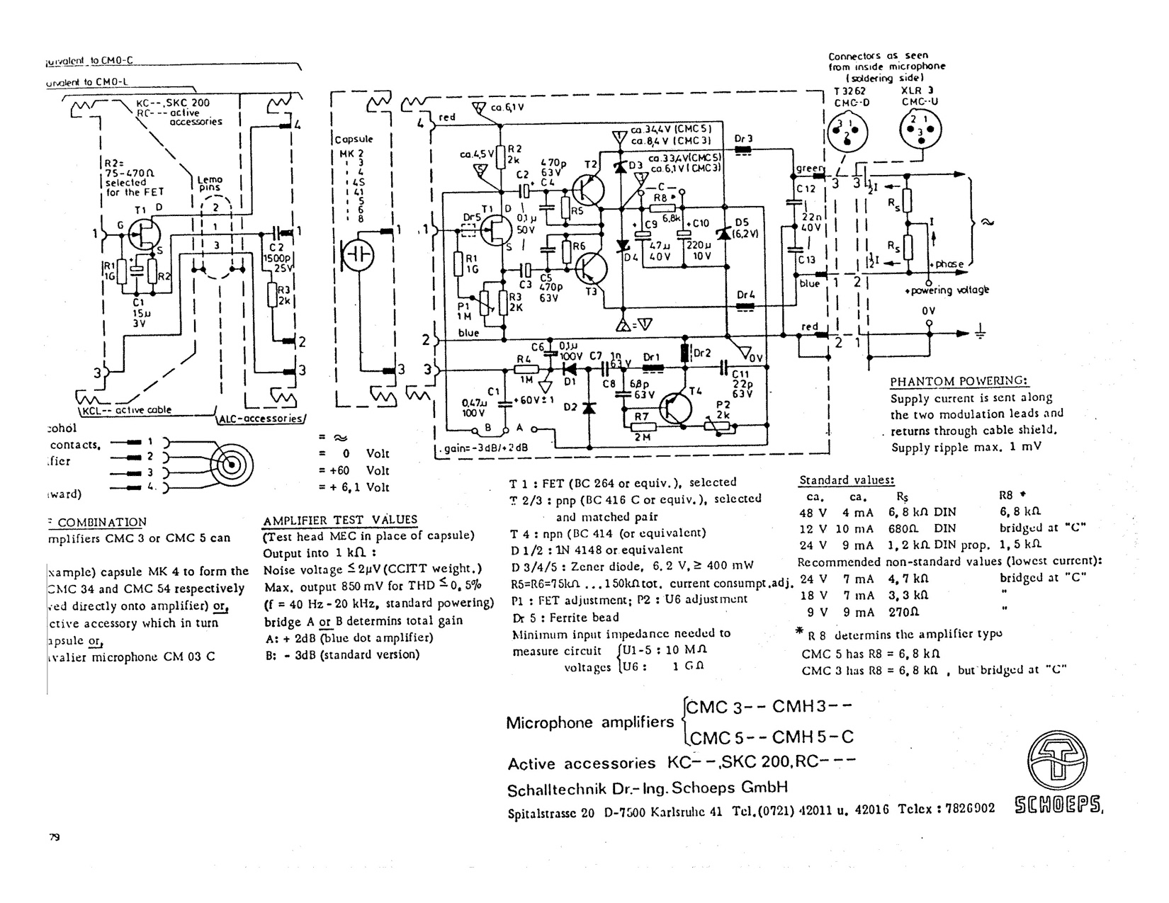

Perhaps the Schoeps-phantom circuit topology approach can be of use here to provide that output buffering ? (attached pic: T2, T3)

The Shoeps circuit did give me some new ideas. With the current based source the shield and the negative supply are the same which limits some flexibility but I still may be able to get there.
I suspect the output Z of the microphone will be low. The B&K capsule has higher output so they don't need gain. My guess is that is on the order of 100 Ohms or less. When you get ti running it would be interesting to know what you find.
The capsule output is 50 mV at 94 dBSPL which is the same as the 1" capsules and lots more than the 1/4" Panasonics. The circuit may be a simple follower internally, which would also make sense if you need some calibration predictability.

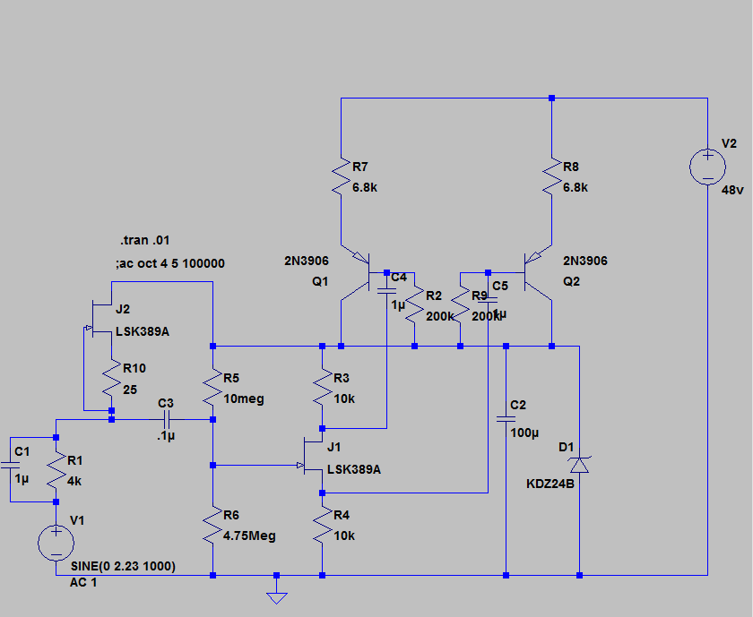

Attached is a circuit borrowing from the Shoeps circuit (Shoeps are known to sound good so its a valid source to steal from).
I modeled the B&K as a voltage source with a series resistor bypassed with a cap.
I used a Jfet as a current source to bias the microphone. I would also look at an LM339 + a depletion mode Mosfet for a higher impedance current source but that's probably overkill.
The Zener diode is the first one in LTspice's list at 24V. I might use a shunt regulator for lower impedance but again, possibly overkill.
It all works with a 48V supply. Since the internal rail is 24V I don't think it will work for anything much less than 30V. The mike bias is the real limitation.
Tweaking the base resistors on the PNP's adjusts the current. its not a great solution since it will be temperature and device sensitive. The value shown seems to work across a range of load currents (changes to the Jfet current source).
I looked at pJfets as an alternative to the PNP's but they are not well suited to this. it should be pretty insensitive to the quality if the 48V since the outputs are low Z and the only high Z is the Jfet and it has an isolated supply. The caps shown seem to be OK to 10 Hz.
I'll post the other single ended solution later.

That looks good, thanks for posting. Using the FET for the current source is attractive - since the number of builds is low, the adjustment/selection for current no drawback. The Schoeps is indeed a proven & tested circuit. So having both signal polarities available to send to the XLR-3 is no real hassle, comes at modest parts cost.

Your circuit is close to where I started. Getting the mike to work is pretty easy. Getting an inverted output with no power source etc is not. However the Shoeps circuit lent itself to this task.
Today i usually start with the simulator. Finding paper and pencil have become harder in the new world we live in.
I guess in the circuit I posted the (2) PNP current mirror could use a zener to stabilize the voltage and from there the current fed to the B&K.
Or replace the whole BJT-current mirror by the JFET current source.
Just wondering about C1, you're using that to reflect that the AC is available LowZ ?
Best regards
Joined 2004
C1 is to emulate (as a guess) the source Z of the microphone. Need real numbers as some point. The current mirror has a few drawbacks. First polarity. It doesn't invert phase. Second is getting the same amplitude and current. No solution got there without degrading the opposite phase. If the low side of the mike were available its easier but no shield and not practical.

The nice thing of the 'Schoeps approach' is that we can have both.
