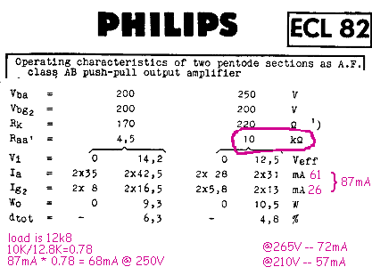

Let's look at the databook.
http://www.mif.pg.gda.pl/homepages/frank/sheets/030/e/ECL82.pdf
With 250V 10K load and *Sine* output we should have 87mA total cathode current.
Adjusting for 12.8K and 265V or 210V I get 72 and 57mA.
What strikes me is that your reading is "twice" what it should be. Are you very sure you do not have 8 ohm load on 16 ohm tap?
It's a 16 ohm load on the 16 ohm tap, using a speaker for play testing and a resistor for sine. I am now realizing that when over-driven the average current will go up. That's probably why I'm so much higher than calculated. Thanks.
