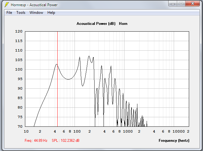

I noticed that too. I went hunting more than once and came up empty. I did get some verification from others in other threads at some point but agree yours matches Art's best. I kinda wish each thread would offer a verified HR in OP so we don't have to hunt... Gotta scoot but file posted, maybe we'll figure it out.
  • KS.txt

Zett, kinda sorted it out. I grabbed the HR inputs for the LAB15 in post 254 KS thread. Looks like yours came from a bit earlier when there was some attempt to better the sim to correct for the KS exit. Not entirely sure if there was a consensus that this new sim was better... You may not recall that Art reminded folks is mic was not flat so the measurements are off slightly. Post 129. In the end, a sim is a sim...
