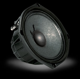

I am looking for suggestions on the sizing of a tractrix horn for this driver. Crossover points are at 500Hz and 2500Hz. Speakers will end up being in a 3way setup with a Mackie fussion amp. Crossover points are fixed unless I start swapping components out. I was thinking along the lines of an X-tro type box but I supect that the midrange is where I will need the help. Thanks in advance, JPBoyt
You will need a proper phasing plug to reach 2.5KHz with the 8PE21. Even at that, you’ll still have a hard time getting the last octave to 2.5KHz. My experience with the 8PE21 is as a mid bass horn in the home Hi-Fi environment. Pro sound applications are different, but not so much that conclusions can’t be made. It is possible that a phasing plug along with the narrowing high frequency directivity of the tractrix, you could reach 2.5KHz with the 8PE21. I would suggest a full size 400Hz tractrix with a 29.9cm^2 throat. The real challenge will be getting the back chamber small enough. Since you only want to use it down to 500Hz, the back chamber has to be very small, like less than 500CC. If you can’t get the back chamber small enough, then you will have to go to a bigger horn. However, the bigger horn will hurt the high frequency performance even more. You have two forces fighting each other. A smaller woofer would be a better idea here. Then again, depending on your application you may need the power handling capacity of the larger woofer. It seems you are in quite the pickle.

That would be me. I’ve A/B them in the pictured full size 142Hz tractrix. The faital 5” absolutely smoked the 8PE21 in this horn. Due to the Faital’s higher Fs, I was able to leave the back chamber open. The 8PE21 sounded congested, unfocused and dull in tone compared to the Faital. However, when the 8PE21 is equiped with a phasing plug, the gap closes. IMO, the Faital is still a better choice. I must restate this was in a home Hi-Fi system and NOT for PA use. The above may not apply to PA use.

Thanks for the info. I guess I ought to start over with my list of components and then ask for suggestions. I aquired a couple of the old Mackie Fussion amps, 3ways, that are rated at 1000w, 200w, and 100w into 8ohms. The crossover points are at 500hz and 2500hz. The drivers I have for each box are 2ea B&C 15PZB40 8ohm, 1ea 8PE21 8ohm, and 1ea DE900 8ohm. I own a total of 8-15", 4-8", and 4-1.4". My plan was to end up with two active boxes and two passives. My plan was to run the 2 15PZB40 drivers in series to load up the amp a bit and then be able to run a second passive box, in parallel, with the same driver set. I would end up with 1000w into 16ohm as a single box and 1000w into 8 as double boxes. Mid and highs would be 8ohm single and 4ohm in the active/passive pair combination. These particular components were selected for numerous differing reasons. Price and availability for the most part. The 8PE21 was actually selected for its reasonably flat response between 500hz and 2500hz. Obviously this is not for livingroom use although I love testing the subs next to the piano. Defines sympathetic vibration.

Thank you all for the info again. Based on my learning about a drivers usefullness in a horn loaded application, relative to free space frequency response, I now can see why I could never get Horn Response to give me a good curve that didn't die before 2.5kHz. I think that my best solution is to see if there is a decent waveguide I could us on the 8PE21 and mount the whole mess in a sheet of plywood. Horn loading the drivers looks to be frustrating at best short of some trailer mounted thing to get the lengths and openings right. Most of the stuff I modeled for the frequncy ranges, ended up with extreme loading ratios in the neighborhood of 35/1. Don't think the drivers would like that. Final question, Where do I get info on waveguides?
