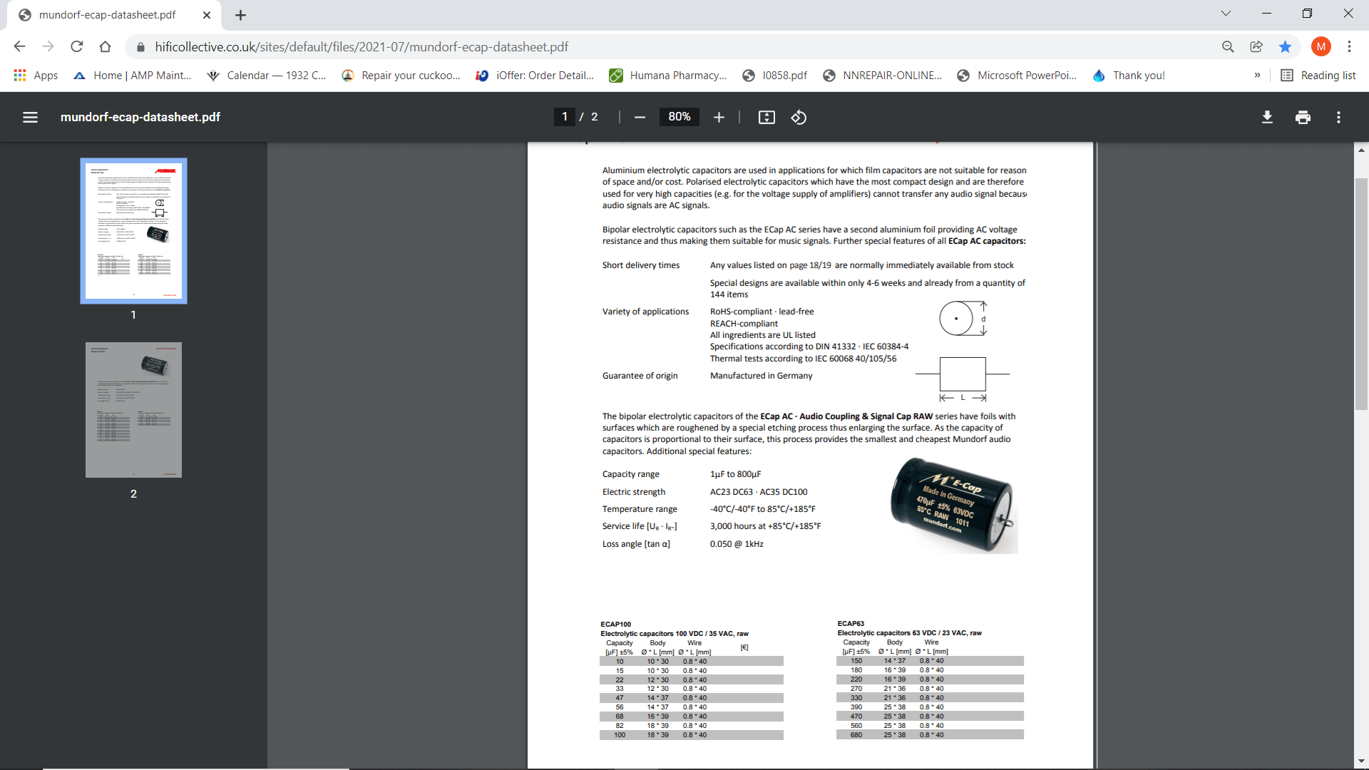

Axial Electrolytic Recommendations
they sell a 270, not a 240; a 680, not a 600 and a 470, not a 450.
The ones you get today are basically the same, only modern values try to follow a "normalized series" , labels show nearest "series" value and of course you have tolerance to consider anyway, so ...
