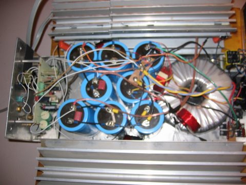

GL and Grey, I am posting some pictures of the conversion project from an Aleph 1.2 to an AX 130+ I think.
The picuture here is my 7 year old aleph 1.2, in disassembling it I found that the cl 60 thermistor to ground was smoked in half but it still read 16 ohms cold, I have no idea what happened.
The cl60 surge thermistor I replaced a few months ago and then bypassed it with a ac relay set for 60sec's to protect it.
This is not an easy project-more pics to follow.

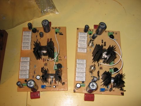

circuit boards with pt to pt wiring:
I mounted the diff input pair to the same heat sink and measured and matched every resistor and fet.
I have to do a continuity and node check on the boards to make sure every thing is hooked up correctly before I put it into the amp.

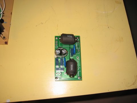

Grey talked me into a dc blocking cap and noise reduction circuit to eliminate any transformer buzzing. The Plitron 2kva torrodials for the Aleph's buzzed like a bees nest hit with a baseball bat.
In the prior picture of the cirucuit boards I installed high quality pots to do the dc bias and set the current source to 50% gain.

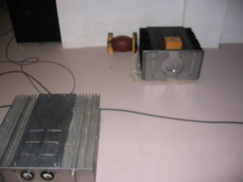

I couldn't resist, my Pass A75 built in 1993 is still bigger than the Pass 350.5 seen in the background. The only dimension the 350.5 is largher is height 9'' to 7". Yes I tried to help NP's bottom line with my first purchase in 15years. It was quite a negotiation for the 350.5 but when DNA evidence dating back to the 15th century proved that the salesman and I were long lost brothers from Scicly he consented to a deal. I of course had to point out that there was one minor scratch on the bottom of the unit and that the shipping box looked like it had been run over with a lift truck entitling me to several thousand dollars in discounts.
dave

Hi Dave,
Thank you for posting the photos. It looks like things are coming right along. To answer your questions from 3 or 4 posts back:
1) When the time comes you will be looking at the the absolute and relative offset voltages on the outputs - not at the voltage across the diff pair drain resistors. You might look at these voltages as a first step in troubleshooting if you can't get the outputs to adjust to zero. Just remember that the diff pair CCS adjust pot can swing the output DC over a huge range - like rail to rail - plus it's very sensitive. You need to variac the amp up to where the CCS turns on before you can start making effective adjustments. That means more than 9V across the zener in the CSS.
I am not aware of anyone who has trimmed the diff pair with source resistors in the Aleph-X. I wouldn't bother.
2) Yes.
3) Like you say - sometimes NP uses caps in these locations and sometimes he doesn't. My amps run fine without them.
Yes - you are on the right track.
