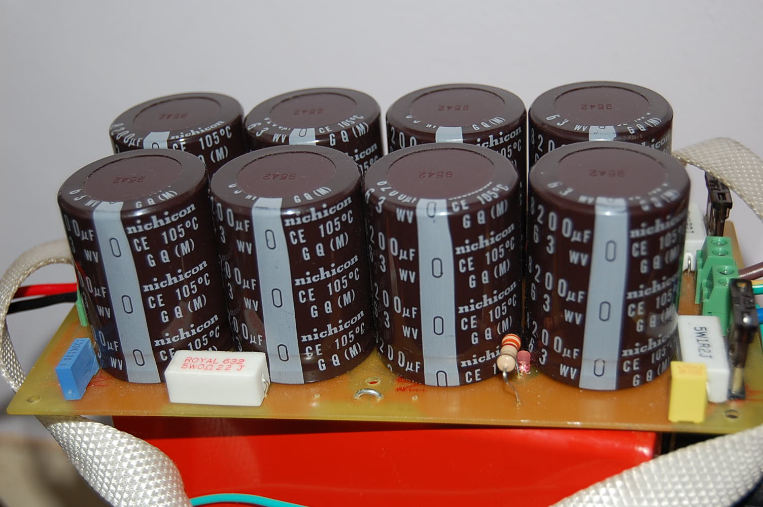

I'm getting ready to finish my PSU , 28 V +/- with 1000KVA trannies /side and 240K uf caps, it will be a separate chassis and allow me to try out different amplfiers ..

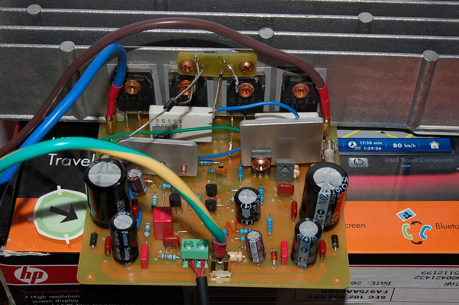

One channel is working
I have made the PCB and build one channel with components from my parts bin.
VAS - BF469 & BF470 (Philips)
Driver - 2SB649A & 2SD669A (Hitachi)
OPT - 2SA1490 & 2SC3854 (Sanken)
Bias Diodes - 1N4936
The 18V zeners have 18.4V forward voltage drop, I have to use four pieces of 1N4936 diodes to get about 100mA across each emitter resisters (1N4148 & 1N4004 diodes gave too high bias current). I am still experimenting with the types & mounting of thermal-compensation diodes.
The Amp is quiet (no hum or hiss) and it is clear with bias towards the higher frequencies. Violin & jazz sound good on this amp.
The initial test was done with only 6600uF filter capacitance per rail and the sound was quite thin. I then increased the filter capacitance to 32800uF per rail & the sound become more balanced.
I will build the second channel with 10uF DC blocking cap, silver mica caps & Toshiba VAS.
- Stanley
