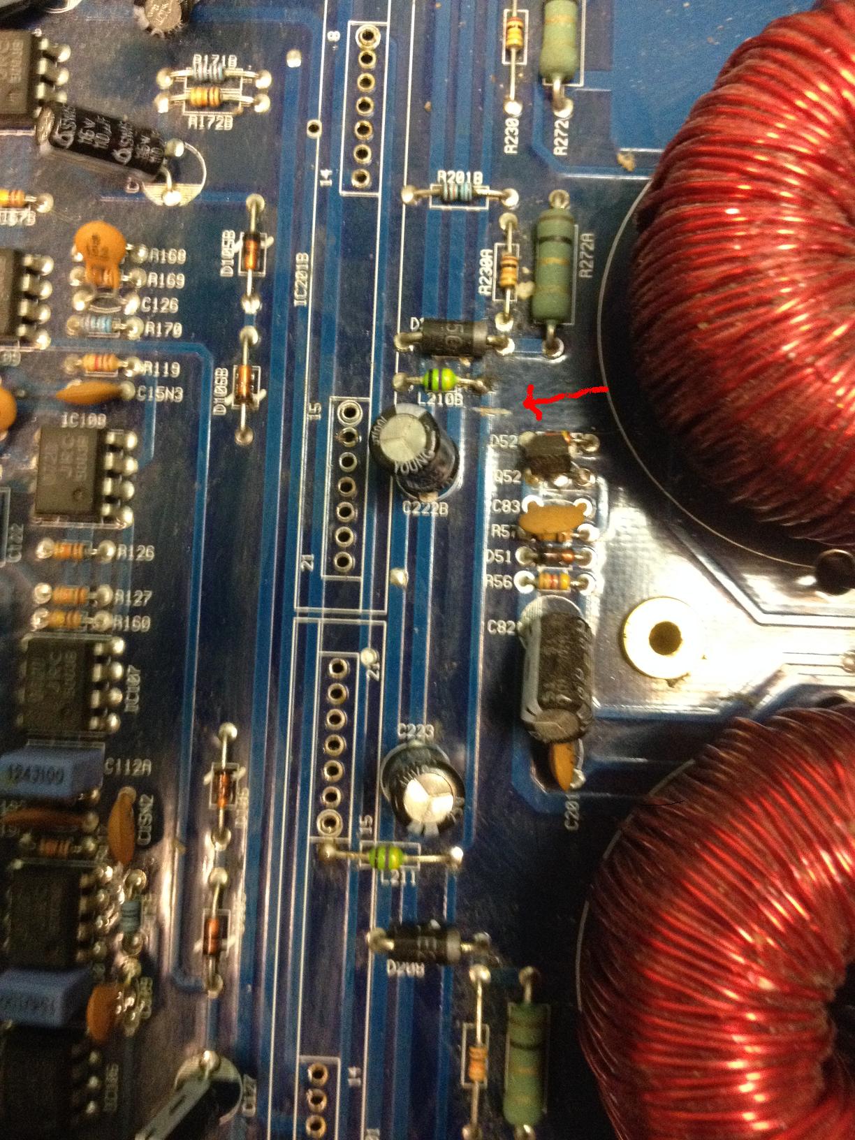

I have a strange issue with theis amp..
If i install the audio driverboards amp will not power up no power light no nothing its dead..
If i take both of the audio driverboards out of the amp amp will power up and idle perfectly ..
I checked all regulated voltages and all are there and correct..
I get rail voltages also..
But with the audio driverboards in i get nothing..
Any ideas what might cause this or what to check??

There are too many pins with 0.00v. Various problems:
Pin 5 should be at approximately 1.6v. The IC wouldn't produce any pulses that could be considered normal with that pin at 0v.
Pin 2 should likely be near 2.5v. At 0v, the comparator (internal to the IC) can't function.
Pins 9 and 10 are generally the same voltage (±0.05v)
When it was idling perfectly, did you confirm that all FETs were being driven?

ok i resolerd the power supply driverboard to the main board
Heres what i get on the 393 now

It may be too fast for a multimeter to catch it. Use your scope. Set the vertical amp to 5v/div and set the coupling to DC. Align the trace to the reference. Set the timebase so that the trace turns to a slow moving dot and watch the voltage on pin of the 7500 closely. You should see it pulse at the point where the voltage on pin 3 of the 293 jumps back up.
