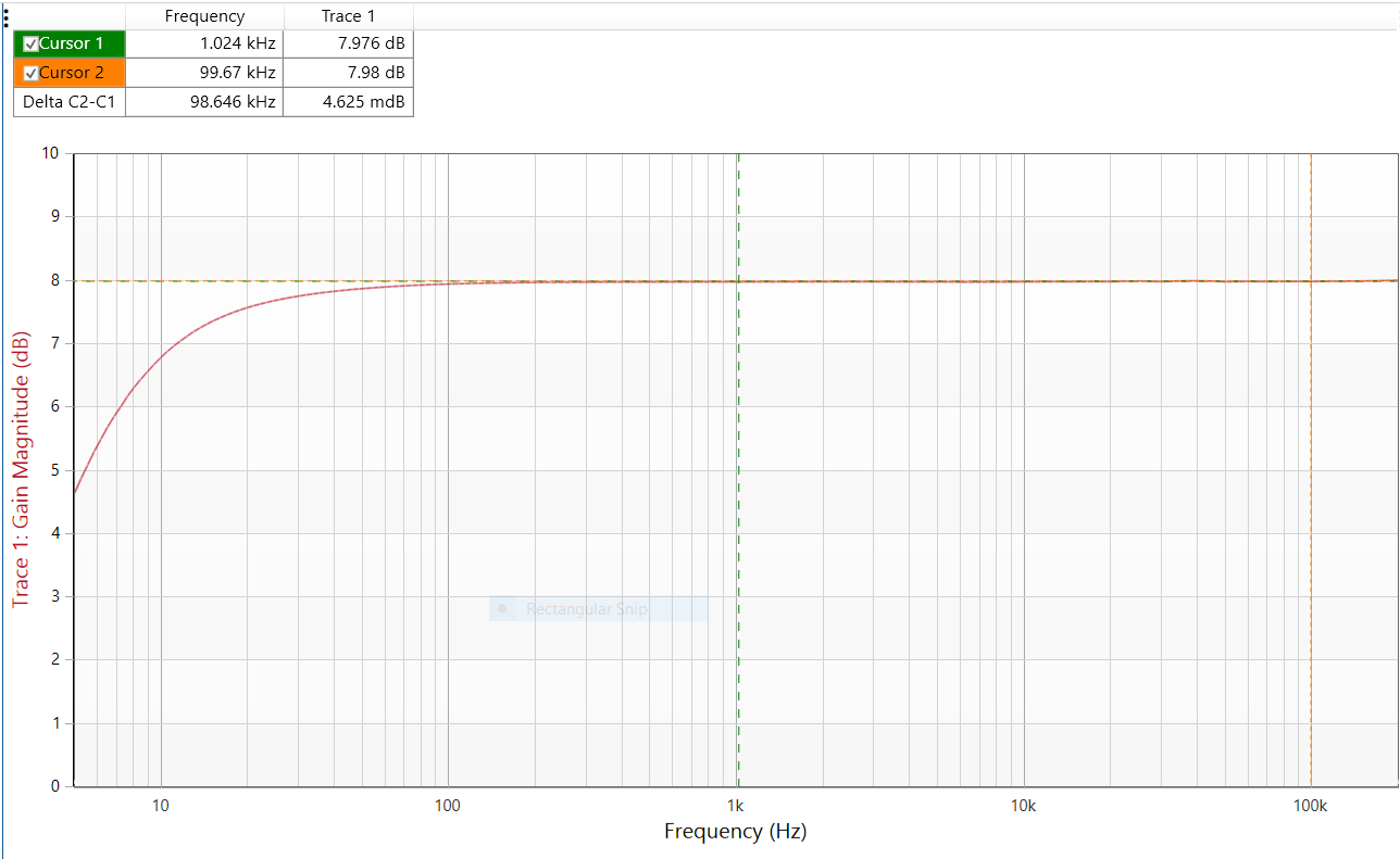

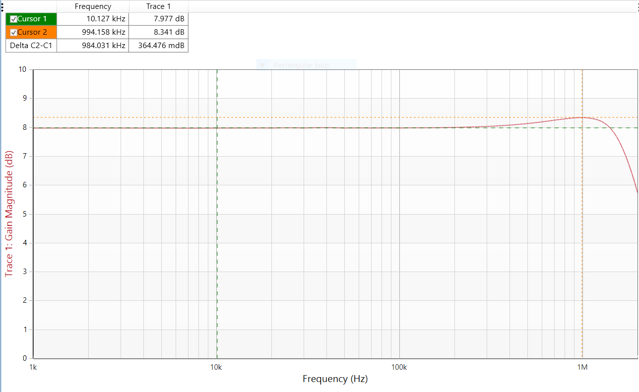

To the graphs: note the magnitude delta's in the cursor readout boxes..
Jan
