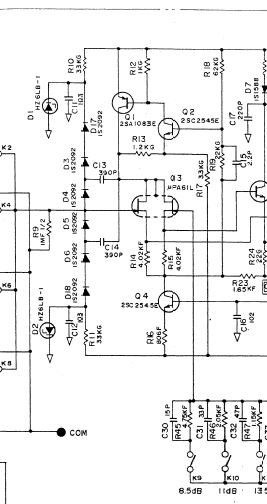

There are tricks using the gate-source of a Jfet as a low leakage diode. However those circuits are so fragile that they don't offer much protection. Below is the bootstrap used the Shibasoku that is good to well below -130 dB. You could build a variation with a buffer connected to the inverting input of the input opamp to drive the bootstrap caps.
The input C variation is a major limitation in distortion analyzers. With a low Z source you don't see the effect, however from a 10K source it can be obvious. The circuit below goes to great extents to eliminate those effects with the bootstrapped cascoded Jfets as followers into a bipolar pair.

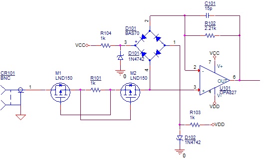

I understand if you don’t want to disclose, but are you using a circuit like the depletion mode current limiters with 2x LND150 or similar to handle overload?
Attached is the setup I experimented with; the idea was from an old EDN Design Idea, with the comment it needs optimization for any practical implementation:
- The Zener diodes need to be forward biased for the works condition (input current is the depletion mosfets saturation current, here about 2mA, if memory serves)
- The Zener voltage needs to be chosen so that the diodes reverse capacitance is in a region with an as much as possible minimum variation, while not pushing it far enough to increase the reverse current.
- The op amp feedback resistor needs to be optimized for a specific value for the source impedance (I used the standard 600ohm).
- The op amp feedback capacitor needs to be optimized for an as much as possible flat response for the distortions vs. frequency, and is specific for each op amp.
With the values in the attached schematic I was able to get a THD anywhere between -127dB and -140dB. This setup cancels both the distortions caused by the reverse capacitance and reverse currents of the diodes, but it needs a diode quad (which are 99% already matched; using individual diodes without matching will not work as expected.
I will try the same setup with the above indicated dual PIN diodes and see if I can get the same distortion numbers, or at least a wider range of source impedance for some -130dB THD or better.
I know the approach (the diodes are AC bootstrapped with a copy of the input signal) and, to my experience, it works fine as long as you can get dual matched jfets (which are not exactly available today, other than the LSK389). Otherwise, the common mode distortions will dominate. I don't know how to apply the same principle to an op amp, it might be possible, but would be certainly more complicated and dubiously better than the bridge distortion cancellation above.
