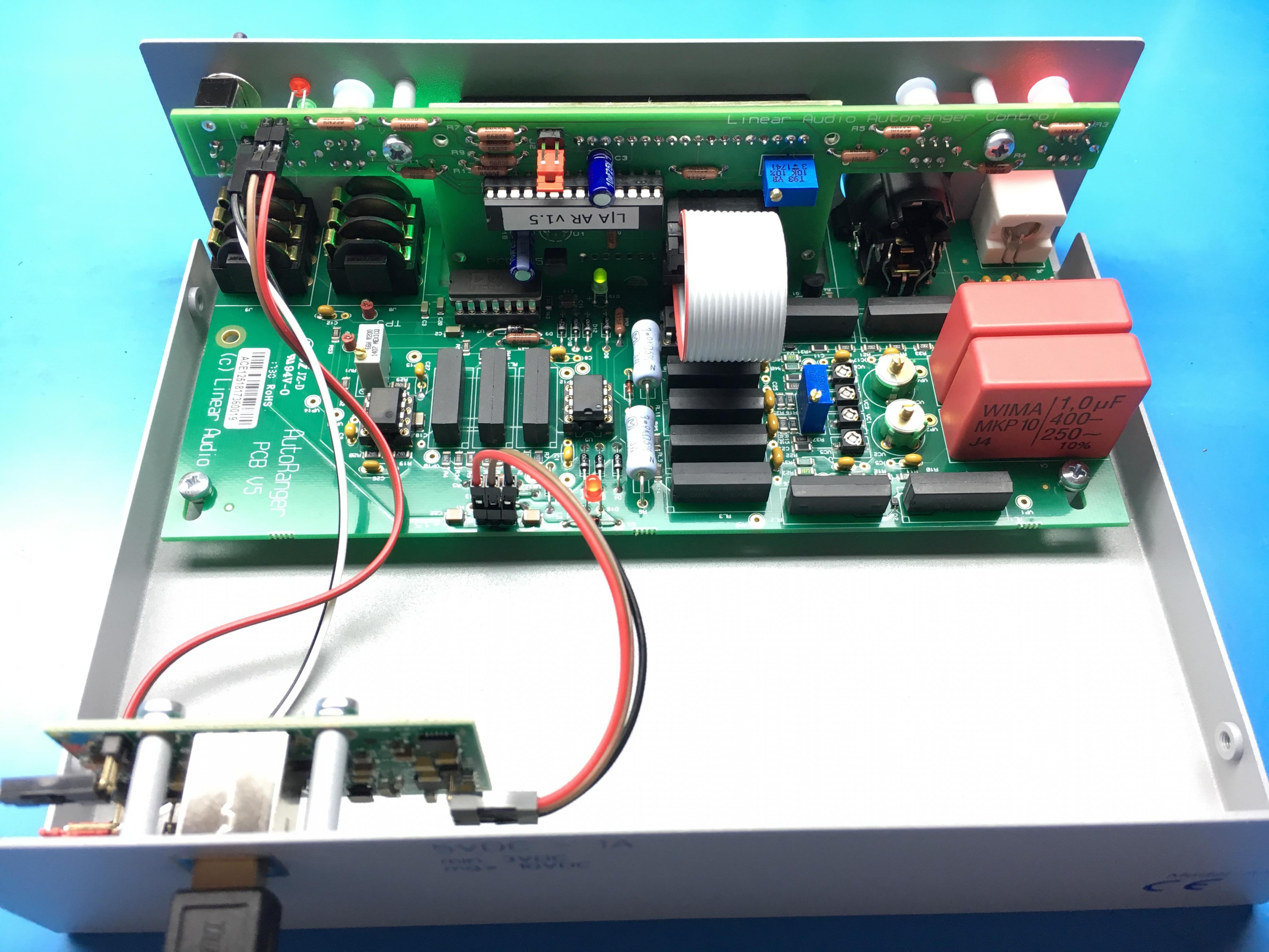

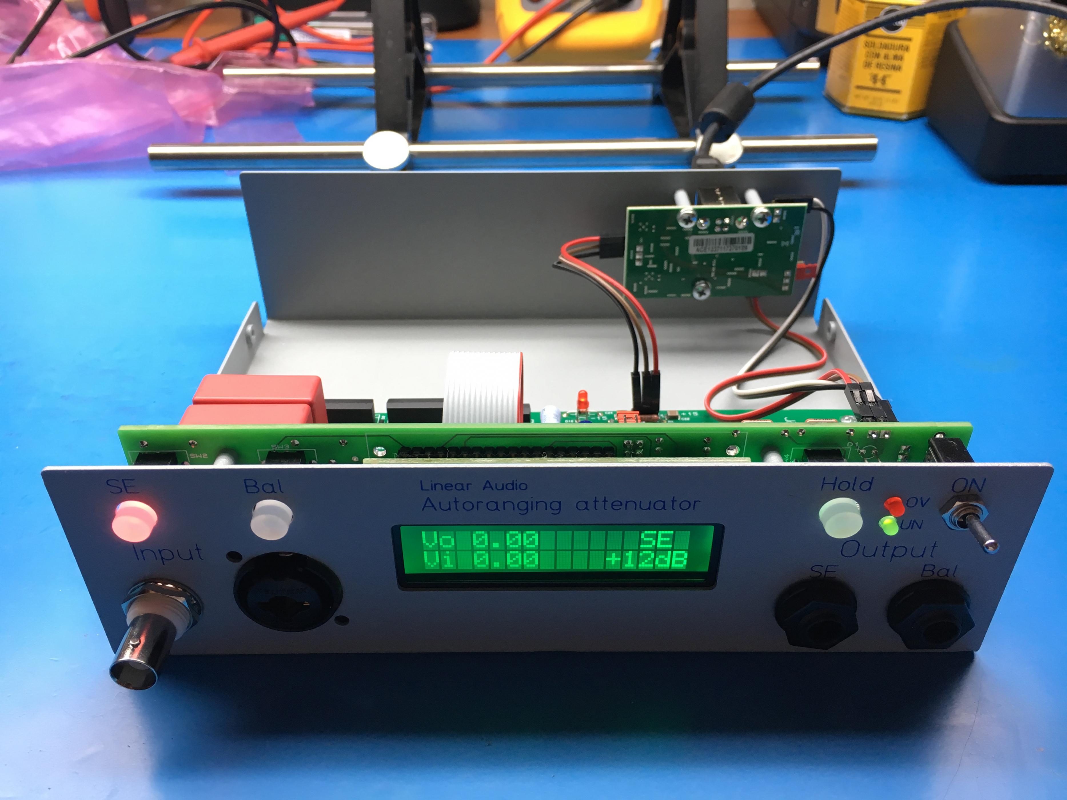

So another one lives. Really superb fitment with the case, etc. Will add some little silicone feet to keep it from sliding around. Feels like a gem of an instrument and has the looks to match. Nice work!

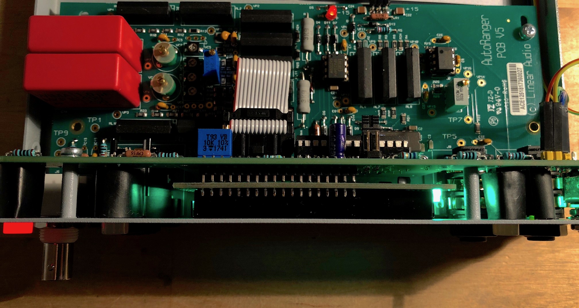

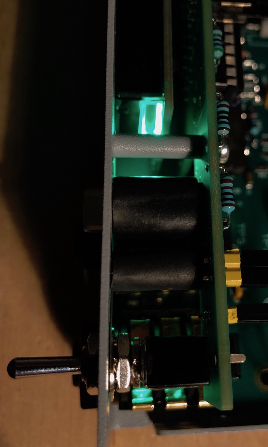

A tip and a wish
My unit is up and running and seems to function well.
Great work Jan!
The tip:
Add heat shrinks to the buttons and the LEDs to mitigate false light from the display and LEDs to hit non-actuated buttons. The buttons are quite transparent.
The wish:
The instructions for the calibration procedure in the spreadsheet can be more clear than they actually are. Or I might be a dumb-*ss (my ex-wife will tell you so if you speak to her).

Hi Kim,
Yes the non-activated buttons still transmit some light from other buttons. I don't think there would be confusion as the light level is much lower than the activated ones, but your solution with heat shrink tubing sounds good.
