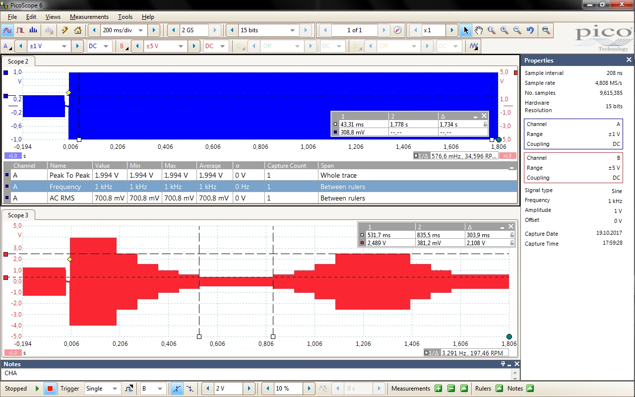

Just made some measurements. Attached a screenshot of my scope. Blue is the AR input signal, red is the AR output. All connections unbalanced and shielded coax.
Input voltage jump from 316mV peak to 1V peak. The AR keeps on "auto-ranging" infinitively. It does not matter wheter its a up-jump to 1V or a down-jump to 1V.

OK, can you tell me the two settings it alternates between? Like between 0dB and -4dB, or between +4dB or 0dB?
I need to know that to be able to diagnose the problem.
Thus my request to slowly turn up the input signal from zero upwards and see what the switching does.
Does it correctly switch from +12dB (with zero input) down to +8dB, +4dB, 0dB ... when you turn up the input signal?

@Black_Chicken: one more test to help me diagnose is the accuracy calibration. Switch on the AR while keeping the SE pushbutton pressed and the unit will force 0dB and wait for you to connect a signal that caused exactly 1V output (see cal procedure).
Then you press Hold and it will show the correction count for the calibration.
How much is that count?

Sorry for the delay, during the week Im always quite buisy with work and other things...
#1 The level was calibrated by me and the displayed levels are accurate. The display shows -4 correction counts.
#2 sweeping from 0 to 7Vrms on the SE input the AR behaves like:
* less than 0.3Vrms, +12dB
* at 0.35 Vrms, +8dB
* at 0.56 Vrms, +4dB
* at 0.85 Vrms, 0dB
* at 1.35 Vrms, -4dB
* at 2.2 Vrms, -8dB
* at 3.5 Vrms, -12dB
* at ~5.5Vrms, -16dB
downsweeping the thresholds are some millivolts lower, but essentially at the same levels.

proper measurements
Alright, here are some real measurements. The sweeps were done manually, VERY slow and careful. Frequency is roughly 1kHz.
The issue is still there, if I turn the level knob of my generator reasonable fast. For instance at 1V peak.
Your data shows correct operation. The -4 correction count is normal (I have seen between -9 and 0).
So it only happens when the input level changes fast? Just checked my own unit and I can bang it with whatever I want and it just settles to the correct setting. If I really try to mistreat it I see sometimes a one-step overshoot but that is all.
I need to research this. I have myself build 4 units so far and haven't seen it. Give me a day or so.
