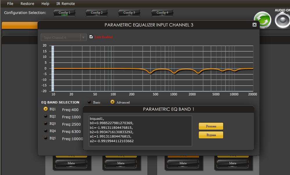

@ lduarte1973,
If you have a 2x8 or 4x10 platform, only the 4x10plug-in will work. Others are for 2x4 smaller DSP.
As for your question for REW, you just need to manually import to each dialog box. (i.e. save on desktop and copy and paste each biquad section). The REW import button of 2/4 way advanced wasn't implemented on this plug-in. That doesn't mean that REW doesn't work though.. All biquad automatically calculated by REW can be imported into the 4x10/10x10 plug-in. It's just taking a 2min more time.
It's planned to add that feature in the future version.
DevTeam
