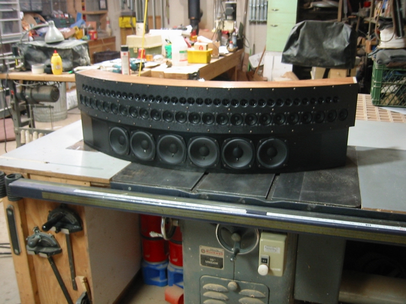

rb132333, that CC you linked to and the other 2 pictured below are exactly what I was thinking of, albeit in a much smaller and less audiophile form.

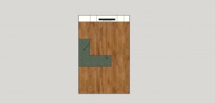

Here's a little bit more info.
The first diagram below is a quick sketchup of the living room layout. TV in black and the CC in white on the top wall. I'm figuring that sitting on the left side of the couch will result in about a 30 to 35 degrees off-axis angle.

The next diagram is the solution I am proposing. All drivers full range spaced as close as I can get them with each driver angled about 6 or 7 degrees from the one beside it. That means that the outside drivers will be firing at about 18 to 21 degrees off-axis so now that side position will only be about 10 to 15 degrees off-axis which seems to me to be much more reasonable. I guess 1 of the things I'm wondering about is if that 6-7 degree angle between drivers is sufficient as it looks to be less than that used in the other curved CC's pictured.
Regarding sensitivity and SPL, I have no doubts that 6 of the Auras will be able to handle everything that my sister needs. Huge THX volumes are not 1 of her priorities. In terms of getting down to 250Hz, again the Auras look like they can handle that easily although distortion below about 1000Hz is a bit of a concern but I've got to figure that 6 of these Auras are going to be much better than the single little driver in the current Sony CC that my sister has been more or less content with for the past 6 years. Really I'm just trying to create something that's going to be an improvement over that at a fairly reasonable price.
