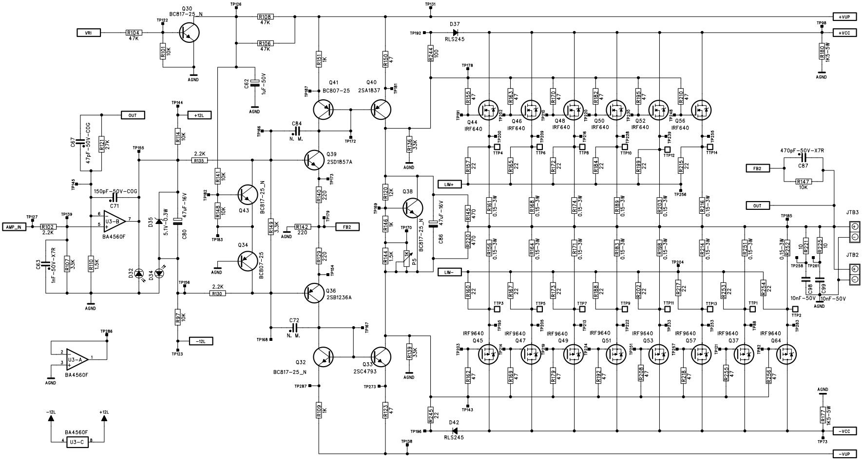

He has a single fet that shorts out internally, but it is random which one that fails and it does so at low power constant driver into a resistive load. And only the N side of the output stage. The P side is AOK every time so far.
We have been waiting for a new batch of fets to get in so he could try another source and brand of fet to see if he has been a victim of counterfeit devices at this point.
He says all of the normal things like gate resistors and what not are checked and Ok and the amp is stable and not oscillating by way of a O-scope check..

Its unusual for just one side to go.
Once the n-channel is short it puts a huge strain on the other side and usually takes out both p and n channel fets. Perhaps the fuse is blowing before the p channel goes as well ?
I would be looking at the bias circuit to ensure it has correct bias as this will keep on wiping out output fets if it is wrong.

when it sound (for 5 minutes) in my friend's car @1ohm with ReAudio, it goes well. Deep bass, very powerful and controlled.
But after 5 minutes..protection then, protection confirms outputs N stage fails.
Before protection: no heat, no distortion...nothing.
Amperometer said there's a little increase of current, some fraction of second before failure. I think it's normal because without protection, i'll blow the fuse or the power supply.
The amplifier makes no differences between 4ohm 2ohm or 1ohm, or 20w, 200w or 900w......it will fail after small times.
it works only at idle, or with dummy load but with no signal applied.
over 10w....it will fail.

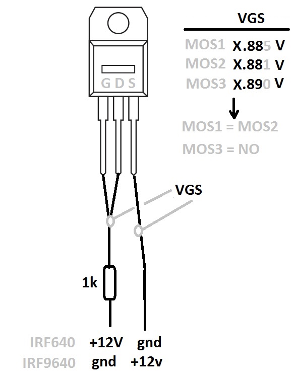

When you use paralleled output mosfets it is imperative they are identical devices (usually the same production date code should do fine, no need to sort them). Is it possible that you are using output FEts that open at different gate voltages, thus the device that opens first will sustain all the load causing it to fail?
I don't think that's the problem. All 6 fets where replaced all from same production date. When one fails under test I replace it with same batch as the rest. Then I try to replace all 6 fets when 1 failed but still the problem continues.

Hi, I hope you are testing Lrx with pcb properly mounted on heatsink, with good clamps.
When you have AB class MOSFET amp, mosfets all P and all N must be selected, matched, and doesn't matter if N are selected differently from P mosfet
Mosfet with lower vgs and a greater transconductance S, is the one that delivers more current, dissipating more power and therefore breaking itself.
In factory they manually select mosfet, but there is a trick to match mosfet in audio application: see picture
Try to match similar value of vgs, very close, same value is not possible otherwise you need many mosfet to do this
I repeat: doesn't matter if N are selected differently from P mosfet, for example all N mosfet VGS= 3.16V and all P mosfet VGS= 2.45V
After replacing mosfet, pcb on hetsink, then connect sinusoidal signal, half power, 4 Ohm load, then measure mVDC across 0.15 Ohm (medium value of output current)
of each mos, for example, IRF640: you may have some value near zero but this is not a problem, the problem is when you have ONLY ONE output current much greater then the others.
