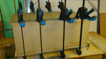

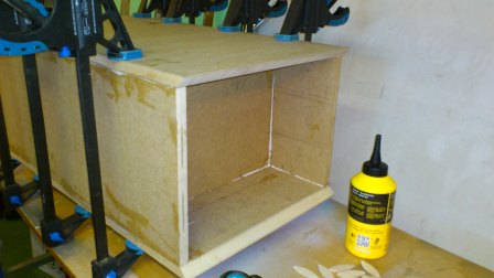

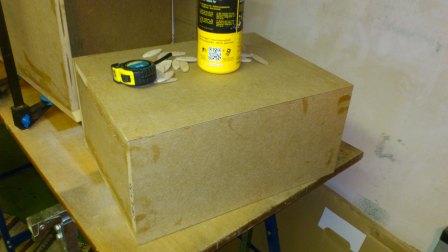

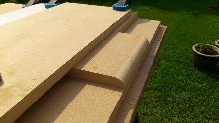

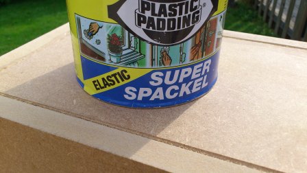

The "Sequence Three – Grand Reference" enclosure is made of two parts, one which contains the tweeter and the cross-over and one which contains the mid-woofer and the woofer. The top tweeter enclosure can slide back and forth in order to be able to adjust the acoustical off-set between the tweeter and mid-woofer, if needed in the design.
The loudspeaker enclosure uses a baffle replacement system in order to be able to swap drivers in and out as needed and at the same time make the enclosure somewhat future proof.
The overall enclosure dimension is (WxHxD) 33x105x43cm incl. feets + baffle thickness. The tweeter and mid-woofer replacement baffle is 19mm thick, while the woofer baffle is 38mm thick.
The tweeter + cross-over enclosure is 33x20x43cm + the tweeter baffle. The mid-woofer and woofer enclosure are 33x78x43cm + the baffles. The two bass-reflex ports are mounted in the bottom of the enclosure. The enclosure feet’s are 7cm high including the “Sonic Design” damping feet’s.
All internal walls are covered with 4mm bitumen pads as well as bracings for the mid-woofer and woofer section.
The woofer net volume is about 64 liter minus the volume for the bracing, bitumen pads, bass-reflex ports and driver, which gives approximately 55-56 liter for the woofer to work in. The mid-woofer and tweeter sections are about 18 liter volume each.
Picture 1: Mid-woofer and woofer enclosure.
Picture 2: Woofer section.
Picture 3: Mid-woofer section.
Picture 4: Tweeter and cross-over enclosure.

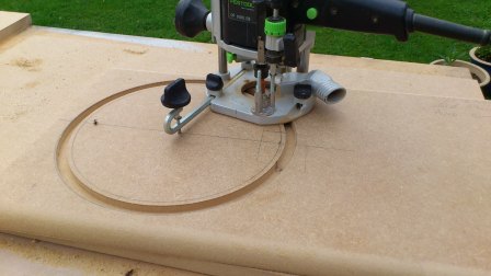

Picture 5: Round-over jig.
Picture 6: Mid-woofer chamfering.
Picture 7: Woofer routing and flush-mount cutout.
Picture 8: Milled groove to be filled with elastic filler for invisible MDF board joints.

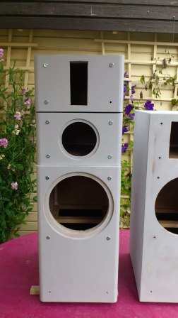

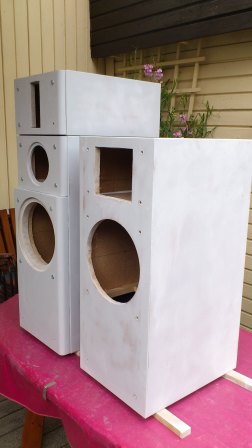

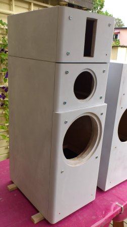

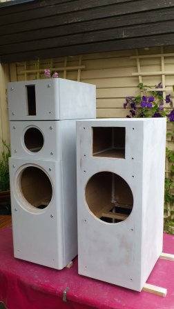

A brief update:
The work is proceeding as planned even though it has been delayed a bit by bad weather. Unfortunately the Swedish summer weather is a bit unpredictable. :)
Lately the work has mostly been – sand, fill, sand, fill, sand, fill, sand……… I almost forgot how boring I think sanding is. :(
Currently I’m working on the loudspeaker foot as well as attaching additional bracing and damping of the woofer section. I’m also planning for the spray painting of the baffles and some parts of the enclosure. The final finishing of the loudspeaker isn’t 100% decided yet.
Sequence Three – Grand Reference Construction!
Sequence Three – Grand Reference Construction Update1!
Sequence Three – Grand Reference Construction Update2!

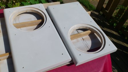

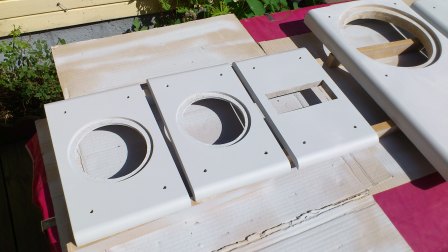

Picture1: Mid-woofer and Tweeter baffles.
Picture2: Woofer baffles.
Picture3-6: The left loudspeaker shows the tweeter/cross-over enclosure and the baffles, excluding the loudspeaker foot. The right loudspeaker shows the mid/woofer enclosure without baffles.

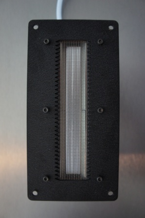

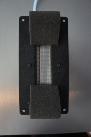

I’ve made some extensive measurements on the RAAL 140-15D ribbon tweeter and before the measurements I installed brand new replacement ribbons in both the RAAL tweeter samples and tightened up the ribbons as in this instruction video from RAAL.
RAAL Ribbon Replacement and Tightening -- YouTube
As instructed, it worked perfectly. :D
Since it’s possible to shape the frequency response both vertically and horizontally with the supplied “foam deflection pads”, it seemed as the tweeter measurement setup could almost be done in an infinite number of variations.

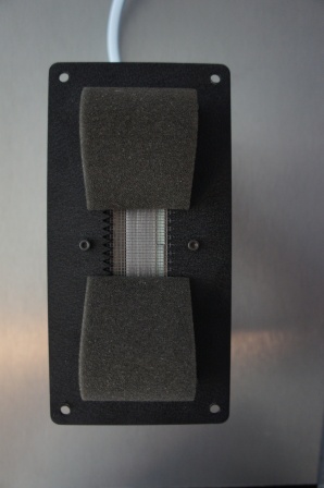

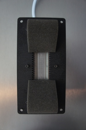

I finally decided and ended up with the following tweeter configurations:
Picture1: DPN = No “deflection pads”.
Picture2: DP1 = With “deflection pads” and 7cm visible ribbon.
Picture3: DP2 = With “deflection pads” and 5cm visible ribbon.
Picture4: DP3 = With “deflection pads” and 3cm visible ribbon.
The best overall balance and linearity between the horizontal and vertical frequency response is to use the “deflection pads” in the DP1 or DP2 setting e.g. 7cm or 5cm visible ribbon.
I wouldn’t recommend using the RAAL ribbon without the “foam deflection pads”. Without it the performance decreases in all aspects, both in frequency response and in distortion performance. Nevertheless I made a lot of measurements without the foam pads to have as a baseline to compare with.
Even though the RAAL ribbon is a very robust ribbon tweeter I made all frequency measurements with a 44uF protection cap connected in series with it.

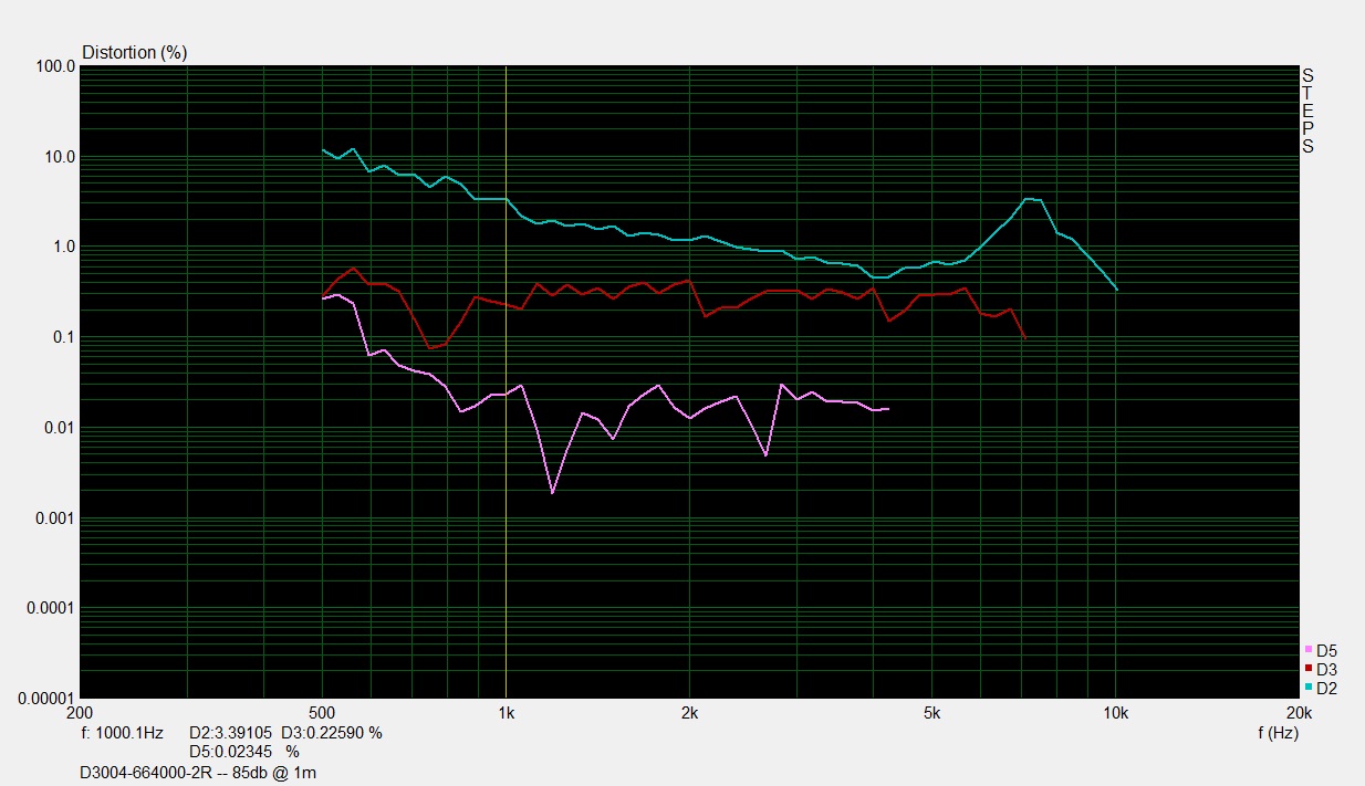

Flush-mounting or not?
I’ve tested the RAAL ribbon with and without flush-mounting it on the baffle and the test results shows that there is no big diffraction problem and frequency response impact if it’s not flush-mounted.
The face-plate of the RAAL ribbon is only 2mm thick and flush-mounting it is more or less a cosmetically decision rather than technical. All my published measurements are made with the RAAL ribbon flush-mounted using a 2-3mm thick felt carpet covering the entire baffle.

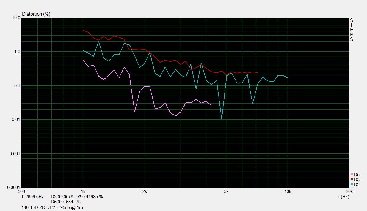

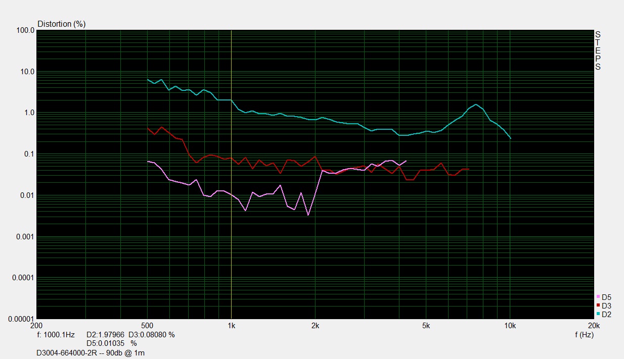

What about distortion?
The distortion figures isn’t up to the very best dome tweeter’s performance e.g. ScanSpeak D3004/664000 Beryllium tweeter, but for a ribbon tweeter still a respectable performance.
Picture5: RAAL 140-15D Ribbon tweeter (DP2) @ 1m 90dB
Picture6: ScanSpeak D3004/664000 Beryllium tweeter @ 1m 90dB
Picture7: RAAL 140-15D Ribbon tweeter (DP2) @ 1m 95dB
Picture8: ScanSpeak D3004/664000 Beryllium tweeter @ 1m 95dB
As can be seen on the distortion charts the gap between them narrows down with increasing SPL. Also the harmless second-order harmonics is actually lower for the ribbon. And obviously the dome tweeter can be crossed-over much lower without distortion issues.
When using the supplied “foam deflection pads” it actually helps lowering the distortion as well as controlling the vertical horizontal frequencies dispersion.
Based on the distortion figures I would recommend as many other people have for the RAAL ribbon tweeter, a cross-over point of about 3kHz or higher. If the max SPL requirement isn’t a concern or if you use steep filtering a 2-2.5kHz cross-over point could possibly work.
With the Sequence Three – Grand Reference loudspeaker design I’m aiming for a cross-over point of around 3kHz, so it’s seems to be working as I planned and expected. Further measurements and of course listening test will finally decide the exact cross-over point. With the AT mid-range and the RAAL ribbon I will have a possible cross-over range somewhere between 2.5-3.5kHz. Not a super wide range, but wide enough to make it work.
To sum up, I think the RAAL 140-15D measurement performance lives up to my expectations and I’m eager to continue with the Sequence Three – Grand Reference loudspeaker design. Next up is to publish the results from the AudioTechnology mid-range measurements.
For further detailed measurements see: RAAL 140-15D Measurements!
