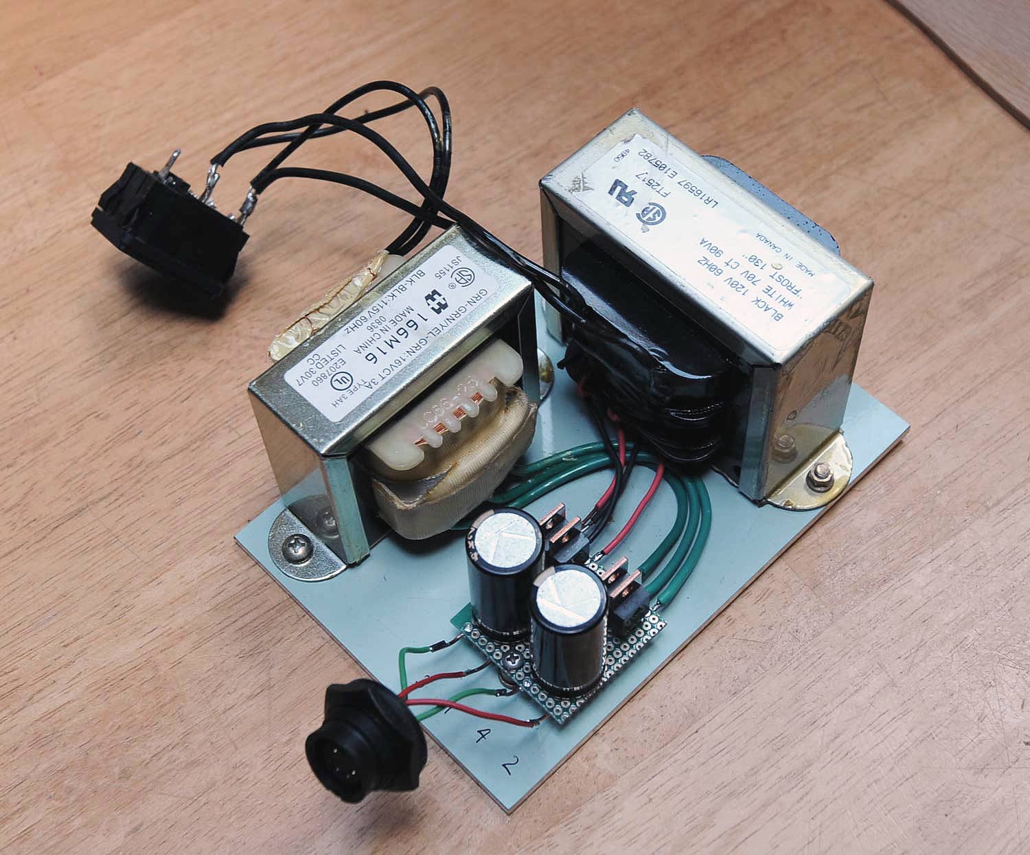

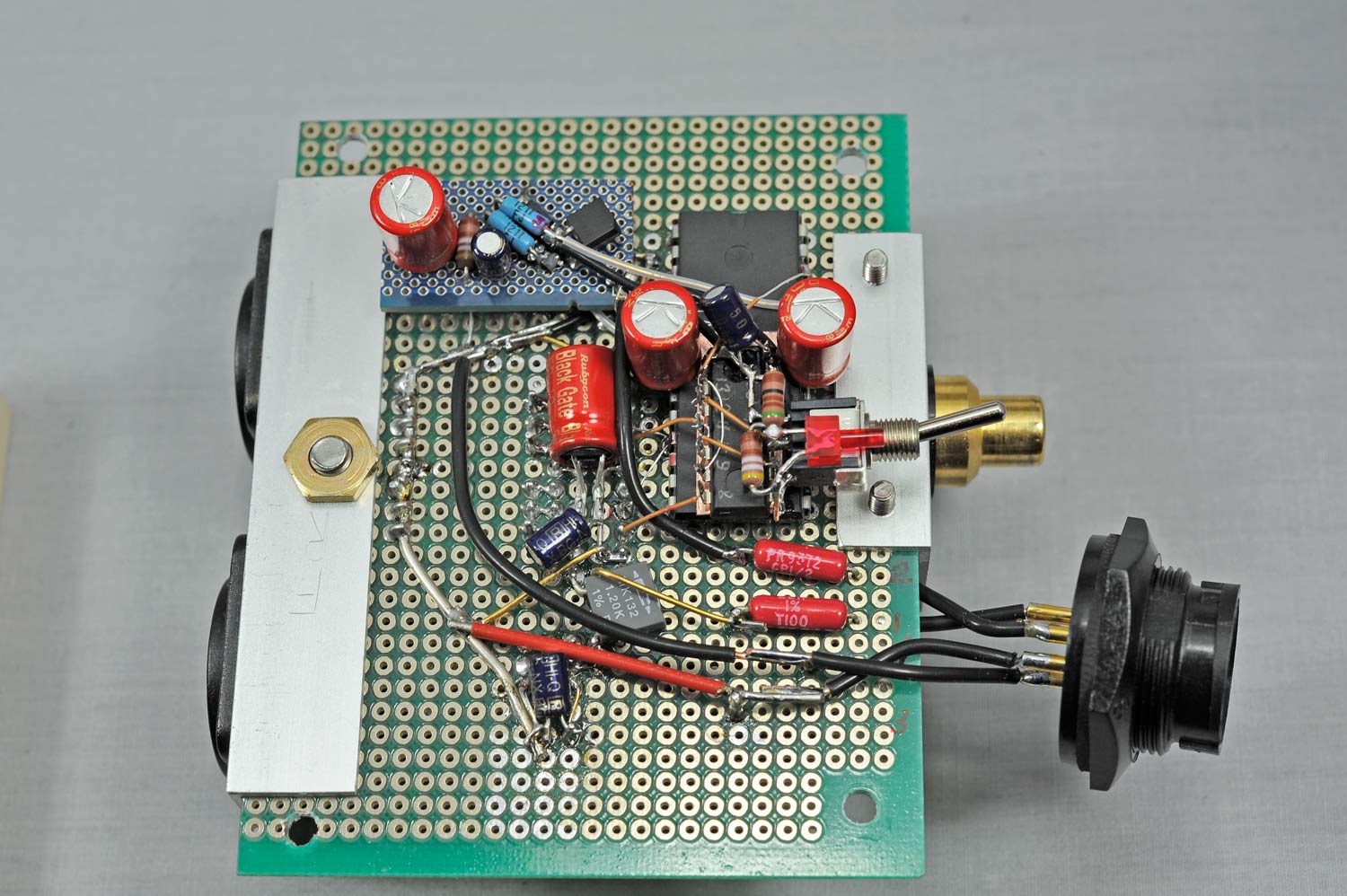

My USB DAC is up and running! So first and foremost, thank you Peter!
Now on to the pics:
I have a hatred of Phillips head screws, so they will go and be replaced with a colored aluminum hex head. The cones will be replaced with satin silver ones once they come off of back-order. I made a couple of newbie mistakes when I was tired. I drilled the wrong side of the rear panel for the switch retainer/lock ring and I wired the switch backwards, so the tab points to the opposite source that is in use. I could fix the wiring, but I'm not terribly broken up about it so I'll just leave it be until I can't stand it any longer.

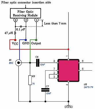

I'm looking for a DAC, to use with an Apple TV (optical input) and I am considering your kit (I think you mentioned it can be run with an optical input)
However, being overseas (UK) I'm not sure whether it is cheaper (or possible) to source the components locally.
I would be grateful if you could list the component supplied with your kit, so I can do a bit of research (apologies if I missed this elsewhere).
Thanks, Bruce.
The SPDIF DAC kit can be modified with Toslink (optical) receiver. It's best to get the whole kit (Premium version with Black Gates and Rikens) as some of those parts are not available any longer. It's also recommended to source transformer locally as additional overseas shipment on that would be quite expensive.

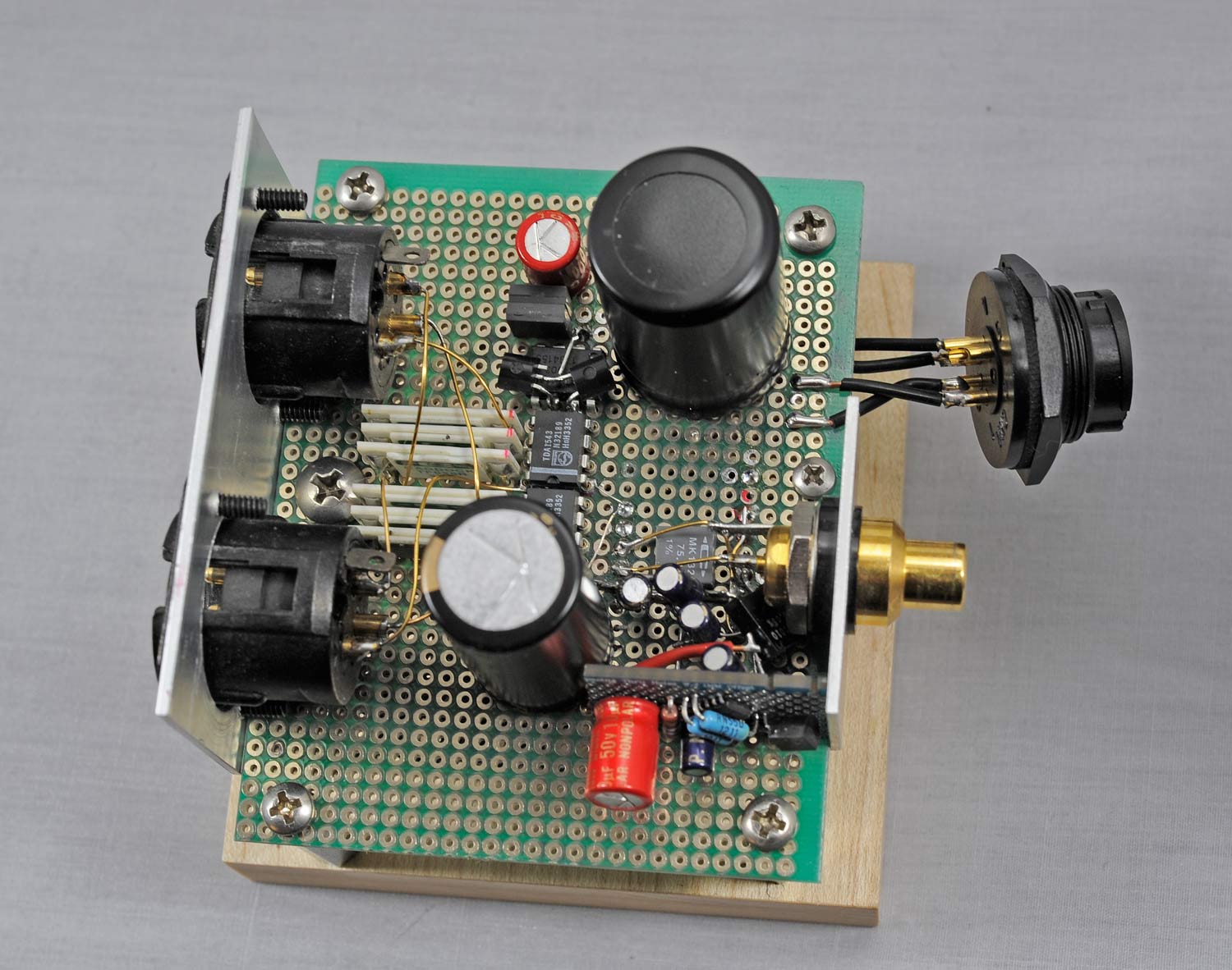

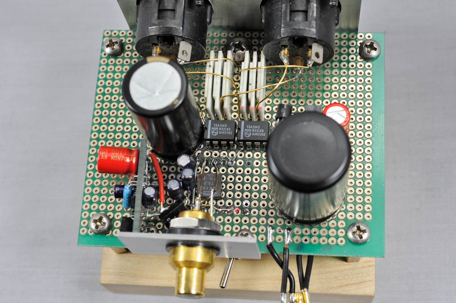

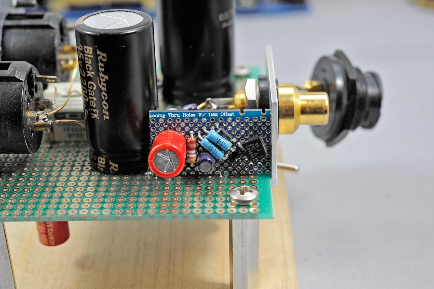

I am putting together a DAC based on PCM1794. If it sounds better than my modified TDA1543 I will let everybody know.
Here some pics of my current reference: balanced TDA1543 DAC, further simplified with 3 separate regulators and no output coupling caps: hooked up to S&B TX102 TVC stage that takes care of offset cancelling and balanced to unbalaced conversion.
