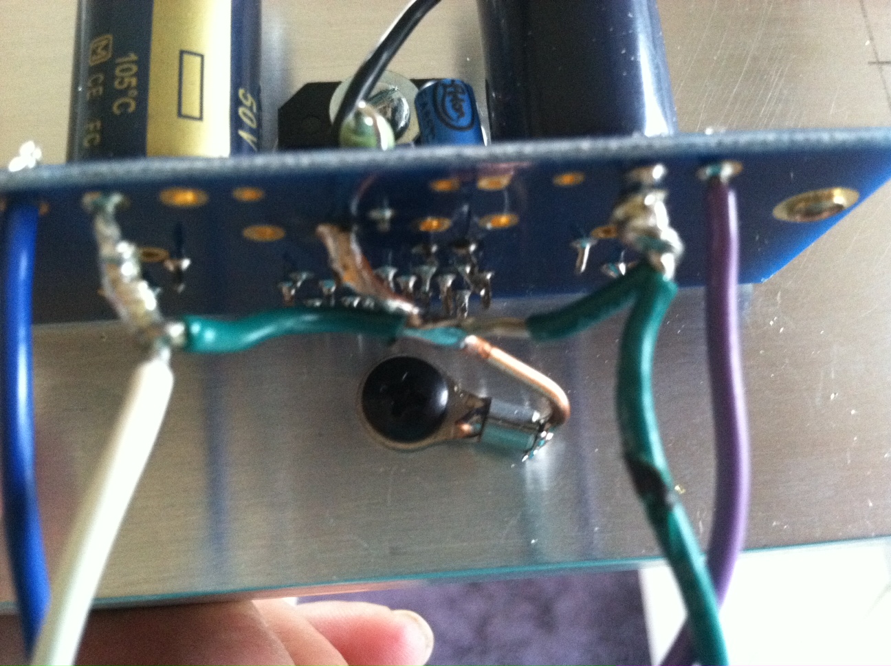

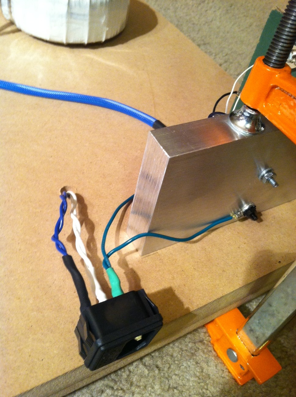

I assume you are using a single chassis.
There is no need for any additional star ground in case of dual mono setup, as each amp pcb features on board star ground.
The earth ground from power entry module connects directly to chassis and each amp board connects to the same ground point as well (run wires from CHG pads).

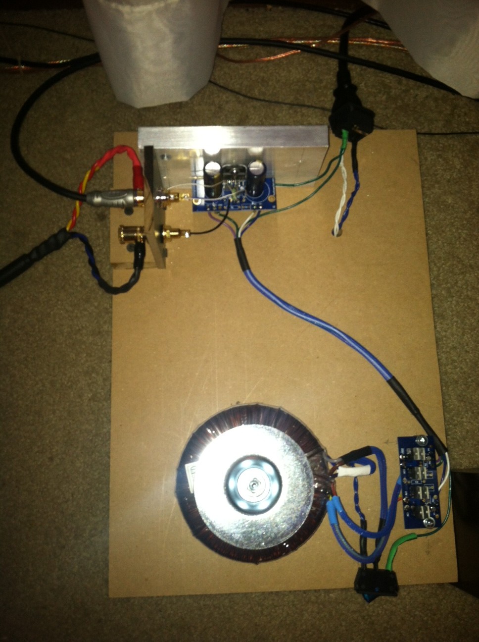

What if I will have 4 chassis? 1 chassis left amp, 1 chassis left power supply, 1 chassis right amp, 1 chassis right powersupply. Right now on 2 peices of wood, but will be moved to nice seperate 4 x chassis after I make it all work right.
I think this photo of my first amp build must be how "not to do ground for dual-mono". I ended up with a little buzz in the speaker. I guess I was over thinking it, and got confused between dual-mono and stereo grounding layouts.
So I should unsolder this, then move my earth connection to CHG, connect PG+ / PG- to board directly, and no need to worry about any other star ground, is that right?
Any other things I need to do differently, because I have seperated the rectifier and amp boards. I'm specifically looking for how to build an embellical cord between the two chassis.
Thanks for all the help and support. I feel like I'm almost there.

Buzz is gone
Hi, not sure if anyone is here...
If it helps any new guy out there to know, when I heard the buzz I instantly assumed it was a ground problem.
It turned out to be that anytime I connected the Coax CATV line from my cable company to my TV, in the vicinity of the amps that the TV would leak RF and make my speakers buzz.:eek:
It was a lot of deductive reasoning, and some nice guys on the diyAudio forum were very helpful to me. My first build, and now that the buzz is gone, it's the best sounding amp I have ever owned! Very open, detailed, good imaging, and depth. The bass is very solid, and I only have 10uF on the ps. They are driving what I think of as a heavy load, a 3-way Transmission Line speaker. The little LM3875 with a big powersupply is doing a great job.
