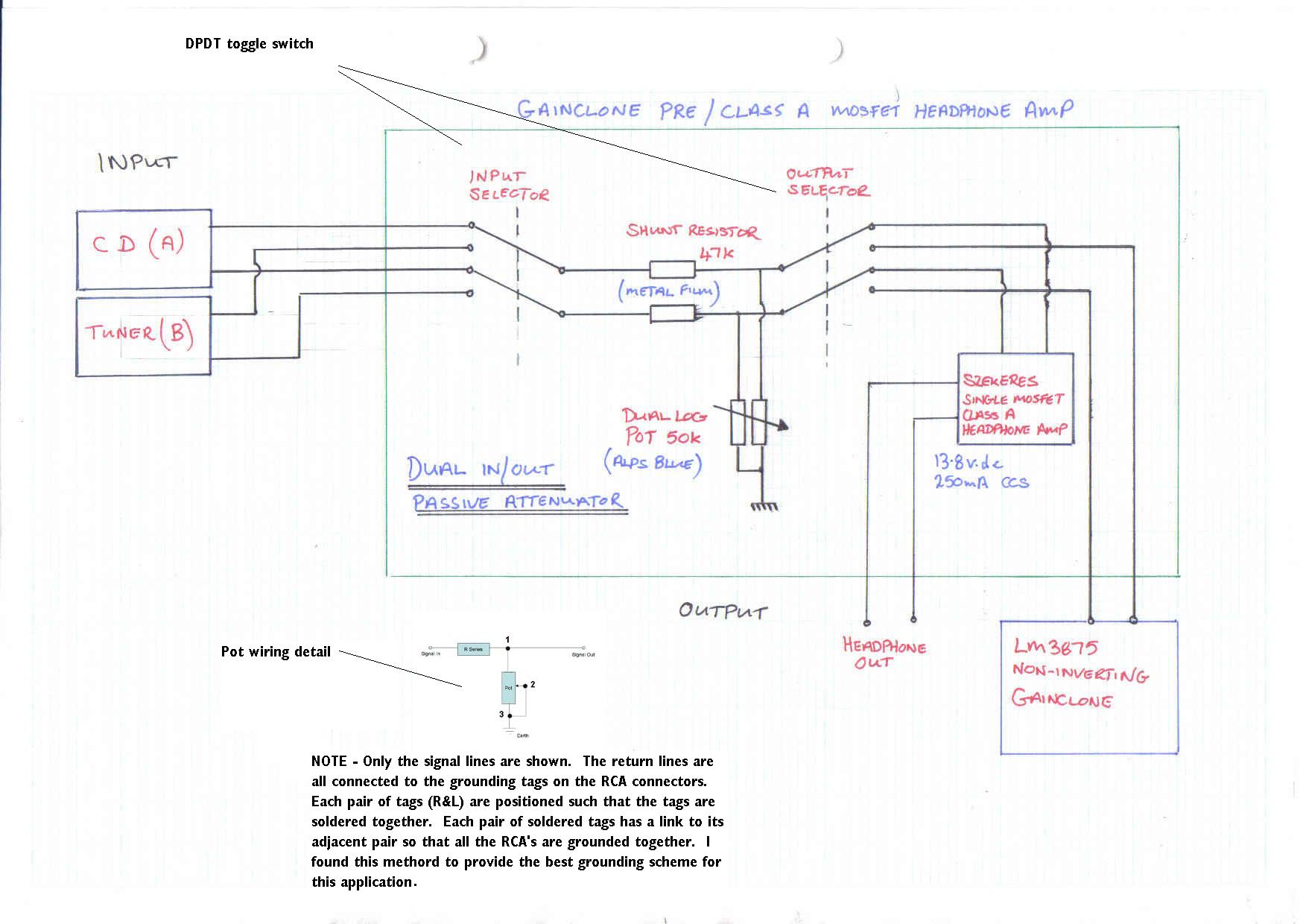

Here is the schematic of my passive attenuator. It is a dual input/dual output. It also contains a single ended class A MOSFET headphone amplifier. I use a CDP direct into the pre as my primary source. I have a tuner as my second source, and although the output voltage is less than the CDP, it still sounds very good (imo).
I tried 20k and 100k before I settled on the 50k/47k shunt option. In my opinion, it gives the most natural presentation.

Zebra - so adding a 47K resistor on my inputs is all I would need to try?
Adding resistors at the entry is right if you dont forget to also modify the configuration of the pot as per the Zebra100 schematic : the pot output is not at the variable pin (pot wiring detail)
I tried this setting on my own Audiosector LM3875 amp and found the sound to be a little bit clearer than with standard alps pot, particularly at low volumes.
Now, there is a negative side : to work fine, pot and resistance must have about the same value, so even at full level this is a divider where you lose half of the sensitivity of the amplifier...
