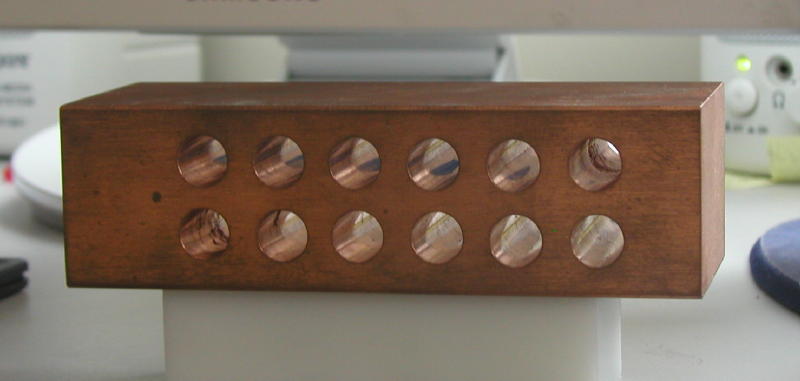

Drilling in copper
Hi fellas, I was working on drilling holes in my copper heatsinks as well this evening so here is what I did for all you newbies out there. First I tried to use my 7.2V battery operated Ryobi drill with titanium metal bits and of course that didn't work. I ended up killing the bit and thank god my drill was okay :whazzat:.
So I went off to Lowes and purchased 1) 2 foot X 2 foot X 1/2 inch thick piece of birch plywood, 2) A set of protective goggles, 3) A wonderful kitset of bits that cost me only $15 for what looks like 50 or 60 bits for all uses, woodworking, metal, masonry, etc... 4) A Black & Decker 6A corded power drill :devilr: and a pair of 99 cent clamps that fit supertight.
So I clamped the copper pieces that I had (each about 1/2 inch thick!). Marked the hole with a hammer and nail so that my bit won't 'walk' all over the copper. Added a little bit of canola oil to the end of the bit and started drilling away with the copper clamped to the plywood. Even with a 6 amp drill, it took some work and I had to give the bit a break every now and then from overheating. At the end, my copper piece felt every so slightly warm :cool:
After going through two pieces of copper 1/2 inch thick each, my drill bit was worn, but hey, the kitset I bought had a ton more so...
Moral: Its not just important to be safe and careful...its just as important to spend some dough and buy the right tools. My Black & Decker cost me $29.95. If it were cordless it would be a heck of a lot more and since you don't need a cordless when you are diying amps you can get more for your money.
My 7.2V Ryobi has been relegated to drywall drills :D
Just an FYI,
Anand.
The standard TPA(Tool Point Angle is 118Deg) on all drill bits, if you are able to grind it to 100Deg TPA on a bench grinder would be better for non-ferrous metals. USe light lubricant such as WD-40 or Varsol for best results, brass and copper tends to stick to the flutes of the drill bit.
