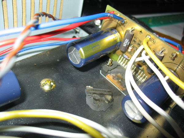

So I blew am LM4780 chip and I'm trying to figure out what happened.
:bigeyes: :(
When I plugged in there was a audible pop and spark and a large chunk of the ceramic (?) on my LM4780 blew off. I think I may have connected the power supply board to the amplifier backwards (ie. V+ and PG+ on the PSU to V- and PG- on the amplifier). Would this have done it?
Peter, how much do you charge for a single LM4780 including shipping to Vancouver?

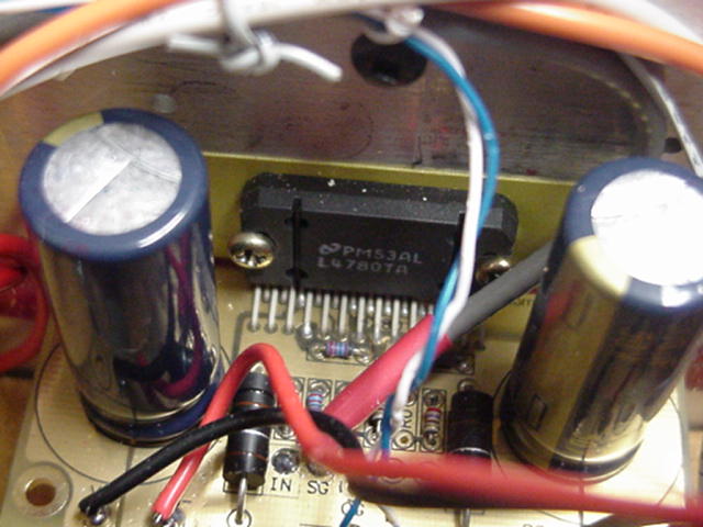

I found when building one of the LM4780's, I measured a short between the heatsink and chip even though it had a mica washer. It turned out to be one the the screws touching a metal part of the chip body at the screw mounting slot. Added heatshrink over the screw in this section and all was well.
The LM4780 isn't the most friendy chip to mount and I found it best to use a plate over the face when mounting like the one in the pic.
You should always check for shorts to the heatsink before adding it to the case and firing up.
