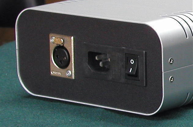

There is no price for it, as it's not my standard item. It can be easily built and the cost of the Elma switch is $60, Caddocks are $4 ea ($6 for lower values). Series Vishay is $12. All parts available from Percyaudio.
