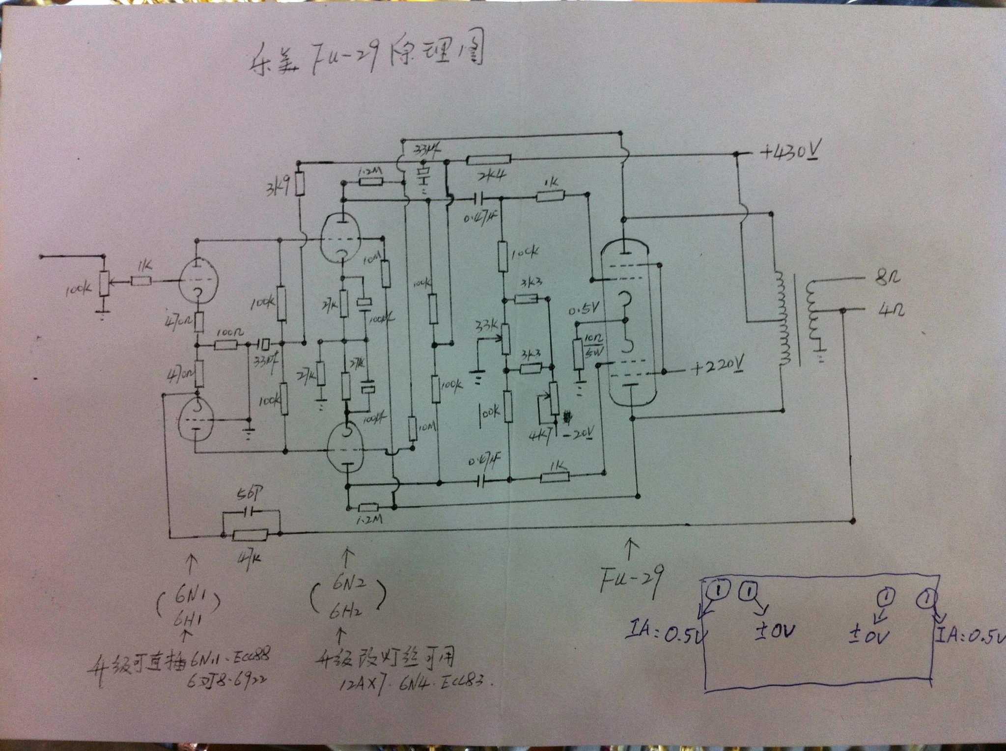

Ok so this is my first post here so Hi. Picked up an Audioromy m828a FU29 tube amp from ebay - came quick, seems pretty well made.
I wanted to get the Bias and Balance right before I started using it extensively, so went about looking at it's guts. It seems the one I have differs from the schematics I have seen and the photos of the PCB apart from one person on this forum about a year ago who had gone about a similar question.
It does seem that the information been put out by some of the sellers of this amp is not compatible with what is actually in the unit. I wasted a lot of time stupidly trying to bias via the cathode, as there seemed to be a 0.4ohm resistor there (evidently not really). I could not get a real mv reading across to determine adjustment to get to 50ma total on the combined cathode.
So the 829b tube has a single common cathode and two anodes, essentially two tubes in one. It looks like the more recent versions of this Audioromy amp have no resistors for the cathode to determine the current here, but instead uses 1ohm resistors on the anodes for each half of the tube?
The attached image of the PCB area for one tube (from the other thread but is same as mine) shows the anode resistors and the white wires heading off to the top of the tubes.
The other attachment shows the instructions that have been sent around from the various sellers about how to bias the unit.
I suppose my post is here to highlight this disparity to anyone else who may have been confused about this and also to ask, can I adjust the bias and balance correctly via the supposed 1ohm anode resistors???
If it were a case of a simple in at cathode, out at anode analogy, I see how it wouldn't make any difference where the mv reading is taken? However what with the screen, grid in between the two, absorbing some of the juice, this reading might not be correct?
When talking about tube ratings, is the 50ma applicable to this tube in terms of cathode current or is it a more general cathode / anode current, making the location where this reading is taken irrelevant?
I am new to tubes since about a few weeks ago, so have a hell of a lot to learn and will refresh my basic electronics knowledge in the process.
Appreciate any help on this as I am going to attempt to bias / balance these tubes tonight and do it properly (ideally a self balancing circuit would be my solution?)
Rich.

These amplifiers depend on who built them as far as components in use are concerned. Pinch of salt is a good saying.
I set these up by inserting a 1R 2W resistor in series with the anodes. Using properly insulated test leads and two DVM's, set the voltage drop across each resistor to 25mV. There is some confusion as to which pre-set is which, this will become apparent very quickly whilst setting the valves up. BEWARE there is DANGEROUS voltage on the anodes!
The 1R can stay for future use as they do not affect the sound.

I find it more accurate to place a 1R resistor of say 2W in size in series with each anode and the transformer for balancing the valve. BE EXTREMELY CAREFUL NOT TO ELECTROCUTE YOURSELF as DC volts won't let you let go and will fry you!
If the valve is unbalanced say 20mA on one side and 28mA on the other half, this will induce hum at twice mains frequency as the power supply uses a full wave bridge. In some models, a half wave bridge was employed and there was no hum issues.
Using the test point 2b+ and 2b- assumes the output transformer is symmetrically wound and some again are not and give a different DC resistance from side to centre.
There will be low frequency ramping due to the design of the coupling and power supply limitations so a motor-boating effect is to be expected, on some models.
Set the balance as best you can then reset the bias and then the balance until you are happy and the hum has gone. If it won't set then try another valve.
The bias voltage must vary with any changes in mains input fluctuations or you will get problems with over heating or under running.
Hope that helps.
Not the best design in the world!

Digging up this old thread as I have some info that relates to this amp. Just got one on my bench for repair- blows fuses on power up.
What rating is the input fuse? This one had 2A. Inrush current was massive, yet all power supply components test fine and unit plays stable for hours after brought up slowly on a Variac & pulls just over 1A when operating. Then I noticed the first filter cap in the CRC filter plate supply was 270 µF! Way, way too much. Replaced it with a 50 µF, inrush greatly reduced. Added a thermistor (CL 80) to knock down the 10+ percent dc voltages I’m measuring. Heaters are presently 13.2 VAC and B+ is 455 VDC with 120VAC in. Filter caps only rated at 450- yikes!
Also note- the AC switch was wired on the neutral side. Switched neutral (AKA earth, return or ground) wires are a hazard, so I rewired it, putting the switch after the fuse on the hot side.
There seems to be some variations in the schematic. To set bias and balance, I just measure Vdrop across the resistors in series with each plate lead. Mine came with 1.0 Ω sense R's so super easy, target for 25mA. I’m considering inserting a 1 ohm 1/2W in series with the cathodes as a fuse resistor for safety.
Some very good info on this amp with the correct schematic-

i have repaired this amp years ago...
the G2 supply must be well decoupled and never to exceed 200 volts dc....a mosfet power source follower will do very well...
on hindsight, i would install a 5894 tube in place of the 829b, this tube has a single filament and cathode structure so that tube balance is superior to any 829b..
