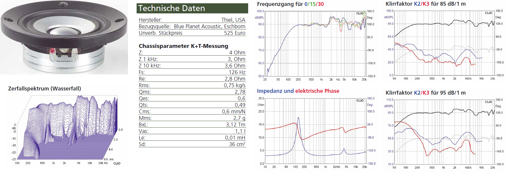

Here's that Thiele unit, with spec. & measures courtesy of Klang + Ton in Germany. A 3 1/2in driver priced at 525 Euros apiece. At today's exchange rate, I make that about £447, or $693. To that, you will need to add shipping costs.

Thanks! Looks nice, though if all I saw was its response plot I'd think it was loaded with a truncated horn, what with the choppy, humped, HF response.

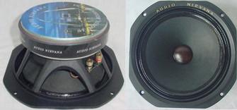

This link. We could order from Vietnam
I think it is not a good driver, all things considered. Am I wrong? (I'm learning here)
Well, it is an 8" that goes pretty high without a whizzer............

i was talking about the thiele 3.5" !
Depends on what criteria you use for defining 'good' but I certainly don't think so. Judging by K&Ts measurements, the technical performance is mediocre at best, especially given the price. No problem with high prices, providing you get the performance to justify it, and this thing looks to me to be beaten by units at a far lower point. YMMV as always of course.
Possibly the latter. As I say, the performance appears mediocre given that several far cheaper units appear to at least equal or exceed its performance, making it lousy VFM as far as I'm concerned. On a positive note, the waterfall plot looks reasonable for what it is, but the response is still pretty much unworkable from my POV. However, bashing this particular driver wasn't my intention; I originally mentioned it simply because it has a somewhat different means of decoupling the central dome from the main cone.
Back OT for the whizzerless AN, providing it conforms to the spec. sheet, then I've seen worse & if I were in the market for an 8in AN, I'd take it over their other size-equivalent units.

Obviously there have been drivers available for many years that are full range without a whizzer or phase plug. Jordans, various Fostex, Bandors, Babbs, Fertins, etc. The ad copy is ridiculous. The new AN driver is interesting, but the hyperbole is off putting.
