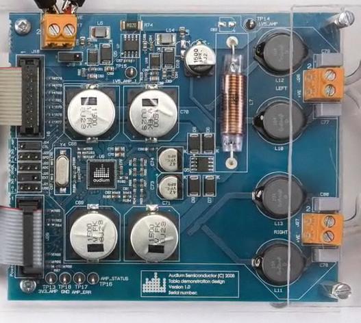

Last but not least, why do you (and many others) constantly keep comparing this amplifier with D class amplifiers? According to the poor explanation they gave, it is absolutely not a D class amplifier! If you want to classify it, it is more likely a modified BASH amplifier. And BASH has much less problems with idle consumption!
Do BASH amplifiers require an output filter?

Anonymus1, I didn't say It's a Bash amplifier. I said that "it is more likely a modified BASH amplifier" than a class D amplifier. Look at these output filters, do they look to you as filters for a 100W amplifier in class D? Anyway, we just may assume how this amplifier works, no dataseheets, neither any explanation from the manufacturer! Does it seems to you a little bit weird that we have to assume something in a so precise science as electronics is?
