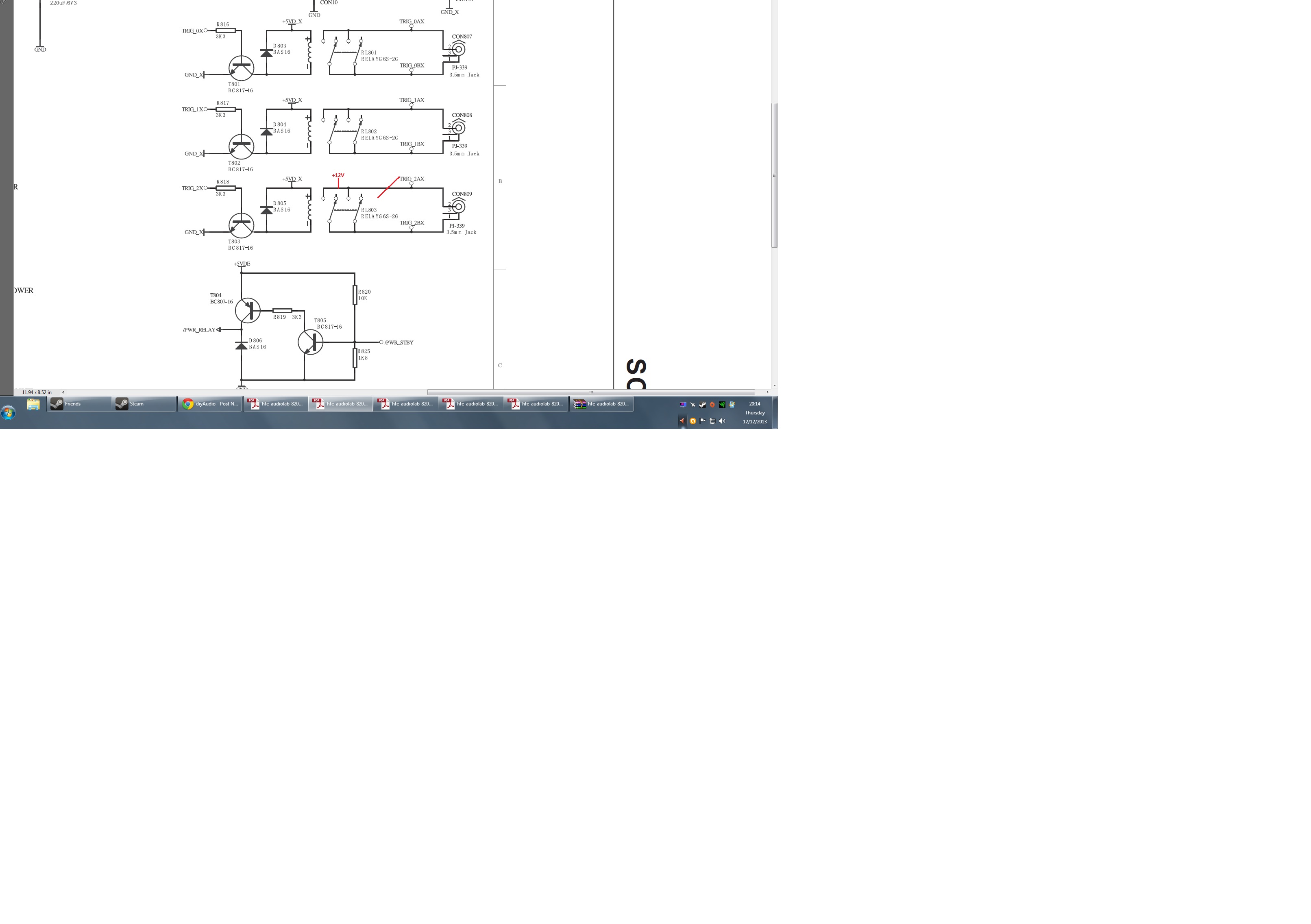

Hi all first post here so please be gentle.
I've got an Audiolab 8200AP which has an open/close trigger system which is only suitable for use with one of their amps the 8200X7 (which I don't own), the rest of their amps oddly enough use a 12V trigger 2 of which I do own (8200MB).
I've got hold of a service manual and it appears the 8200AP has a separate trigger board and all that happens is a relay energises shorting the 'left audio' of a 3.5mm jack to ground hence the open/close.
Now i'm not entirely sure what the standard is for a 12V trigger (mono jack?), is there +12V all the time? also which part of the jack should be 12V?
I've done a print screen on the stock trigger circuit and i'm wondering could it just be as simple as making 1 line open circuit (left audio or ground) and tap off from a 12V source within the unit to this line so when the relay closes the other line then becomes live?
Any suggestions and feedback appreciated.
Just realised that what i've illustrated in that diagram is incorrect and wouldn't do anything as it is.
Now i'm not sure out of 1 & 3 which refers to the tip of the jack and the sleeve but if I were to break the top part of the circuit as illustrated and put 12V one side and 0V (ground) the other (which way round would depend on pinout for the mono jack) that way when the relay energises there would be both 12V & ground to the trigger output.
Hi Andrew, there is no 12V output from the 8200AP, when the relay energises it just shorts the pin & sleeve of the mono (or stereo) jack which is bizarre as this method of triggering is only compatible with their 8200X7 amplifier and not their 8200MB which requires 12V.
Upon reading the service manual it seems there is no 12V supply derived within the unit so if I was to mod the trigger circuit as described above I would need to get the 12V from another source.

I've not taken the top off the unit yet but providing there is room I don't see why I can't tap into the mains supply after the power switch and supply the proposed modified circuit.

Measure what exactly? like I keep saying there is no 12V output from the 8200AP if you look at the trigger circuit in the diagram I attached there is no voltage/current on the circuit at all it is just a open/closed loop.
If I plug the 8200AP into the 8200MB nothing will happen hence why the trigger system isn't compatible and it only works with an 8200X7.

I'm talking about outputs, the 8200AP has no 12V output trigger and I want to modify it's current system so it does.
