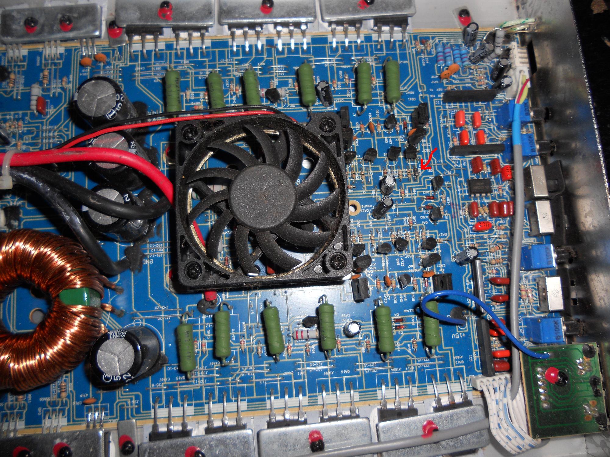

Does anyone happen to know the value of this resistor?
M mike49504 Member Joined 2006 2012-06-13 3:21 am #1 2012-06-13 3:21 am #1 Does anyone happen to know the value of this resistor? Attachments Audiobahn.JPG 605 KB · Views: 96 ••• More options Share P Perry Babin Member Joined 2003 bcae1.com 2012-06-13 4:19 am #2 2012-06-13 4:19 am #2 There's a corresponding resistor in the other channel. RAxxx is one channel. RBxxx is the other channel. ••• More options Share Show hidden low quality content Status This old topic is closed. If you want to reopen this topic, contact a moderator using the "Report Post" button.
