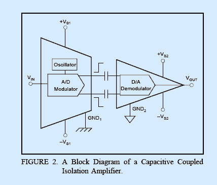

we also have this
Texas Instruments ( Burr-Brown ) application note:
For the Principal Operation idea of these isolation amplifier chips
see my Attachment.
What I have seen are chips with bandwidth like 50 kHz
.. but there may be considrably faster chips now, with higher resolutions, too
Analog Signal > ADConverter > capacitive barrier > DAConverter > Analog Signal
NOISE SOURCES IN APPLICATIONS USING
CAPACITIVE COUPLED ISOLATED AMPLIFIERS
By Bonnie C. Baker (602) 746-7984
http://focus.ti.com/lit/an/sboa028/sboa028.pdf
see my Attachment.
