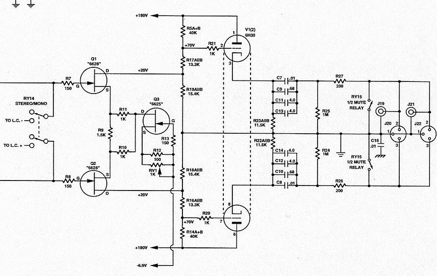

I had some clone boards made for the MkII. The output section looks like the Ref3. They have exactly the same circuit and component values from the second set of 6H30 on to the output. They are 0.94 thick with 2oz copper. Now the problem. Being a rooking I made some of the holes too small. I just drilled them out and things work fine. If anyone is interested in getting a set at my cost, send me a private email.
