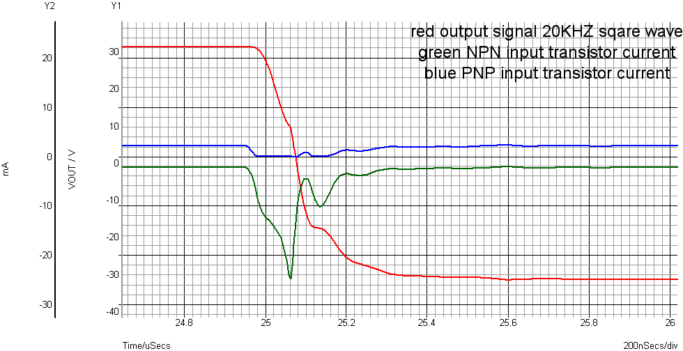

I was rebuffing Mikeks erroneous claim that the front end stage in CFA's runs in class AB. Nothing to do with rise time claims
Actualy Mikekiwanuka is right , a CFB can enter class B if the input
signal slew rate is high enough.
An exemple is your own NX amp when stressed with a fast square
wave that still is within its output level capability.
Notice the value of the input transistors peak current ,
in this case visible only for a side of the amp.
Anyone who would bother to actually study a 'CFA' or at least the data sheet for an ic one, would know that. Jeez.
jan
It s a direct consequence of the ability for each side of the amp
to supply more than the quiescent current if necessary , the non
conducting half will then be switched off largely but , well , not
everyone is really interested in the functionalities of the topology
it seems.
