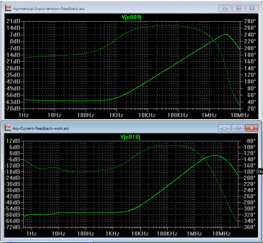

Well. Trying to understand better the behaviors of the both confiurations, i recently settled-up the same fast amplifier (hex power fets, Cascode VAS) in the two configurations: VFA, CFA. With the same currents on each stage, or in optimizing each stage for the better possible performances in the two configurations. Spend a lot of time to test, measure, listen, analyze.
Conclusion: CFA behave, measure and sound better to my ears in all situations with this amp. in bandwidth, H and IM, slew rate and... stability margin.Whatever i tried.
What is the most obvious is to look INSIDE the feedback loop, at the input of the VAS, just after feedback is subtracted to the input signal.(See attached)
The bandwidth of the mixed signal is flat till a certain point, then the level increase up to the upper limit of the amp. it gives a good idea of the distortion increases with frequency. In CFA, the corner frequency is several octaves higher than VFA.
Listening to the amp in the two configurations, the difference is obvious: Basses drier with a better separation and details, more space between instruments, little details in CFA, that you do not hear with VFA, more fluid and natural trebles, less aggressive. A general feeling of "ease".

Now, about this old sea snake CFA vs VFA.
During all my audio professional life (half as an audio designer in hifi manufacturer companies, half as a sound engineer) i had preferred CFA against VFA. Not because some religion, but because it sounded better on my point of view.
I discovered-it when i realized, years after, that all the amplifiers i had chosen (blind, and ignoring their configuration and schematics) for my various recording studios were all CFAs. And the best sounding amps i designed since 1970 were all CFAs too.
When i realized this i tried to understand why.
First, one of the reason for miss-understandings and controversies is this stupid classification and name "current feedback".
V=RI. it is like Speed of exposure and diaf in photography, talking about light quantity.
Let's forget-it.
