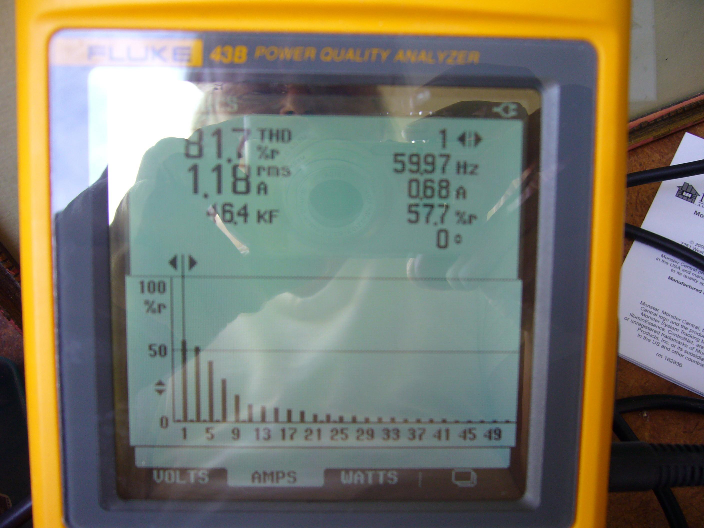

You are correct. Even PFC PC's put a lot of wide band noise on the ac line. It isnt just heavy loads, either. get the same hash from a little CD player. Here are some measurements I made a few years back. A CD player and a PC and a lamp dimmer are 3 examples of zillions. They ALL put noise on the ac line and the total of everything 'on' at the same time is an amazing amount of energy/junk which we are not prepared to remove in our A-V gear (will add too much cost to the product, if they did).
< before and after filtering.
Note the freq of some home electronic gear are low enough to be difficult to remove.... line harmonics of significant levels (and at only 1.2A load).
Thx-RNMarsh

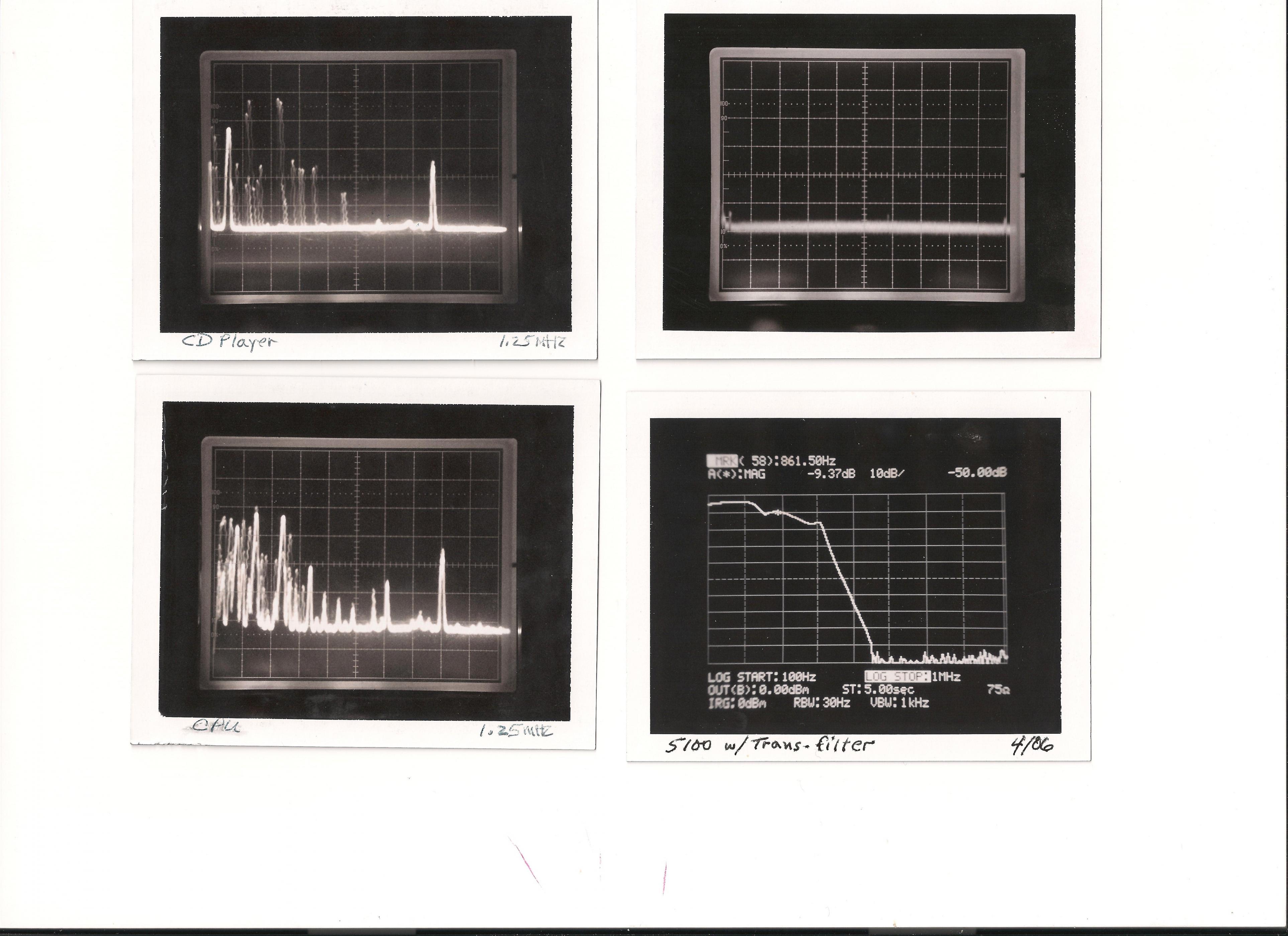

View attachment 402868 < before and after filtering.
Thx-RNMarsh
The line harmonics will be largely removed by the PFC, but the wideband hash will not be removed by PFC.
The sources of this junk are indeed prolific.
Proper control of conducted and radiated emissions, both egress and ingress, does add some cost to equipment, but there is no excuse, other than snake oil and ignorance, for the expensive high-end audiophile gear to not manage it.
It is certainly a much bigger deal than just using expensive power cords .
Bob
Richard,
Did your powerline filters you designed for Monster take care of any of this hash or was that beyond that product also?
The before and after is via my line filter. The -5100 prototype. Mid priced. Nothing good is cheap. After the economy crashed and left us with only the bottom feeder stores, like Wal-Mart and Best Buy, there was no place to sell them. But if you can find them on eBay, you'll likely get the best you can find in ac line filtering outside of heavy duty commercial units. The best one is the -7000. With two ultra high rejection isolation transformers (triple shielding techniques) and more complex filters and protection. I have some data curves around somewhere.
BTW-- the one which removes freq below 1KHz (but not 60Hz) was never built... I use that one in my home system. Sorry about that.
THx-RNMarsh
